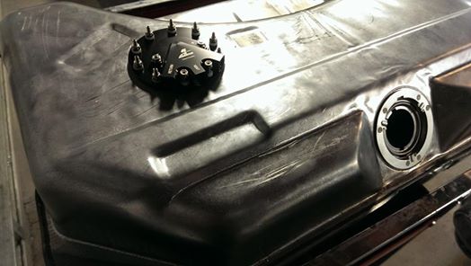

This KIT is worth every penny! Watched a few install videos from you tube and got to work.

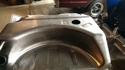

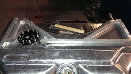

I used a new tank, built a spacer out of 3/4 aluminum box tubing from home depot so the pump system would clear from the trunk pan.
