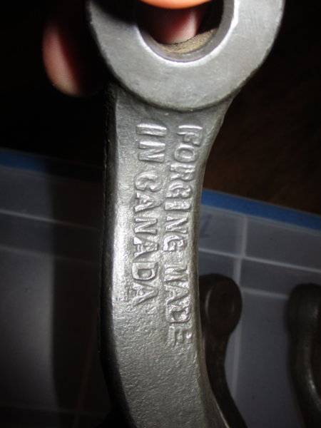

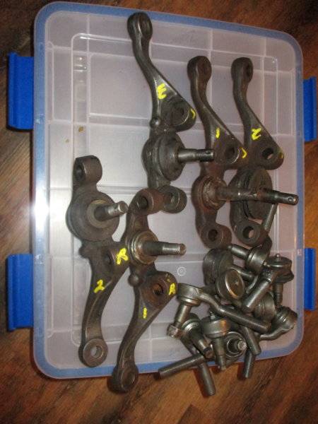

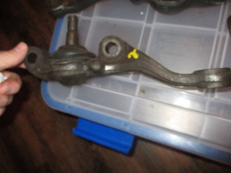

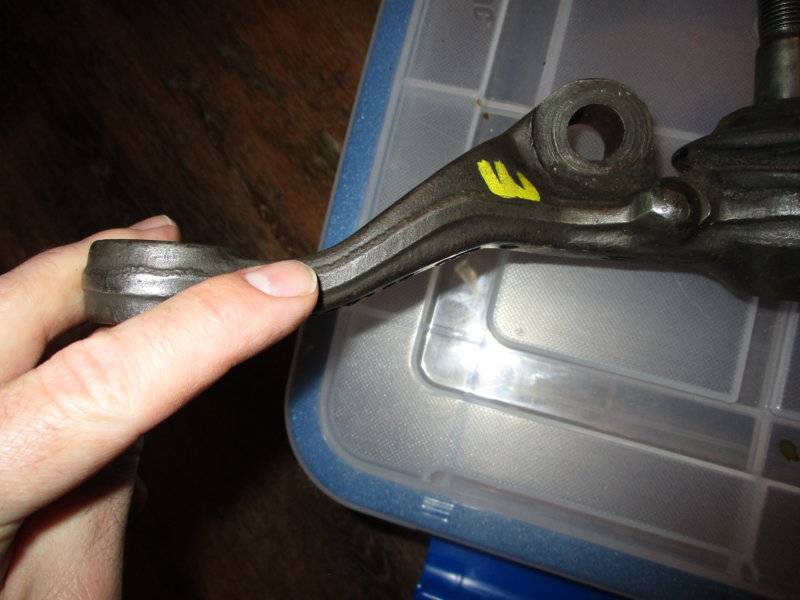

What do you do when your car is away and no other car to work on? Well, you buy a group of original ball joints and tie rod ends to restore......Yeap, I am down to restoring small parts...lol

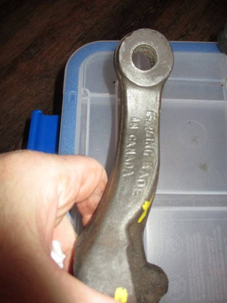

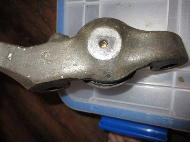

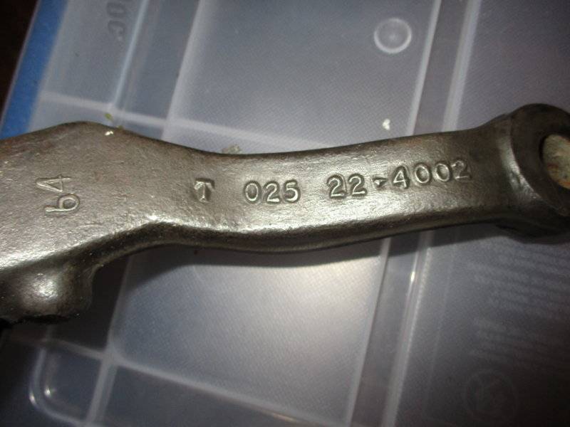

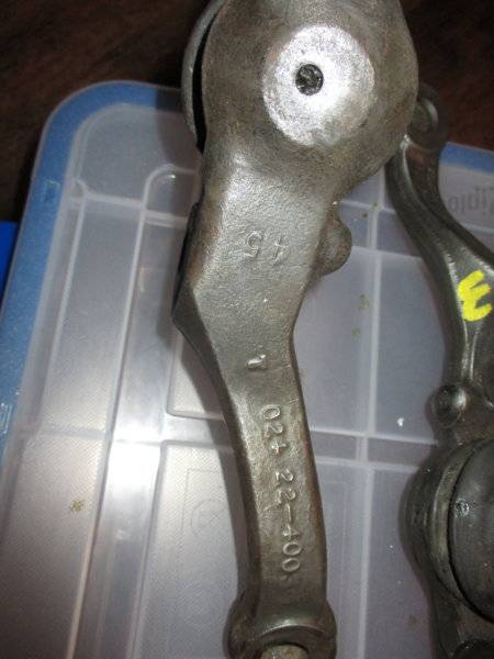

After much collaboration with top level restorers and knowledgeable mopar aficionados along with comparing survivor cars. I believe we have nailed down assembly line lower ball joints for 1969. This is a near impossible challenge and Big D put that final nail in the coffin, lol...There are so many flipping variations of these castings, casting numbers and markings. The OTC NOS with the correct PN are very close but not assembly line. There is no reference in any manual for the casting numbers to go buy. The lowers ball joints on the assembly line had a distinctive rib and dimple. The top side had "forging made in Canada" casted.
025 22-4002-odd number is the driver side
024 22-4003-even number is the passenger side
Here is lot of original tie rod ends for 1969
2072434 is the inner
2835885 is the outer
Nice.. can they be rebuilt?
Believe it or not but only 1 lower ball joint and i tie rod is loose.......All others are fairly tight. These were picked from a large group of originals.....
For the ones to get rebuilt...I am going to inquire with Kanter to see if this can be done. Supposedly, they rebuild them but that is a matter of doing that while retaining the original look....Hence is why I got those 2 to try at least....
I will update on the restoration of those and if I am able to get some rebuilt.....
