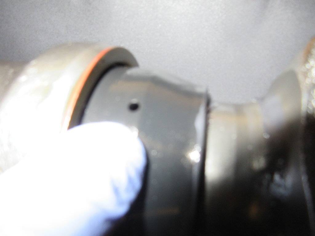

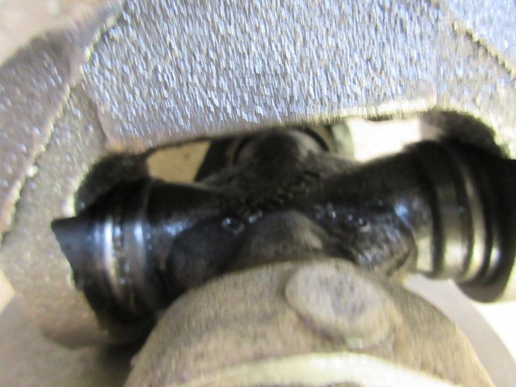

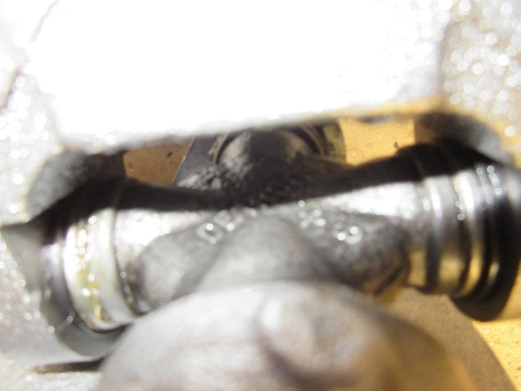

Notice the weep hole in the trans boot..

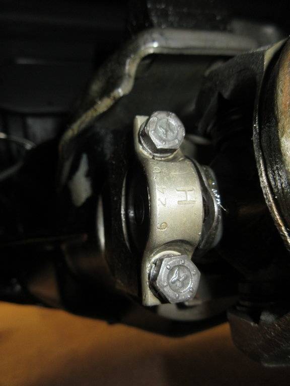

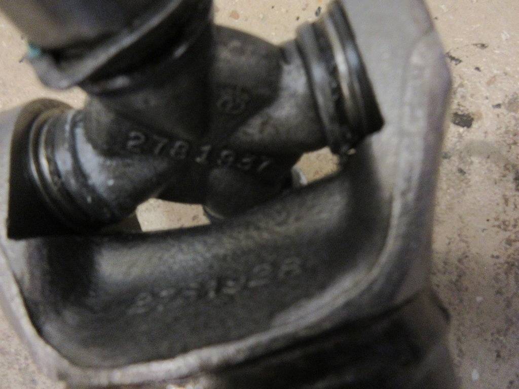

Original U joint straps and hardware. Notice the dates on the straps....

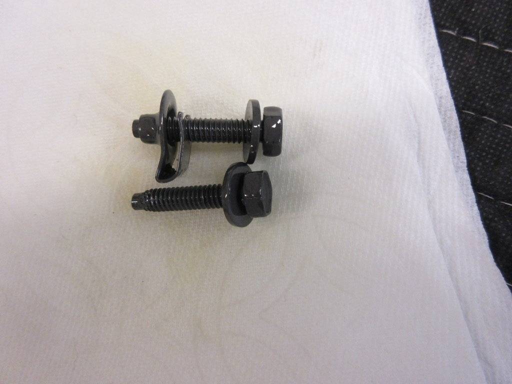

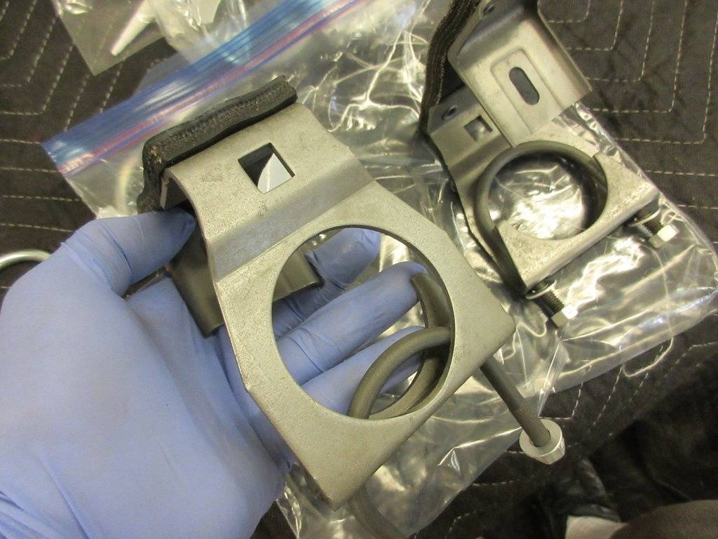

These are NOS exhaust hangers and hardware...Soaked in ER and coated with boeshield. The nuts and washer were sent out for plating...
There were two variations on the exhaust hangers in 69. In my comparison pics the middle one is an original set and the far right is the NOS pair.
The first set is a repop and there are noticeable variations...
NOS set was soaked in ER and coated with boeshield. The nuts and washer got plated..

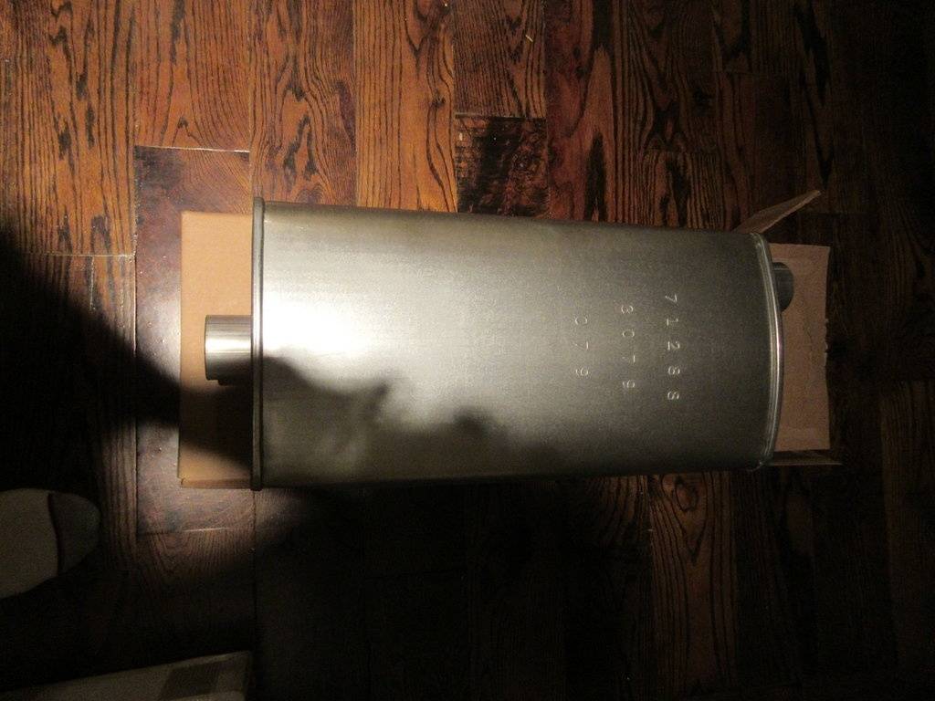

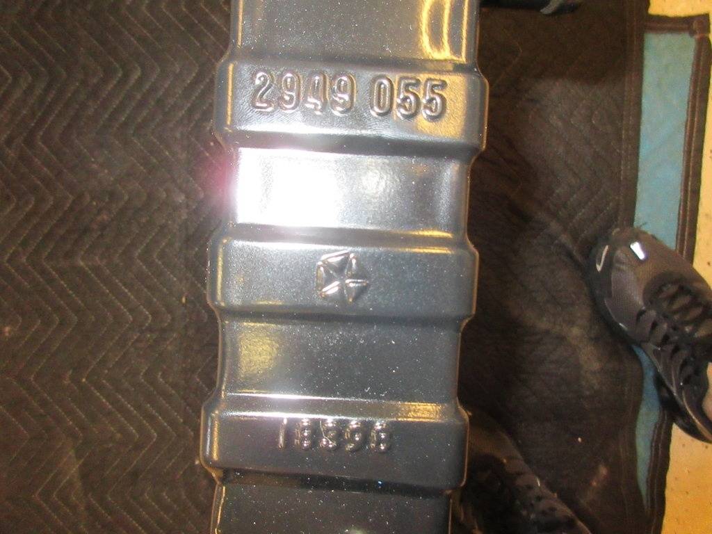

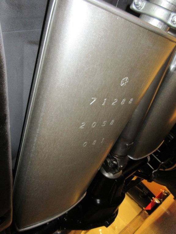

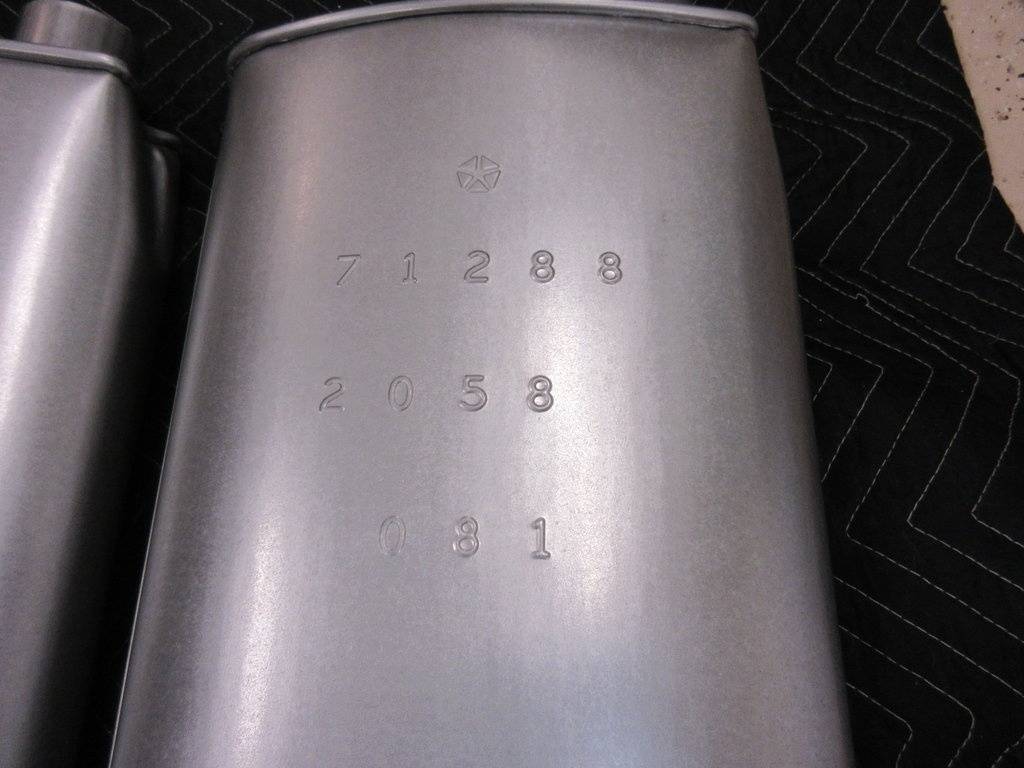

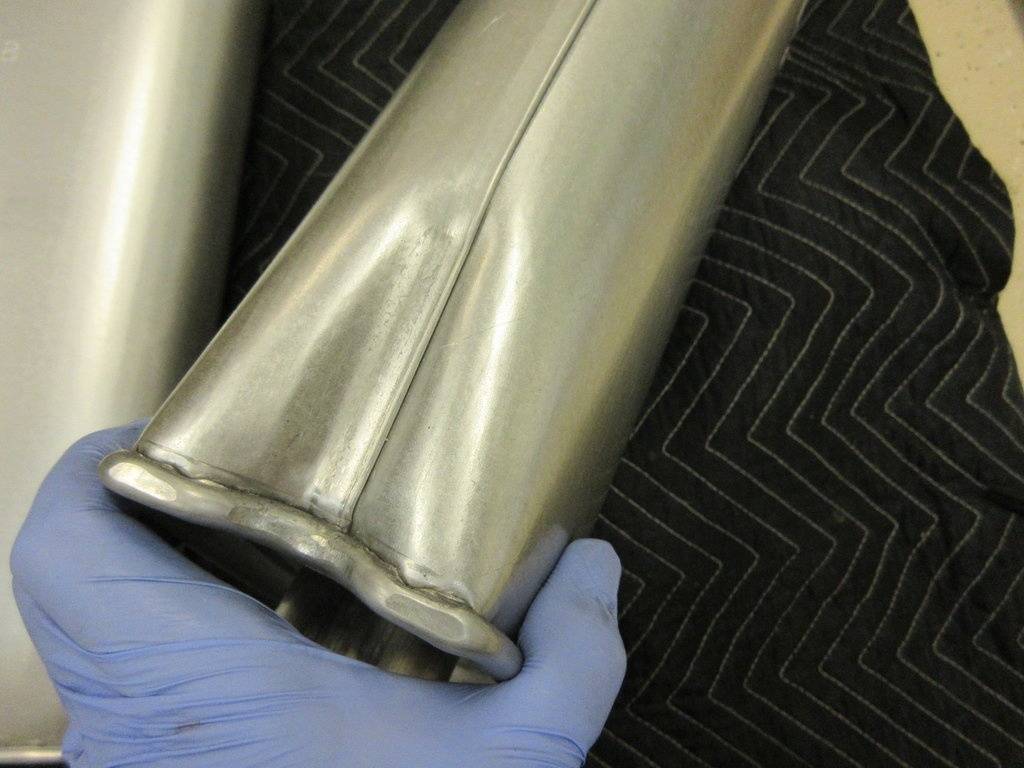

ECS mufflers versus Gardners
The gardners do not have a penststar and you get one date for that year. The graders also has a right and left muffler so the stamping on both faces down.
Last pic is the Gardner unit

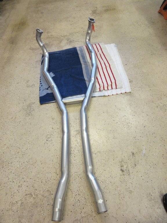

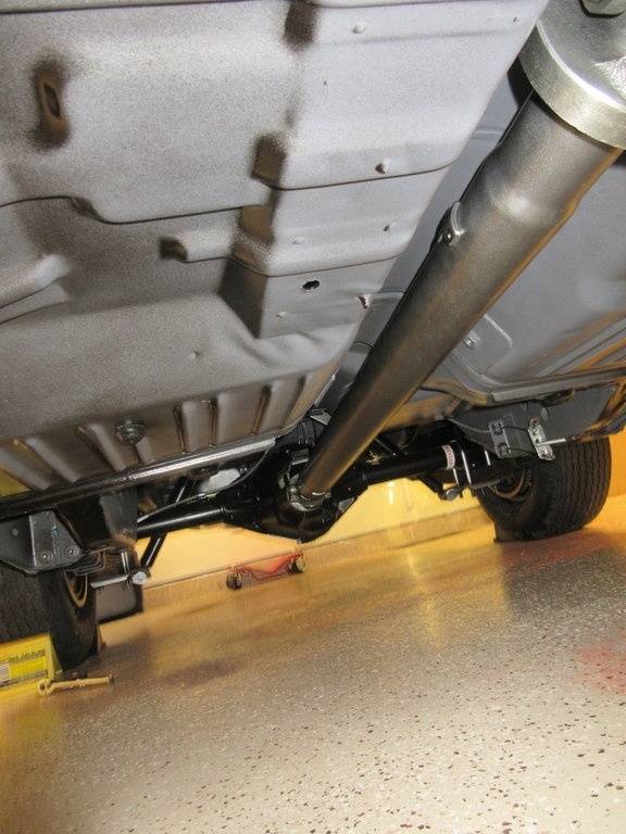

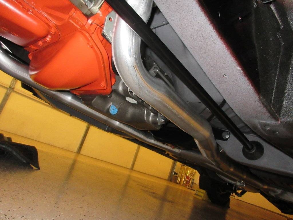

The exhaust system I use dis Gardners. The pipes have the correct finish, bends, flat spots ect..The fitment was spot on with NO major adjustments or modifications....On the head pipe they use a crush sleeve to seal the flange...

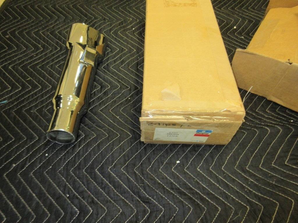

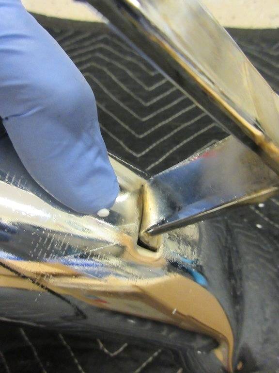

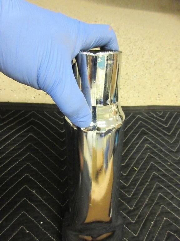

These are the real deal NOS tips....Key features are the weep hole and the welding inside the tube...

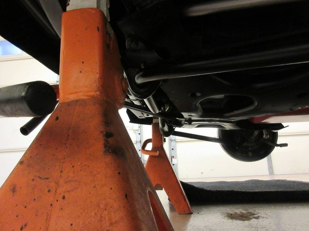

Regarding the weep hole on the tailshaft seal; I thought that the hole is supposed to point south, not west?

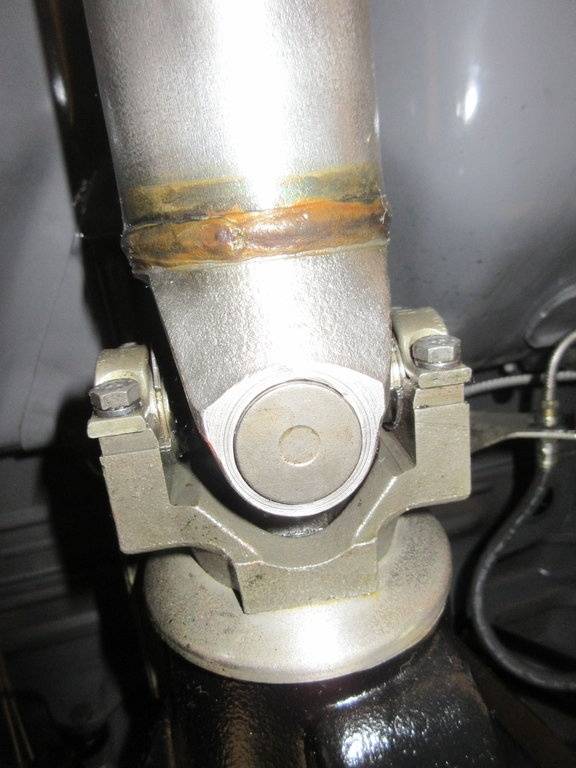

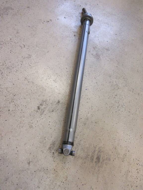

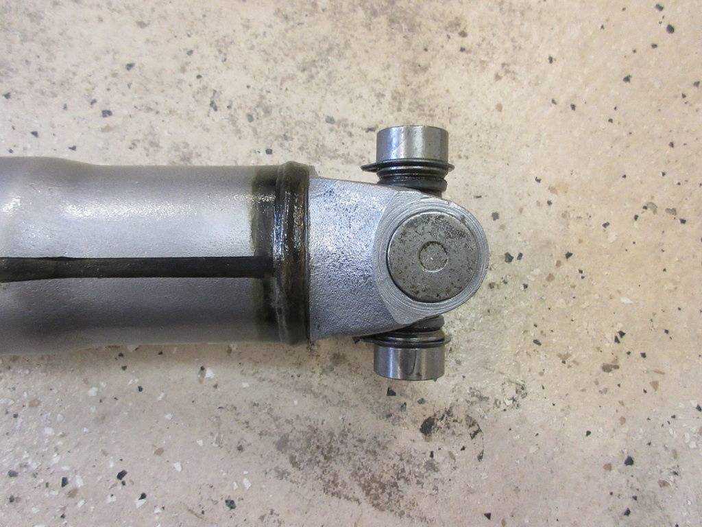

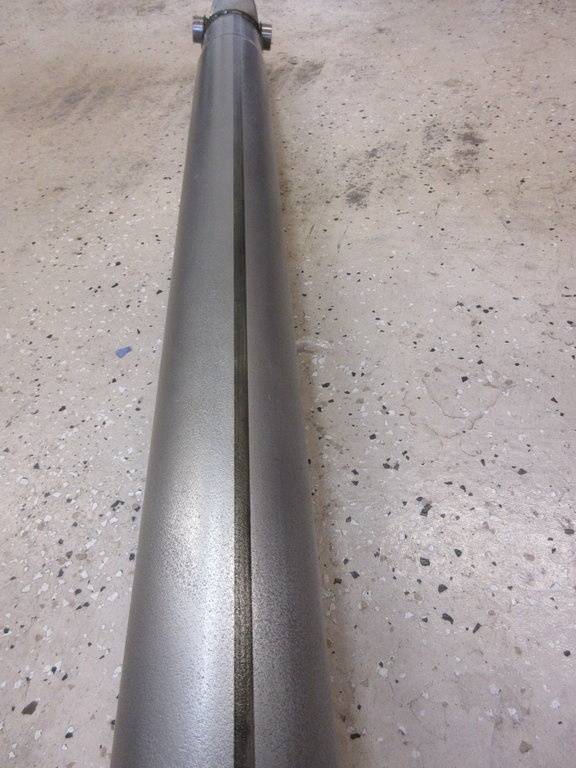

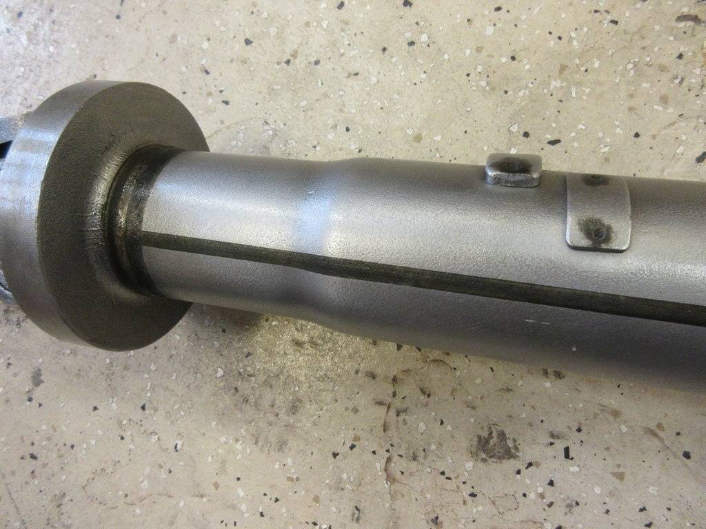

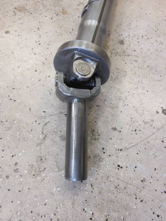

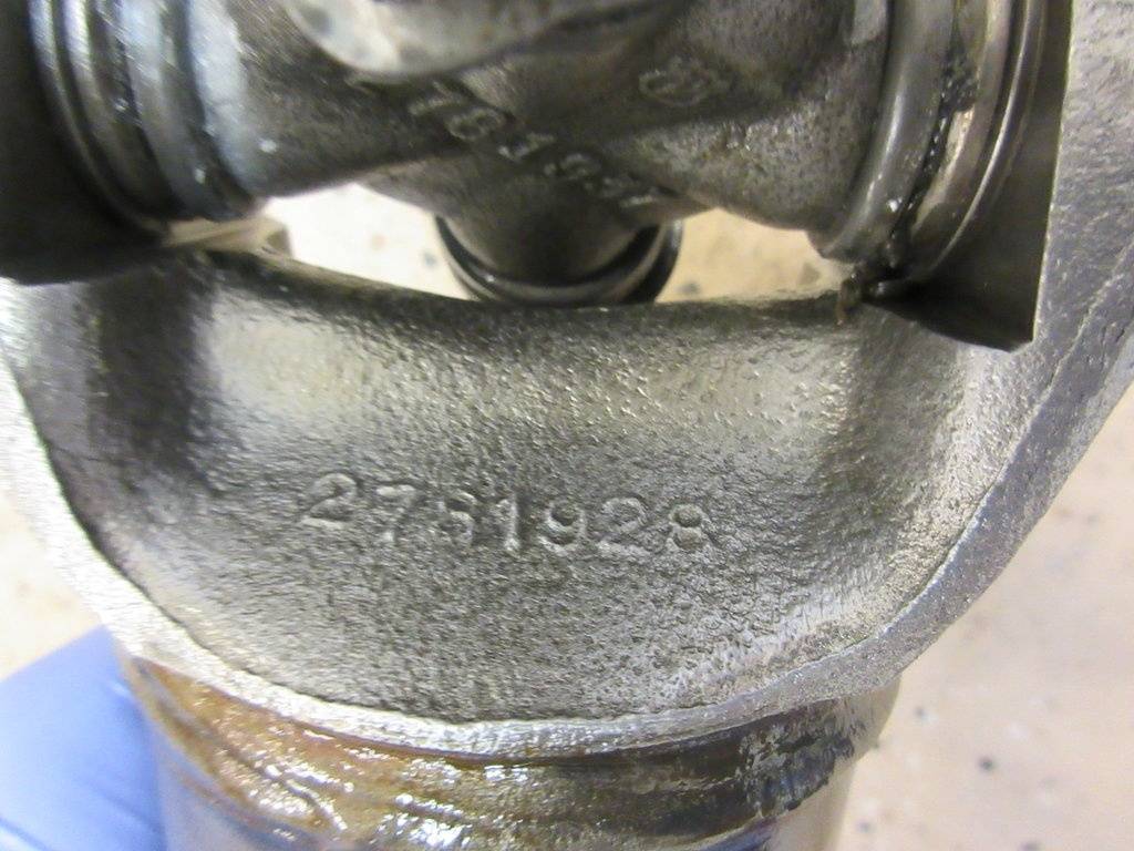

Original driveshaft was in mint shape. No pitting, scratches, dings, or dents...And readable PN's....I bought a 6ft PVC pipe and soaked it in evaporust. Then the work began. I cannot even fathom the hours spent on this one part but it turned out great. Special chemicals were used to create the weld look on the ends and tubes.

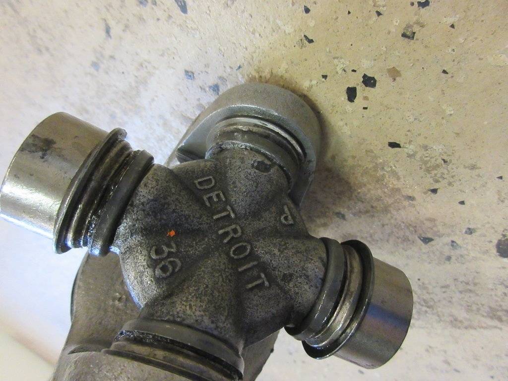

The NOS U joints are correct and very rare to runs across and extremely expensive....I also luck out on getting the cup strap clips for the rear joint. The factory used these during assembly so the cap didn't fall off. I am waiting for the strap to come some...

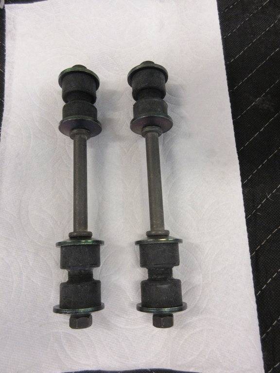

Original sway bar was degreased, hand sanded and painted with gloss black. Original bushing are are in pristine shape and notice the part numbers and DPCD logo. The sway bar bushing set is a spot on report set from Brewers performance..

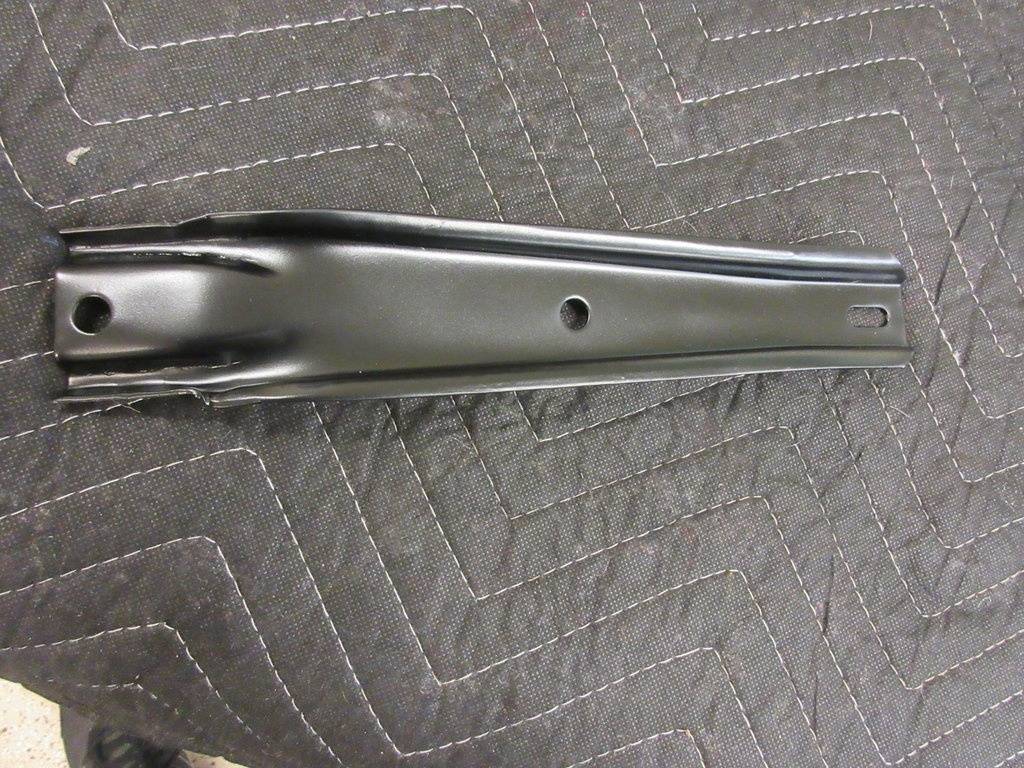

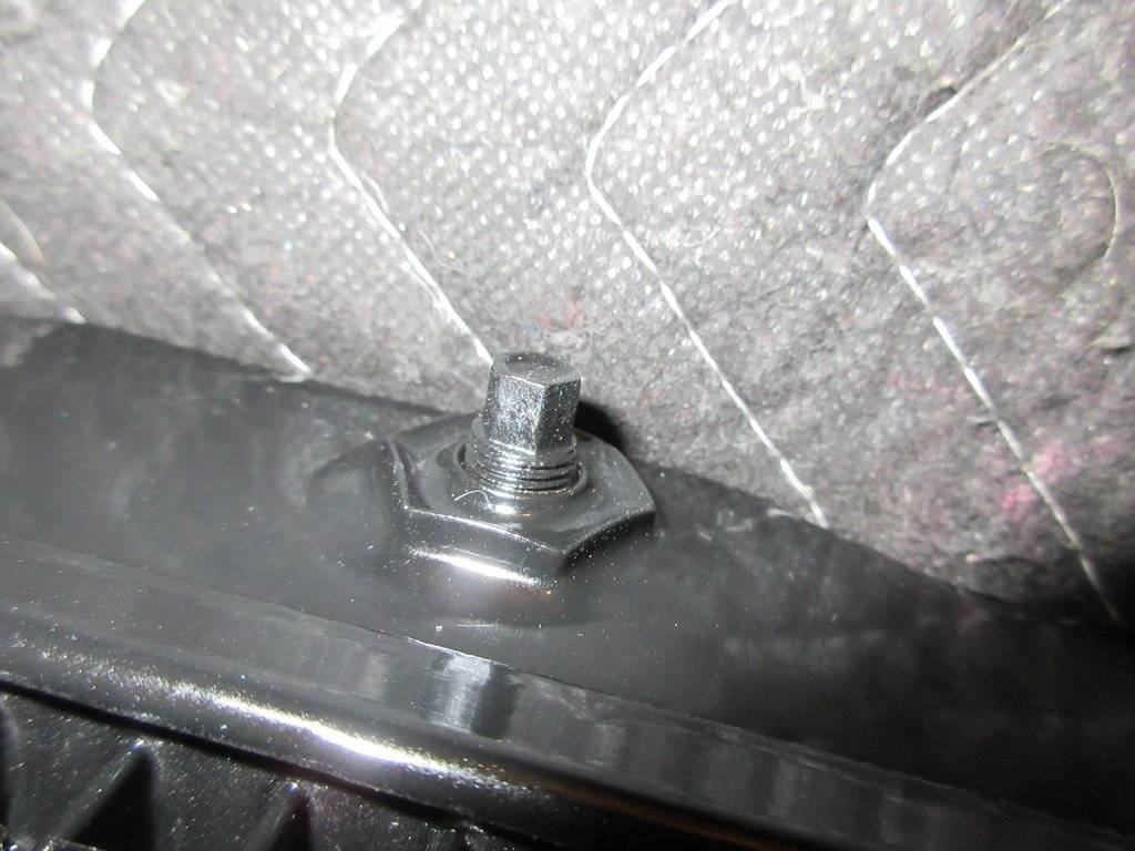

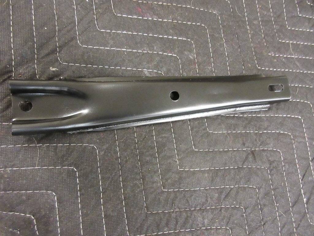

Radiator support brace was painted with gloss black. Original hardware was sent out for zinc phosphate.

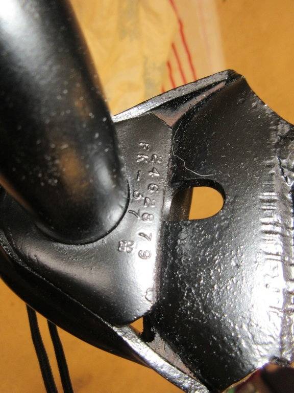

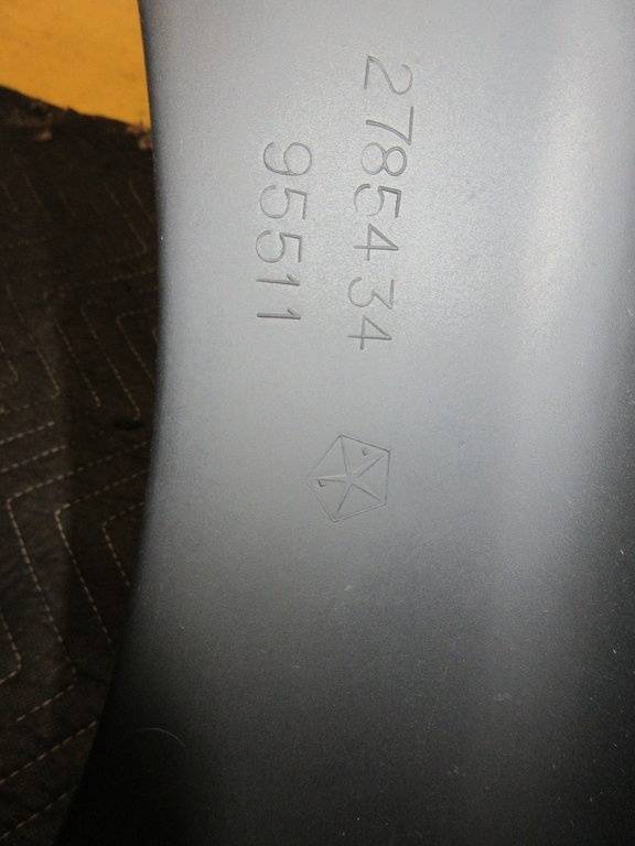

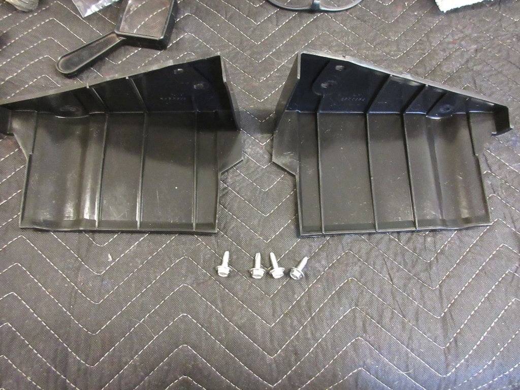

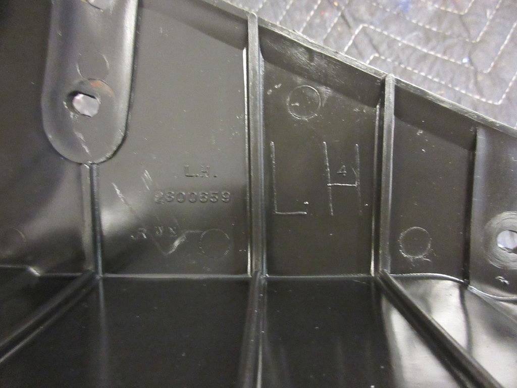

Original K frame splash shields were unusable to scratches, dings and cracks....The repops do not have the larger "RH" "LH" and part number format. I probably went through 50 sets of these to find 2 usable ones...Why? If they are new they have no scratches, dings, ect. Since NOS is long gone imagine finding a used set of these that are like new...It is a needle in a haystack....

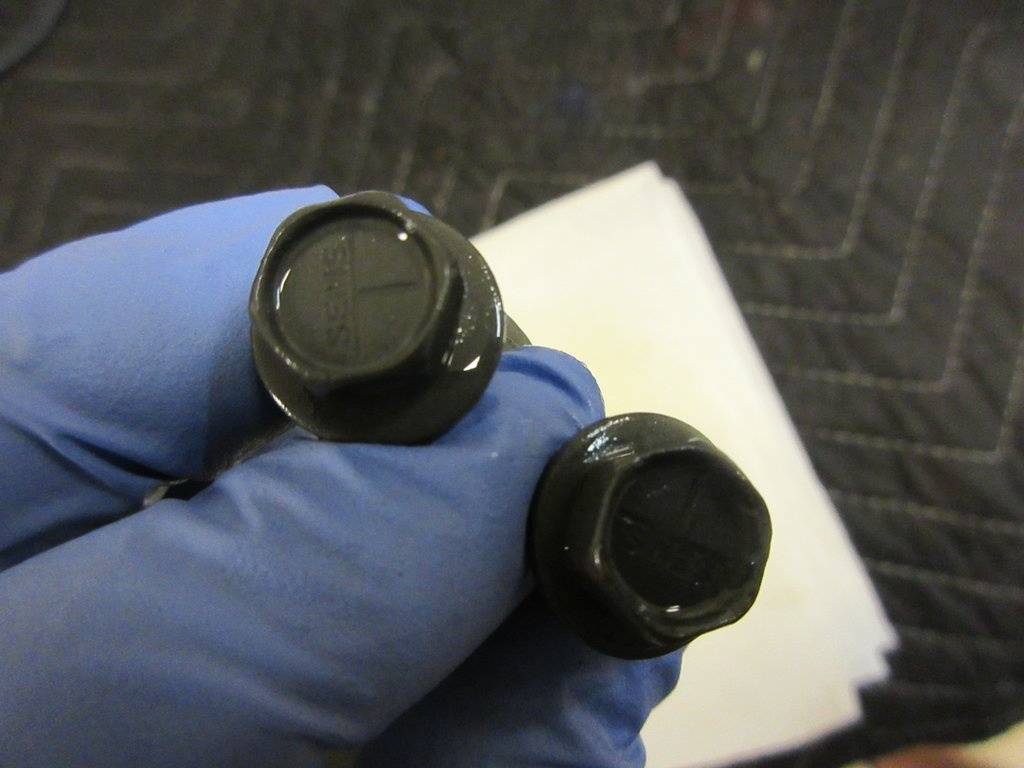

Mine were not riveted in and these are the original screws that were plated.

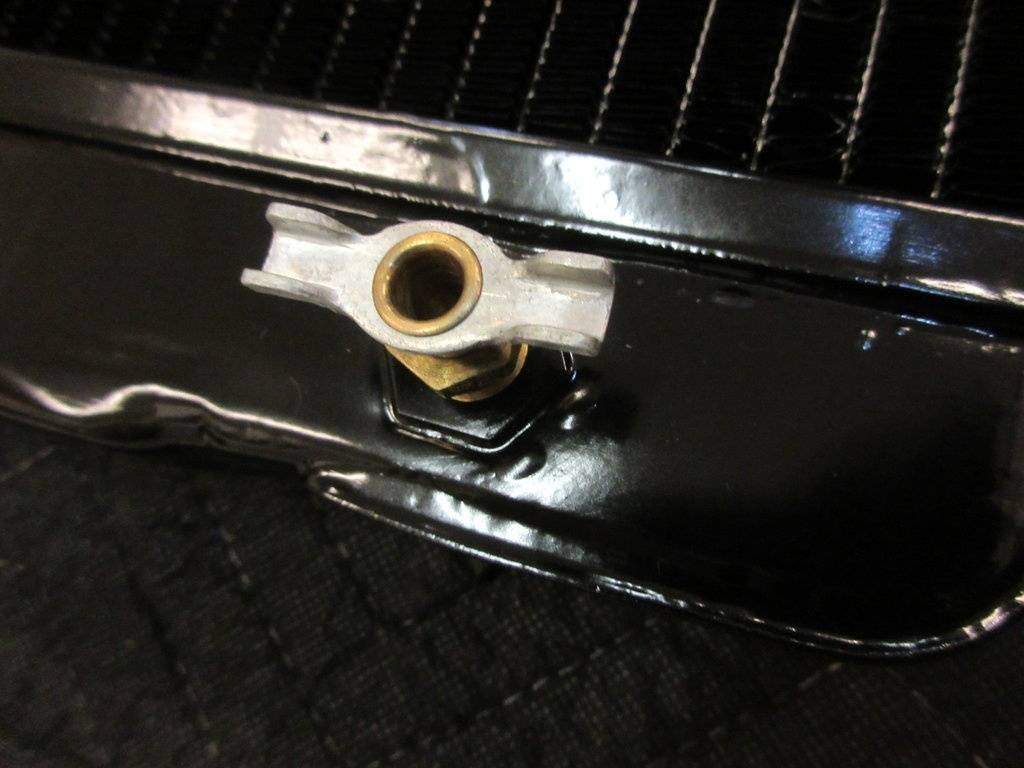

Here is the original radiator that was sent out a recored. Correct part number and date. I coated it lightly with eastwood radiator paint. The petcock is NOS and has the correct markings on the backside. This is a 4spd car so notice the original plugs in the cooler line holes.

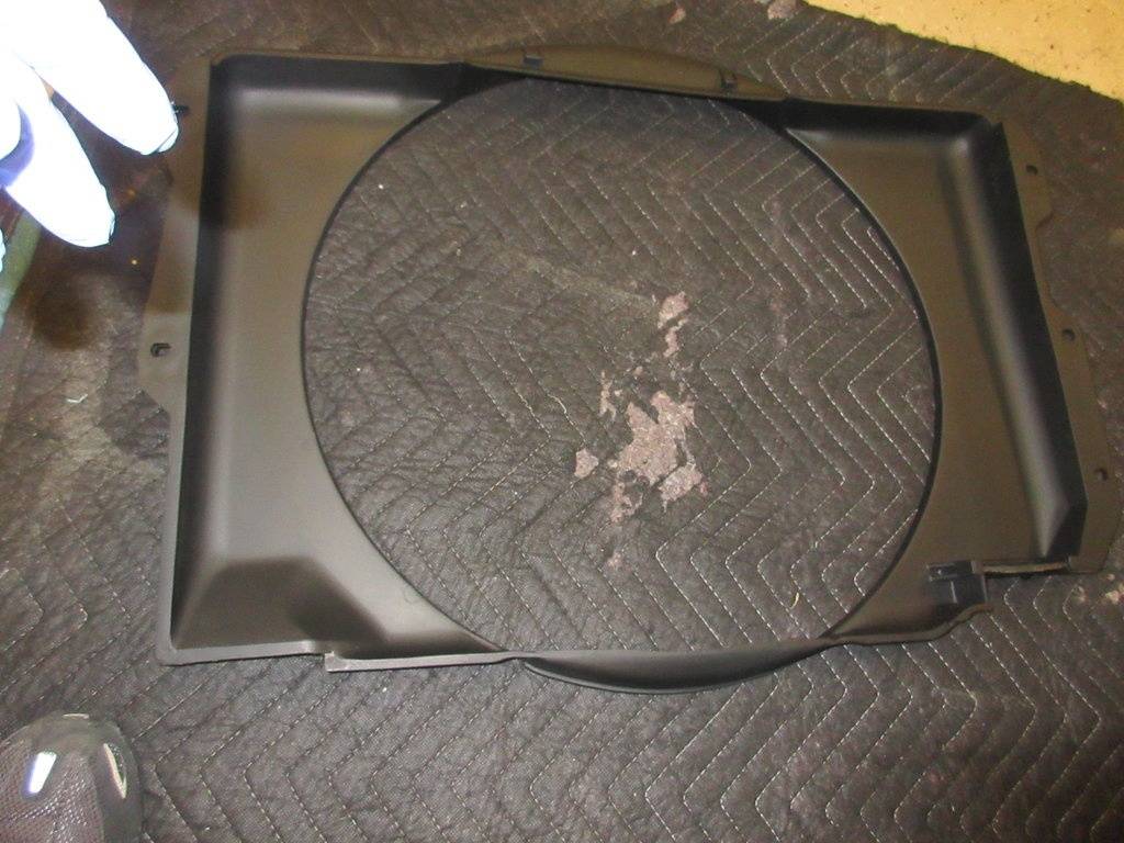

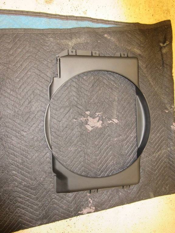

Original fan shroud was cleaned up and dyed..

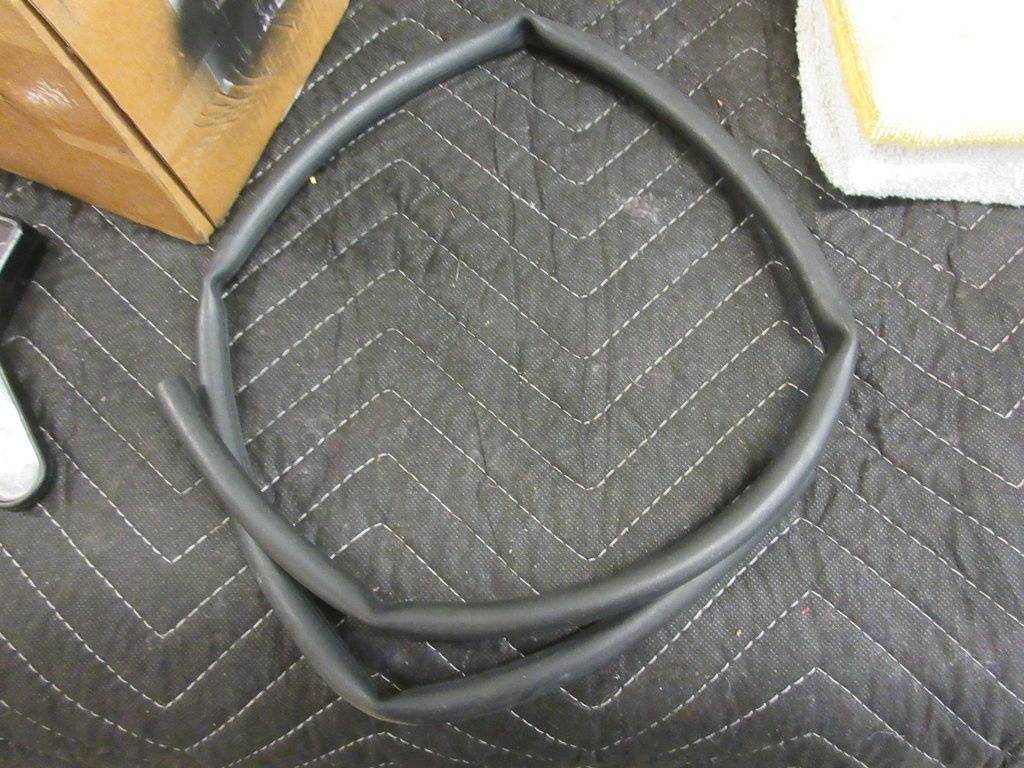

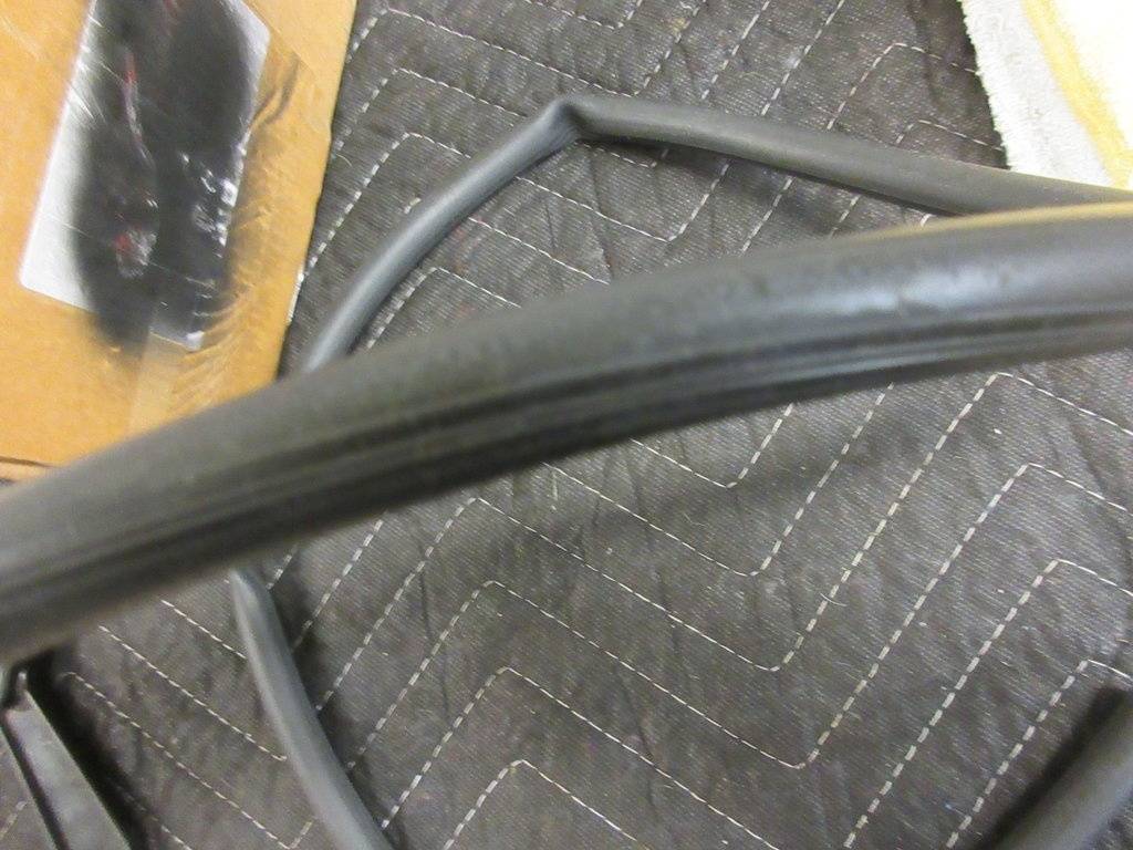

NOS radiator overflow hose
