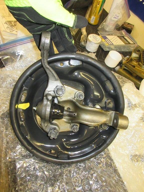

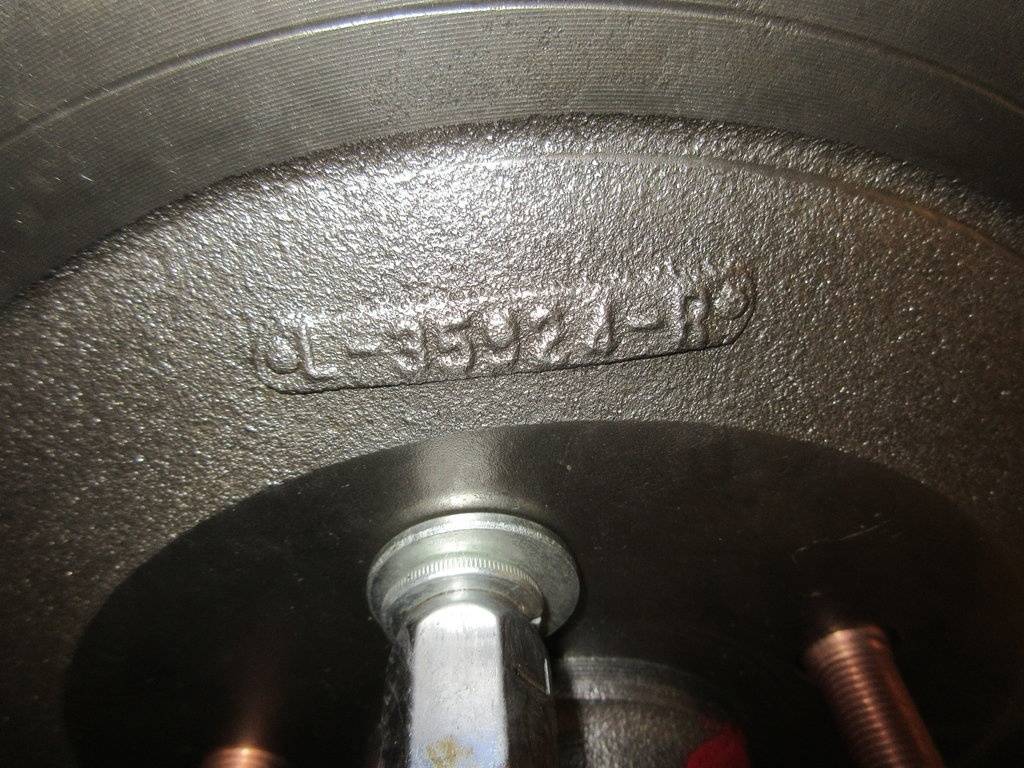

For the Love for my Father, My 69 GTX Restoration
More pics

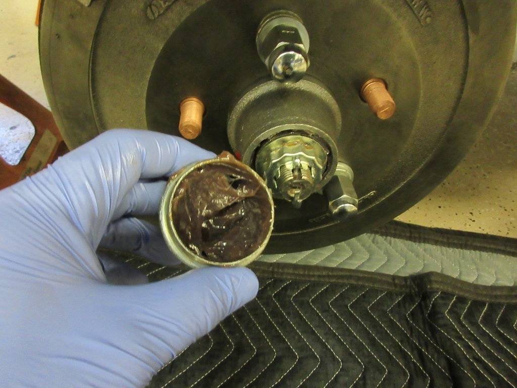

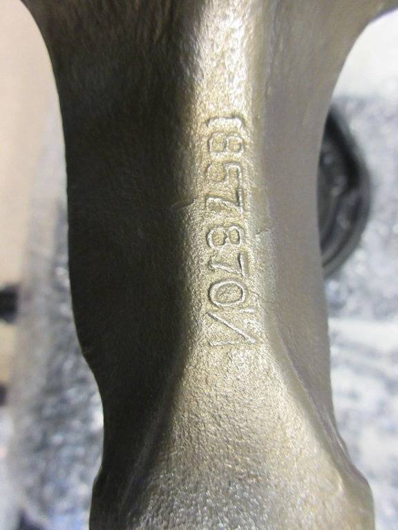

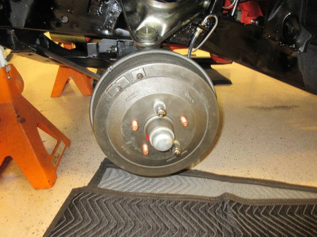

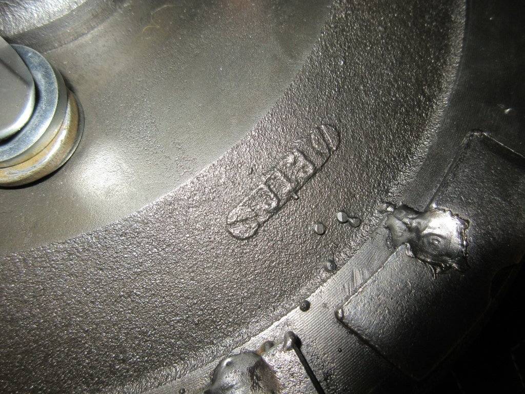

The 4th and 5th pics show the finish better on the spindle...

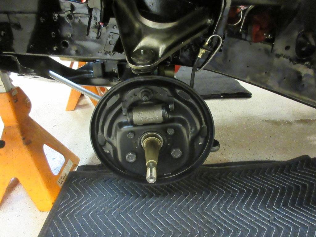

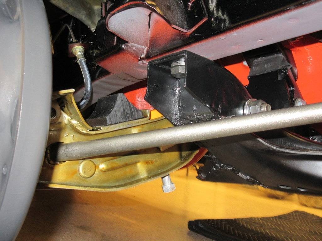

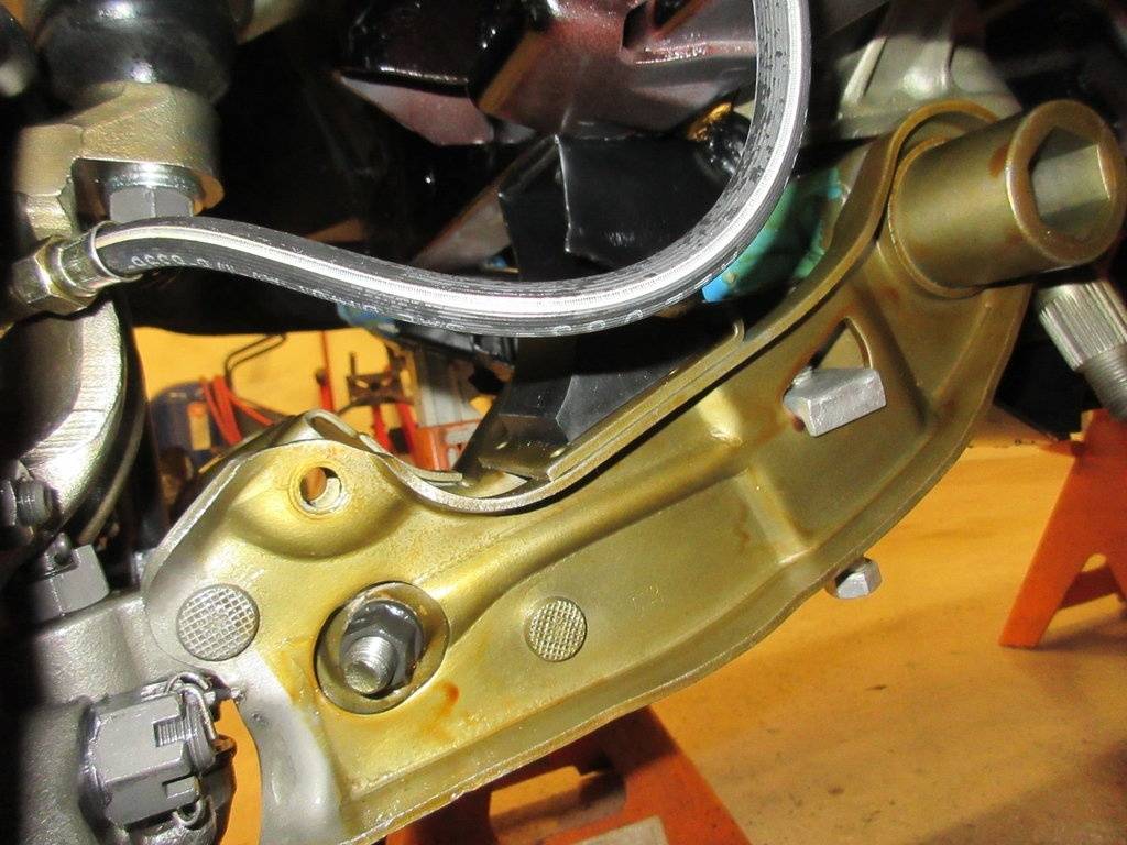

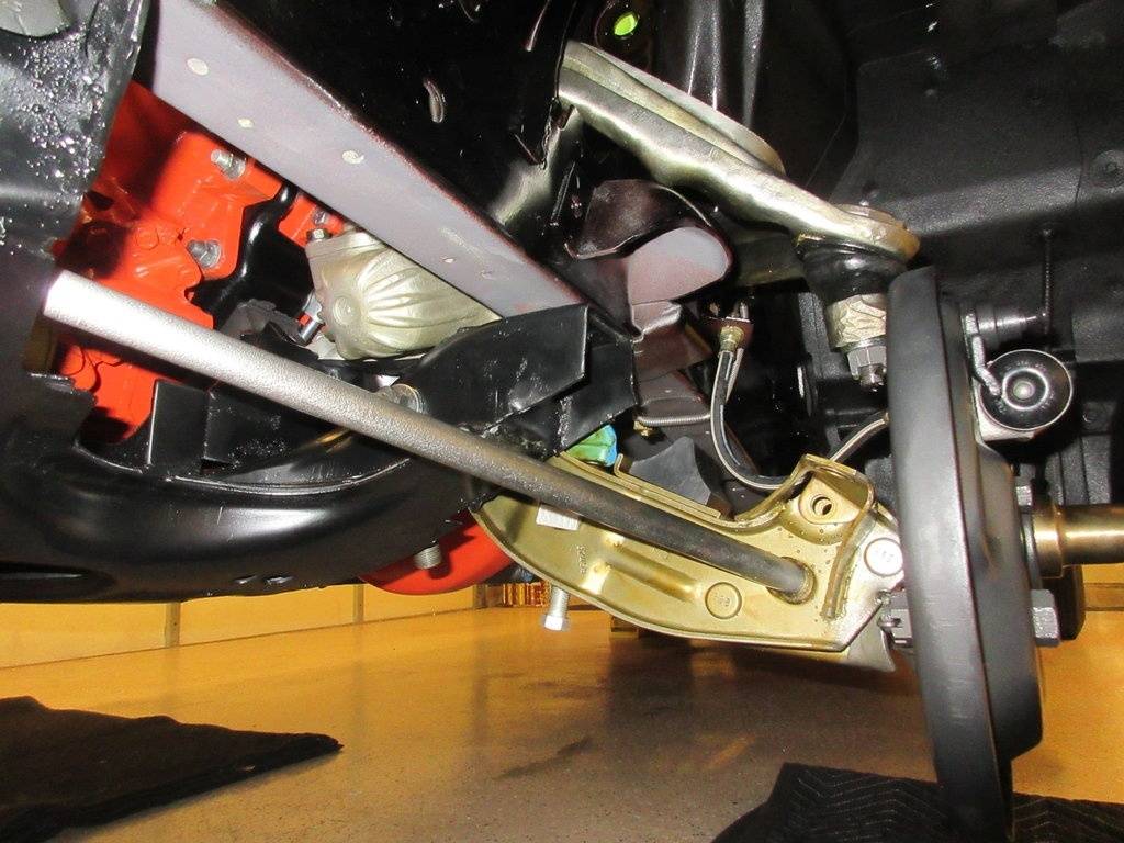

Installed both sides and some things torqued to spec rest will be torques when torsion bars are put in.....
Remember leave bump stops, shocks, pivot shaft nut loose and front strut bar nut loose until torsion bars are in.....

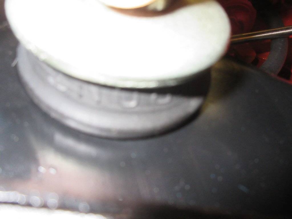

Along the way you do run across surprises...When I was putting the grease cup on the idler arm it tore:mad: I will order 2 this week just in case, lol....Then after that I cannot locate the front strut bar nuts for anything....Lastly the clutch fork rod I sent out for the correct finish. I cannot find it anywhere.....After the car is done I will probably find that, lol

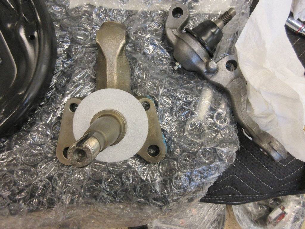

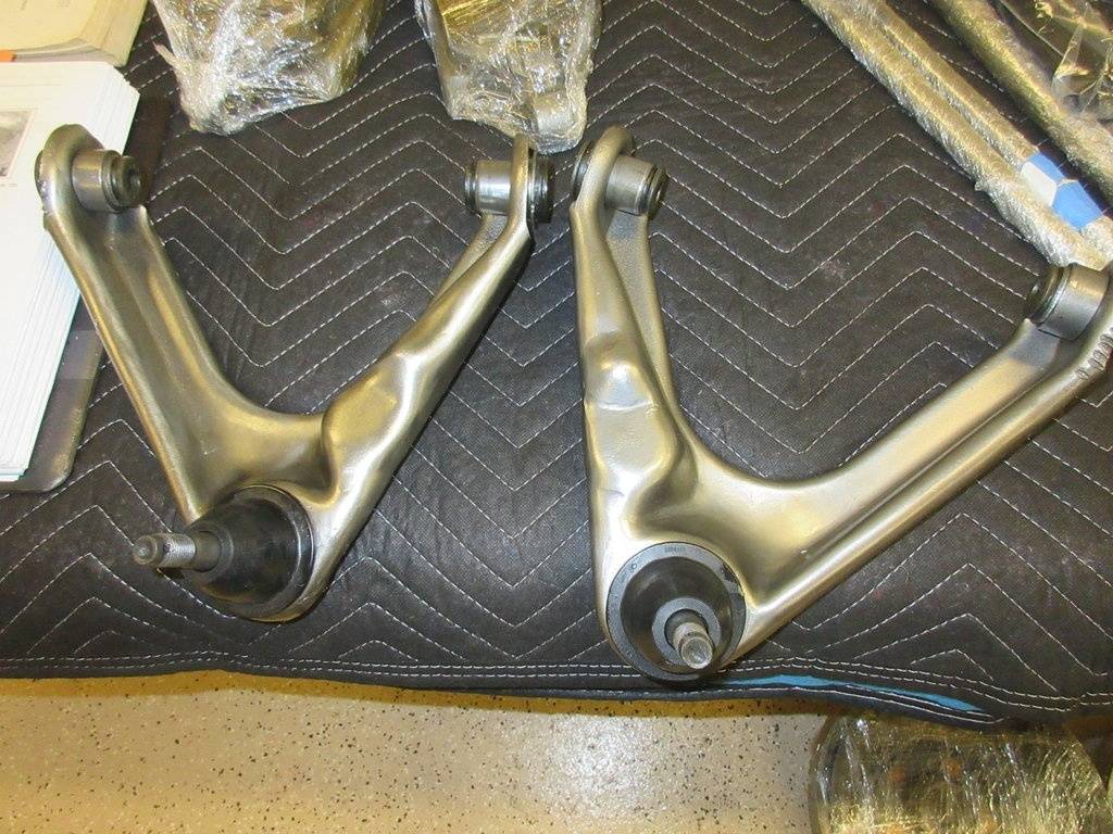

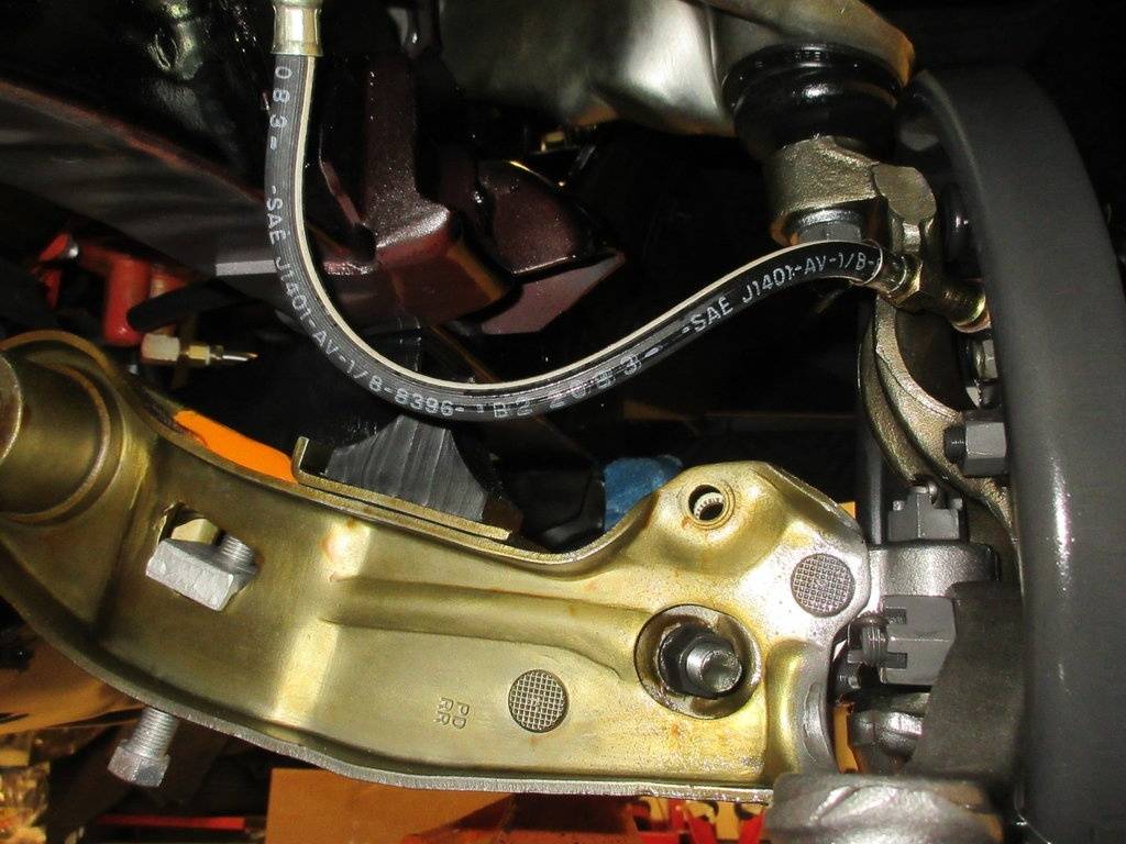

When I was working on my Hemi Charger years ago, one (on each side) of the upper control bushings had a collar inserted over the inside portion of the bushing. Can't remember if it was on the forward or rearward facing bushing, but it was the same on both sides. I don't know if it was a 68 thing or another one of those odd Hemi things, but I was wondering if yours had that.
It did have those collars on both...Look closely at the pics. It goes on the rear bushing. They are also mentioned in the 69 service manual as well and came with HD suspensions....These things are also a PITA to get off and somewhat easier to get on...
My charger had them as well....I do not know who carries them. Mancini used too but not sure if they do anymore..

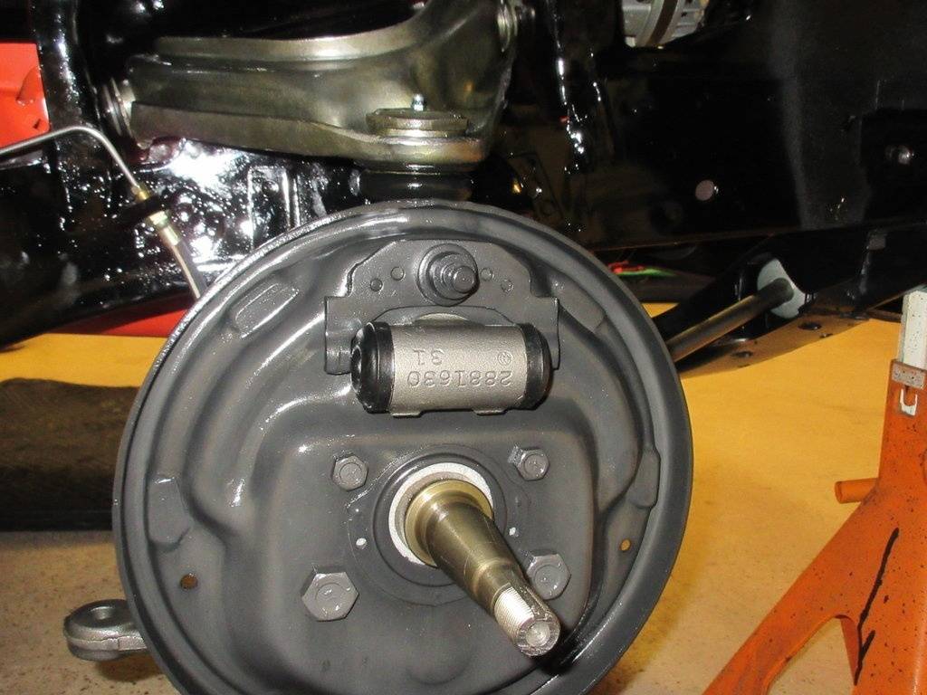

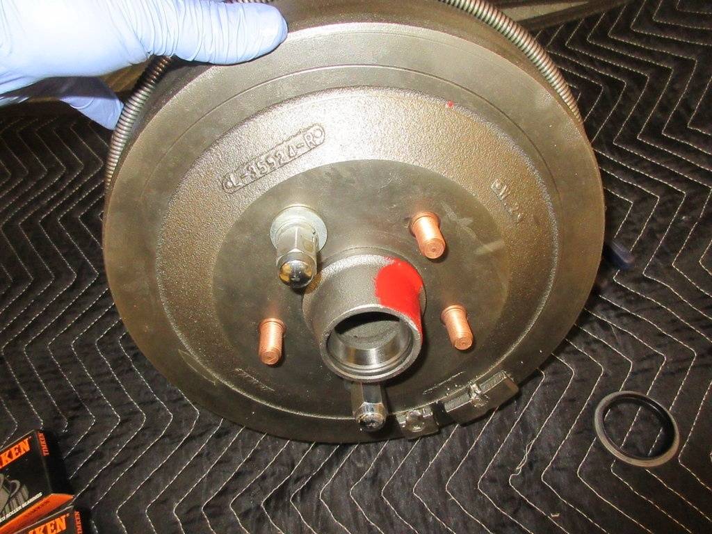

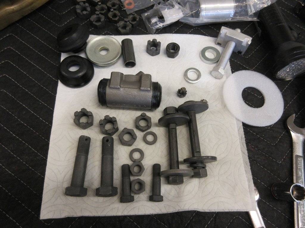

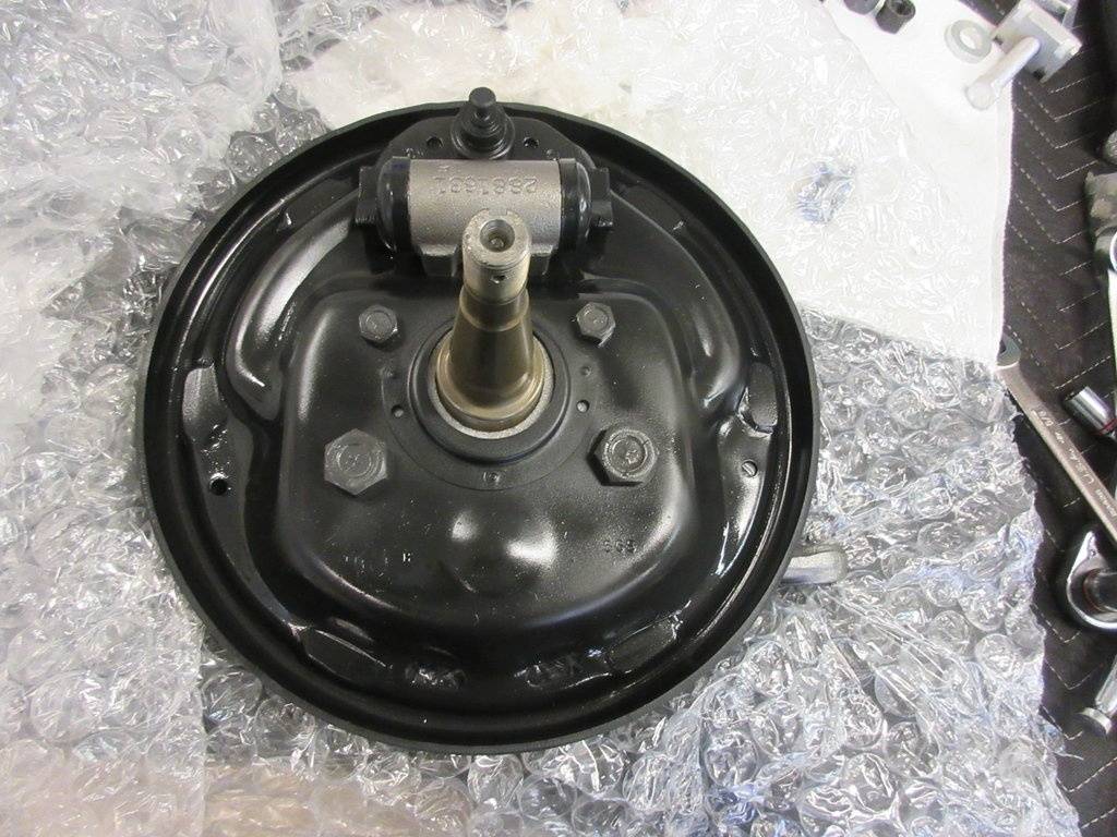

Hey Justin. Looking great! Why did the factory install the wheel cylinders with the PN #'s upside down?
Roger
Good question and I really do not have an exact answer. Maybe they sat in the bins better with the part number molded that way. They only go in one way and if placed on the wrong side you cannot hook up the brake hose. On the assembly line the bins are on opposite side so they wouldn't get mixed up.
Maybe someone can chime in with their thoughts....
