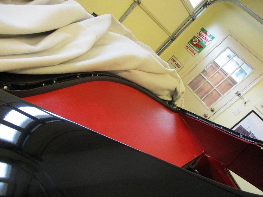

Rear package tray trim installed....Getting ready for glass...

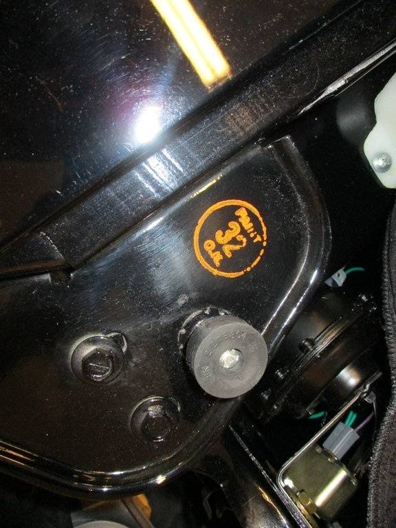

Paint "OK" stamp based on assembly plant Lynch Road...Special thanks to Darrin for supplying the correct stamp!

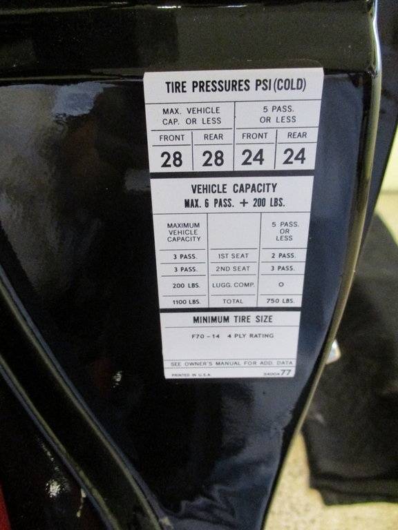

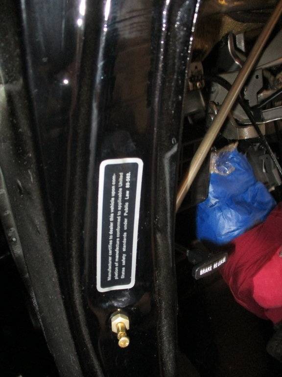

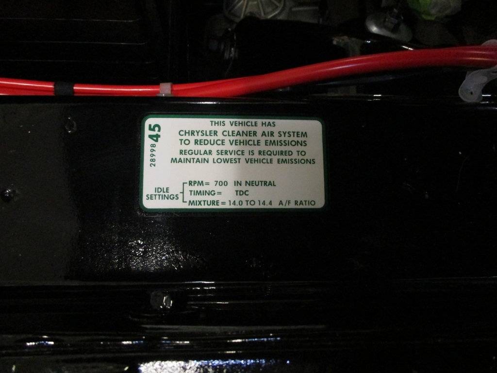

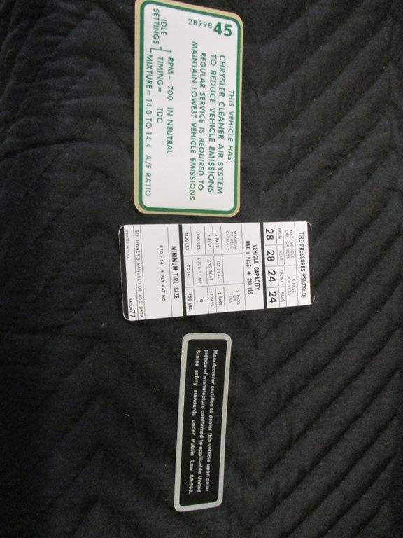

Installing some decals....

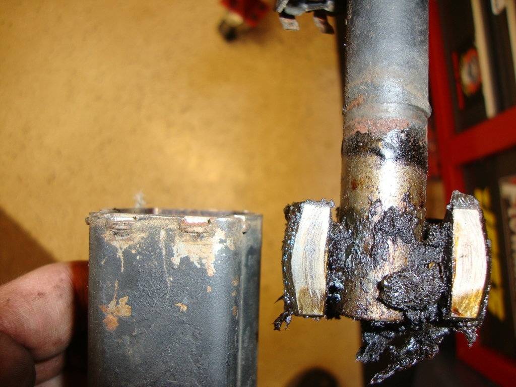

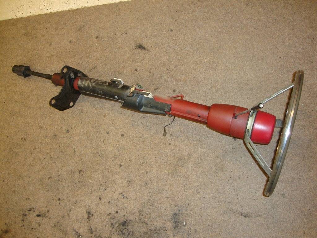

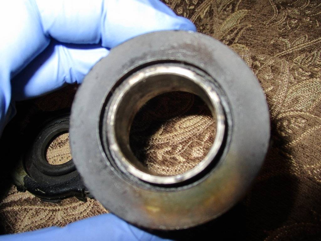

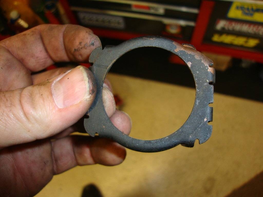

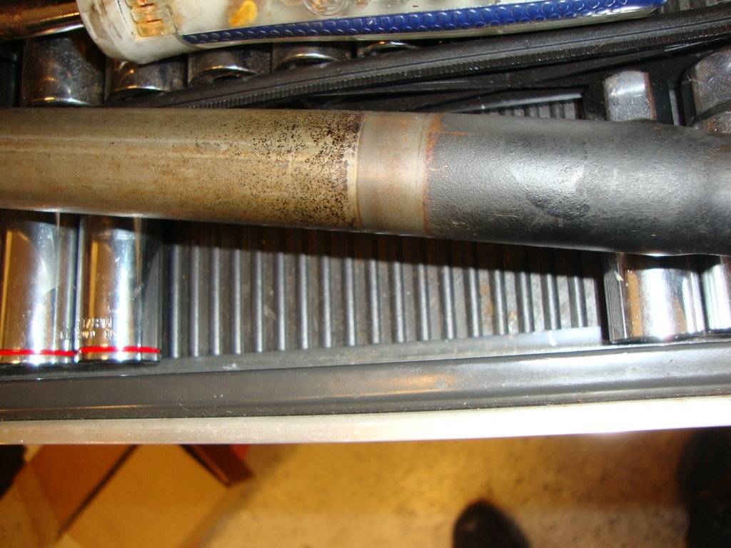

Looking good Justin! On the lower column bearing...how tight of a fit should the bearing have on the shaft? My new and old bearings both slide up and down the length of the shaft and I'm not sure if it's supposed to be a press fit like the upper bearing or not.
Steering column is my #3 thing I procrastinate.....

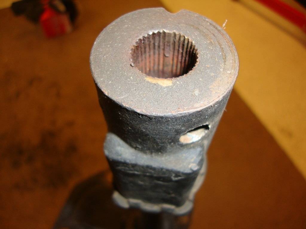

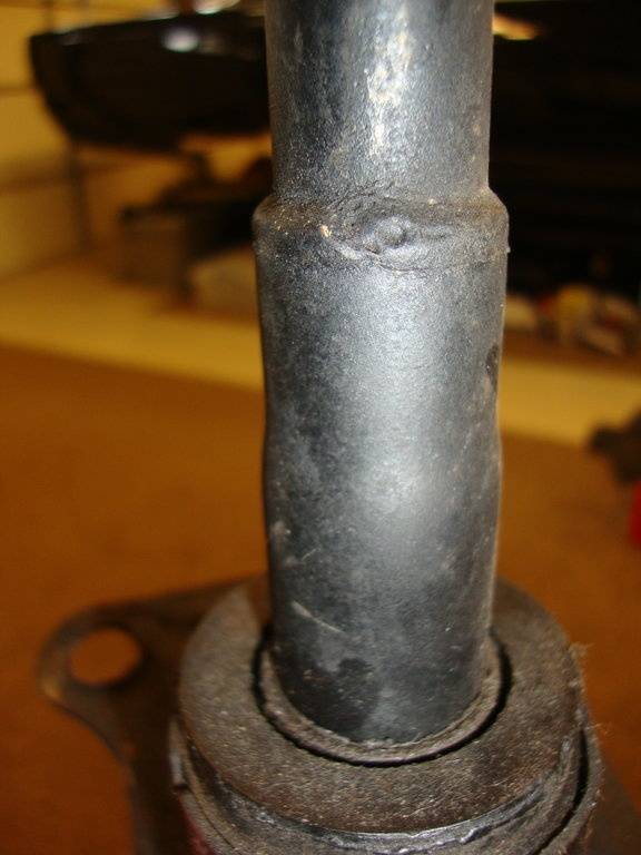

Be sure to document everything during disassembly it saves you tons of time.....It has been debated that the ends of the columns were dipped to the level of the bearing or they were natural. Many experts side that they were dipped and few say was plant dependent. However, there is no question my was dipped, see pics below...
Chris
Thanks for the compliment
They do slide up and down the shaft. The slot and the two screws hold the retainer in place. So yours is correct...
