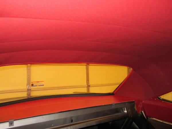

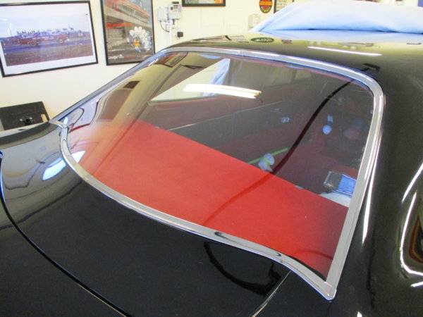

Friday was a rather busy day. The windshield guy came back to reinstall the rear glass. Long story but when it first went in the clips would not retain the trim. So he came back a week later and removed the glass and took the clips with him. Rob has to adjust the clips so they would lock in the trim properly. This past Friday he came back with the clips and installed the glass and trim. Everything installed beautifully and flawlessly.
Again do not always bank on because it is new it works....In the end it is sad that even reproduction window trim clips(the rear) have to be modified.

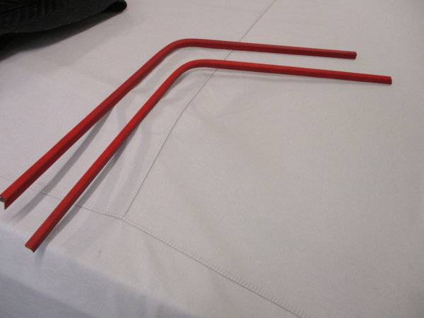

Next on the agenda was to install the 3 piece inside rear window trim. Sounds easy but why are they such a PITA to install. After dome time and some not so nice words it is in...

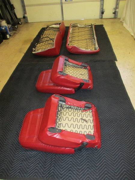

Now it is time for the seats!

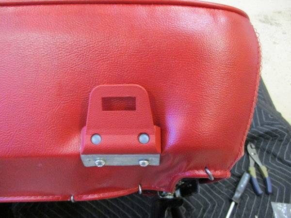

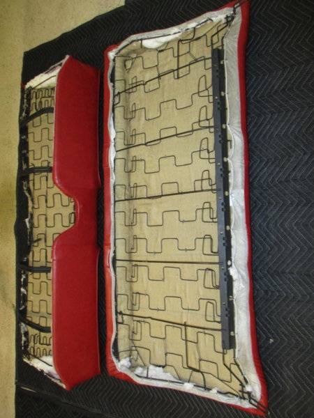

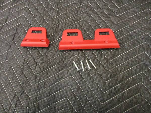

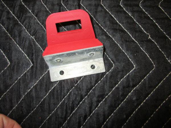

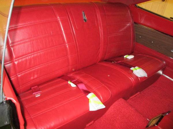

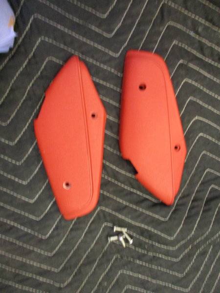

Of course the rear is going in first. First thing I have to do is to install the right and left seat belt holders, Single goes on the passenger side and dual on the driver side. These are easy to locate and to much a hole with a pick...So don't get upset if your installer doesn't do this...These are things I would rather do myself anyways....

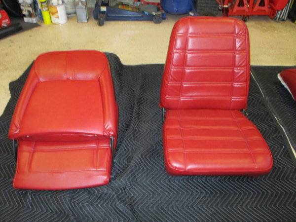

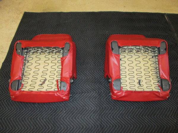

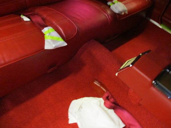

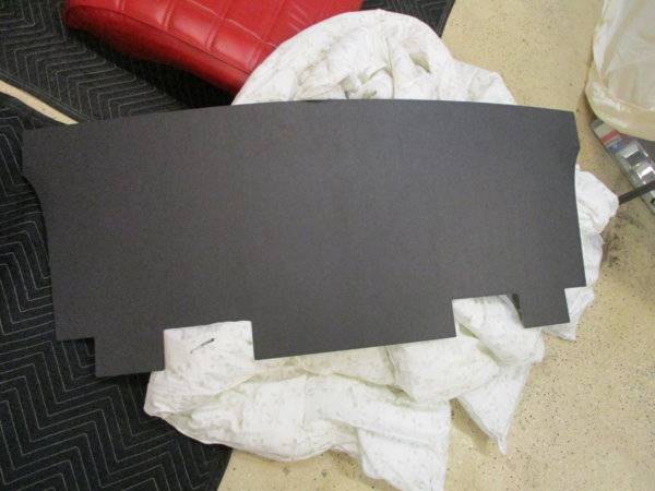

Reproduction trunk divider goes in first and the the back portion. Do not forget to bed the lower tabs to hod it in place. Then goes in the seat bottom. No big tricks here other than a little brute strength....

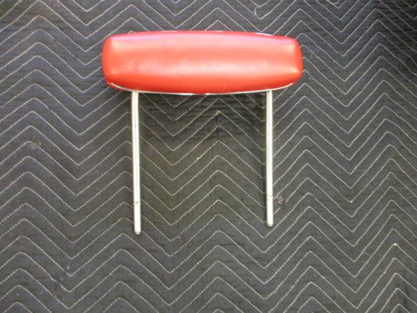

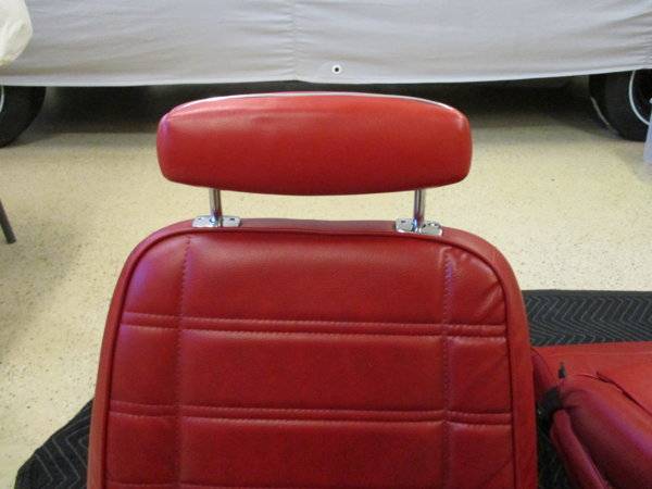

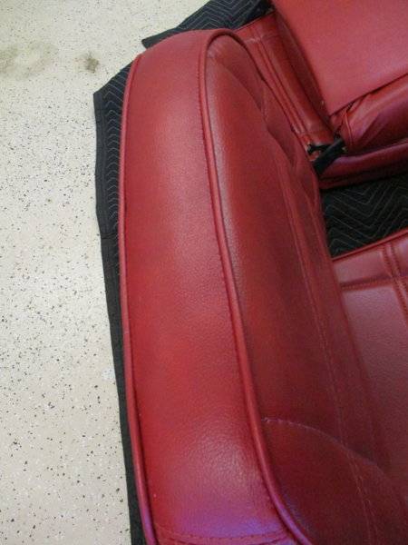

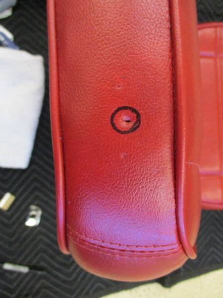

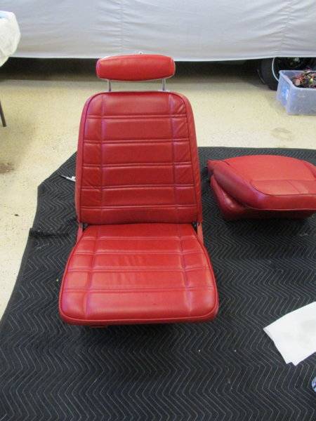

Now onto the front seats which is what I did today. I did not want them to cutout for the headrests. Why? Because I know how to do it and they probably do 1 mopar seat for every 200 chevy seats. Second reason I do not want my pricey chrome pieces lost or messed up. These are easy to cutout just find the center of the hole on the seat and stick a pick in the center then take one bracket as a template and center the hole and take your pick and fine the screw holes. I marked the inside with a sharpie and cut it out...
The original headrests were Professional restored by Not Just Headrests.. A no brainer to use this guy BTW!

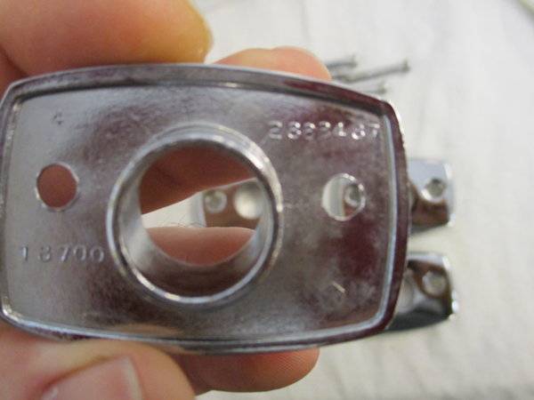

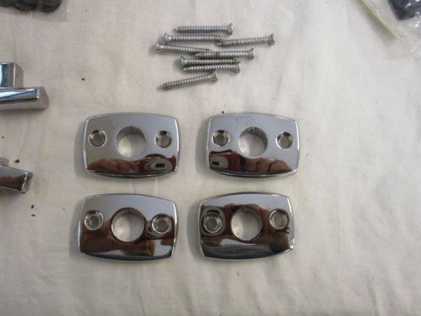

The chrome pieces were plated by Paul's. The seatbelt holders and hinge covers were restored by Dave Patik at PCG.

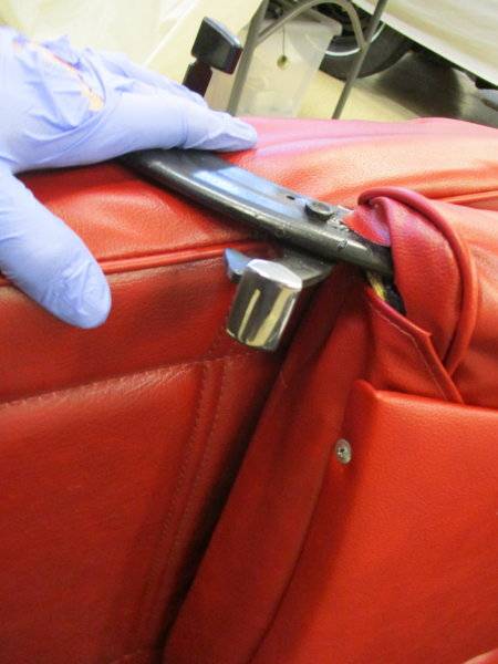

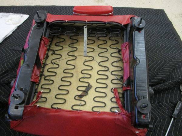

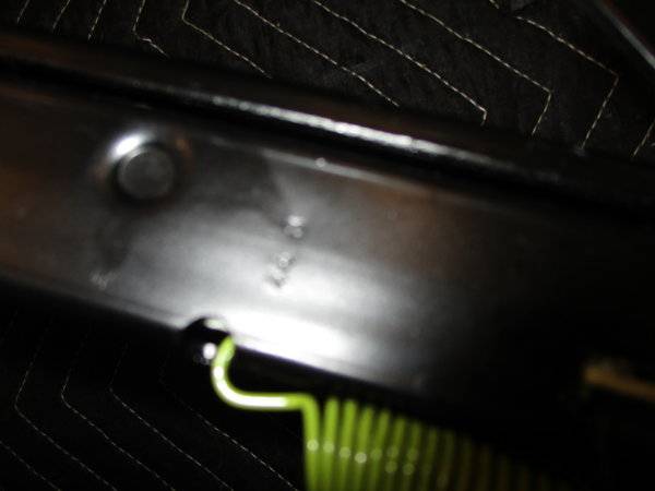

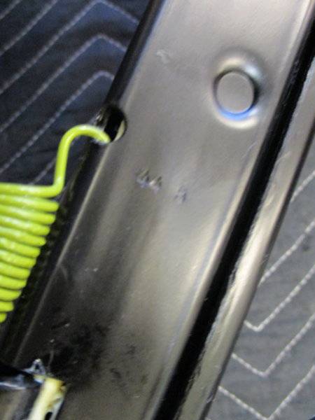

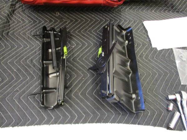

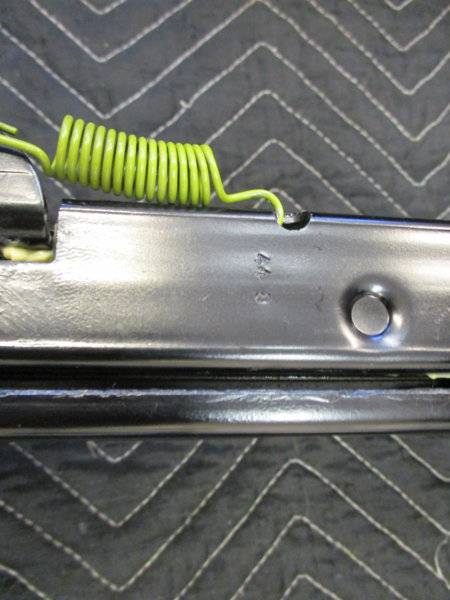

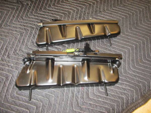

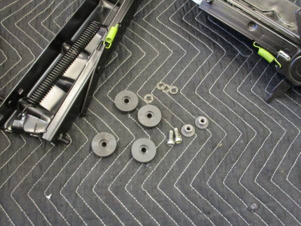

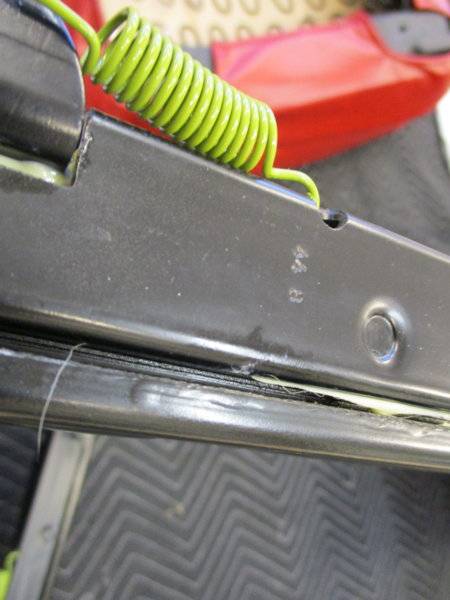

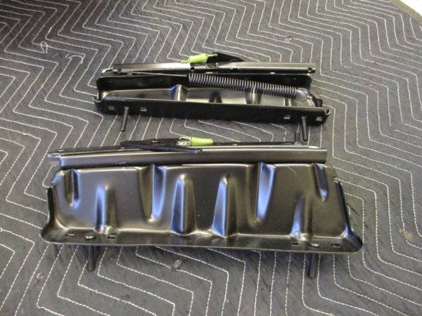

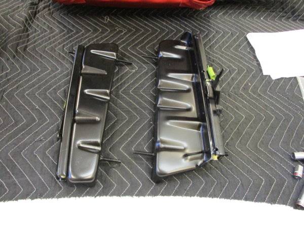

The original seat mechanisms were degreased, stripped chemically and soaked in evaporust. They are semi gloss black. Also be sure to thread chase everything prior to painting. All springs were assembled originally after painting which is why they are different colors. Original nuts were phosphated and the bolts where left as is. The springs can be a challenging to keep from scratching things so be careful and take your time.

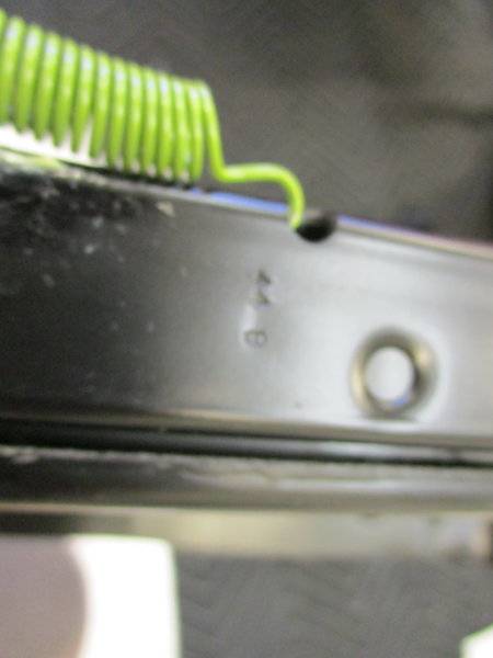

These are all dated on the topside that meets the seat. All of mine had the same date 44 8, 44th week of 68...

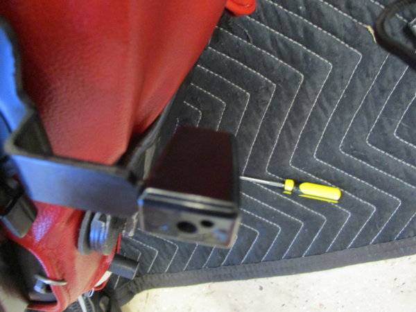

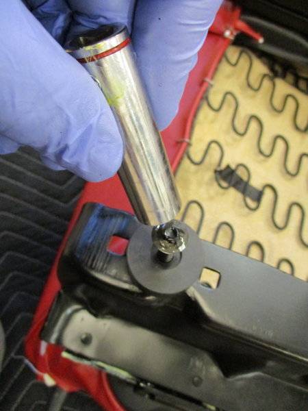

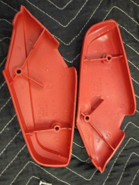

The spacers and holders are new. I use a socket and screwdriver to install the holder clip.

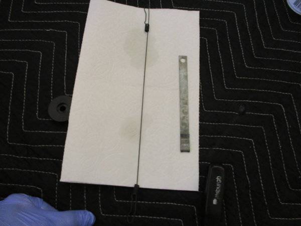

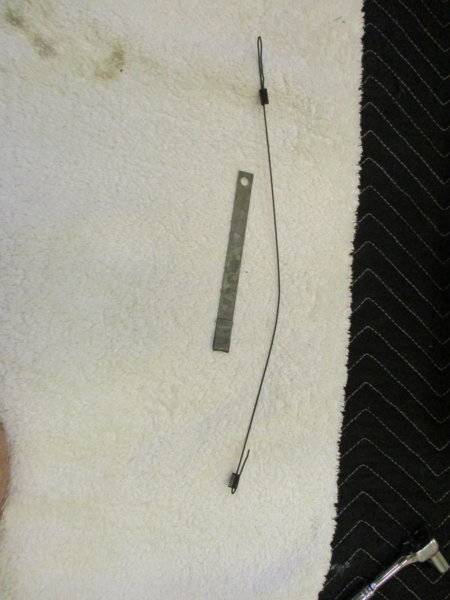

The adjusters on the seats have a wire and a bracket. The short wire and short bracket go on the driver seat and the long bracket and wire go on the passenger seat. One end of the bracket goes on the eye bolt on the seat(adjustable) and the other holds the wire. You can adjust this point to increase or decrease tension as needed to engage the release and lock for the seat sliders.

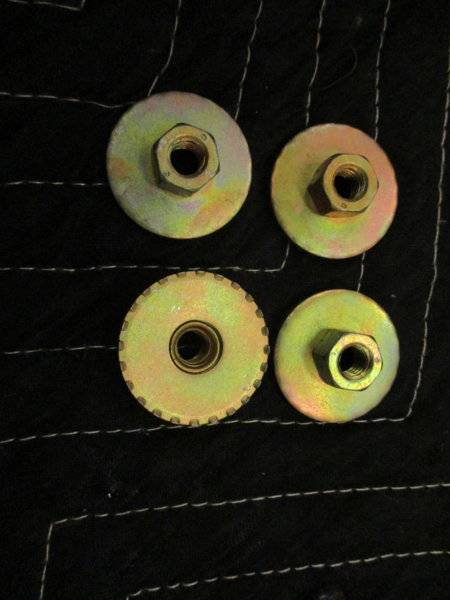

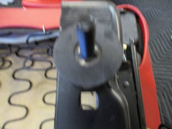

These are the original nuts that TA plated to hold the seat to the body. Notice how cared the washer is and that teeth. Reproductions are typically smaller washer size and teeth.

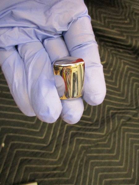

The release black lever knobs are NOS and the seat release back knob was plated by Paul's Chrome....

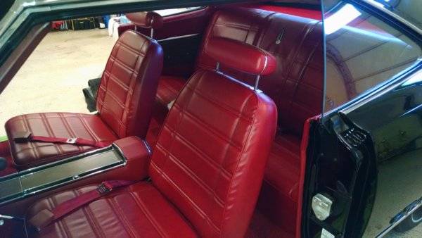

INSTALLED! Holy crap it looks like a flipping car I am literally beside myself....What a journey this one has been...
