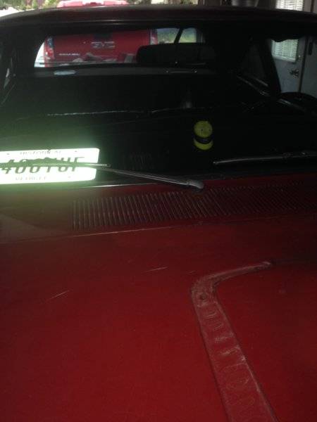

Did I mention those SOBs at the paint shop painted my posts? I'll have to get those clean first. Thanks for the tips.That is the main reason why people install them incorrectly.....Make sure the inside of the slotted area is clean....I take some oil and rub in that area....
You can be brave and not protect anything or be safe and take an old towel and cut a hole in it and place over the pivot for protection. I bend back the end a bit that attaches and slide on just enough to hold it but doesn't engage the locking tab. Keep in mind that does not mean you can let it go and run to the other side because it can pop off...This is just to see where the blade lands and then readjust up/down as need be....Do one side at a time...
