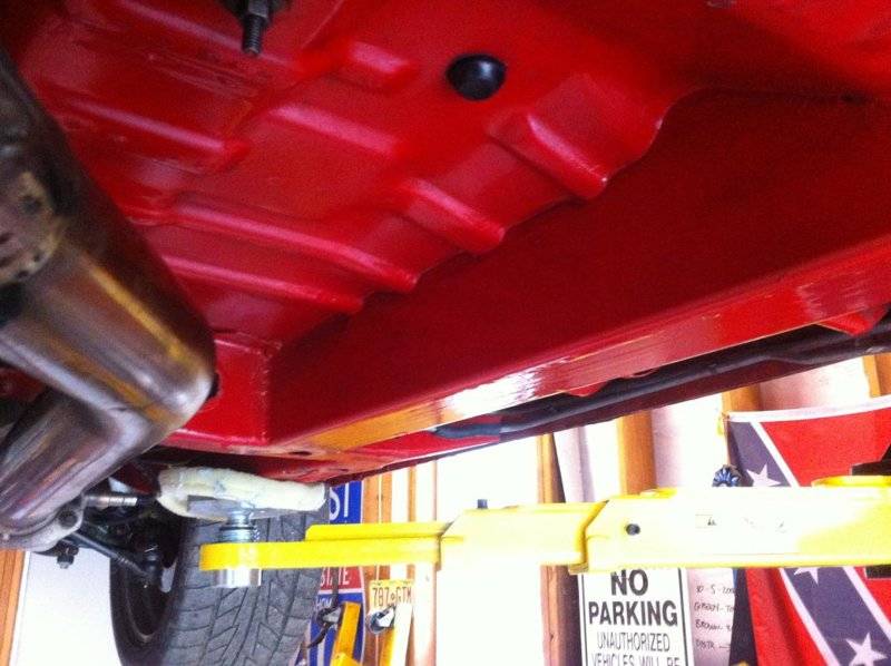

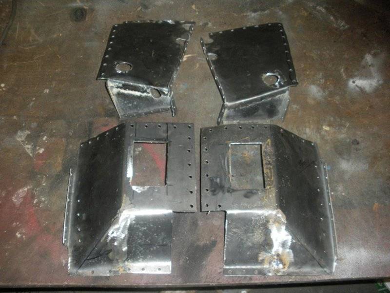

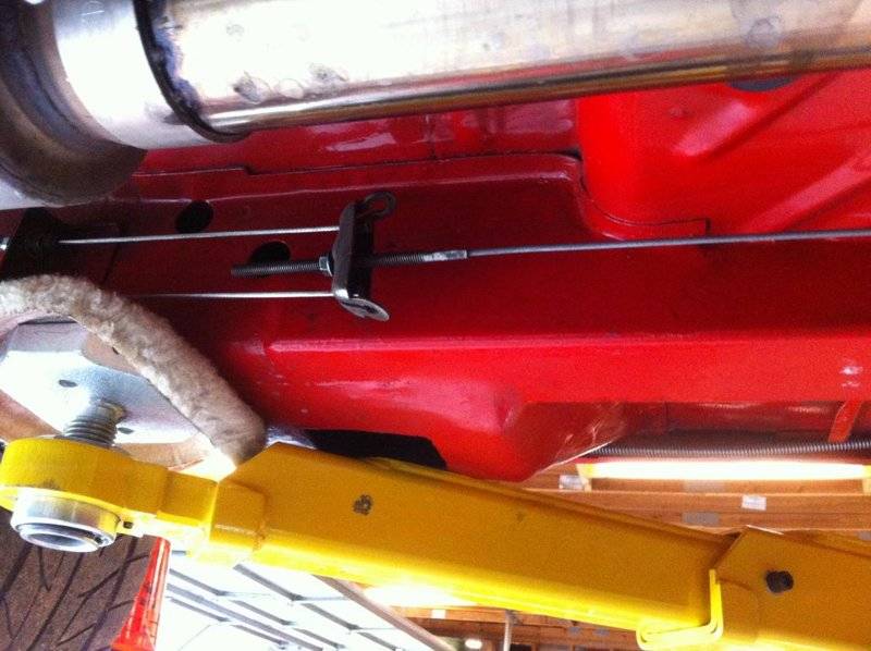

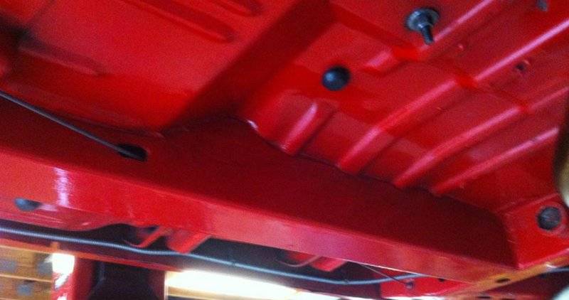

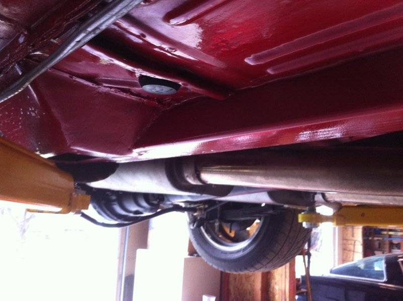

I made mine, or more accurately, I modified 3x3" tubing. I cut it to fit the floor, wrapped it around the rear frame rails.

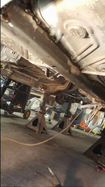

I also made my own torque boxes and welded it all in with the car on jackstands to maintain body weight on the tires. I primed and painted it all to look as clean as I could make it.

Kern Dog's got skills!! Looks awesome

I seam sealed, primed and painted. I probably should have drilled a few holes in there just to let any water escape. I may go back and do that.
