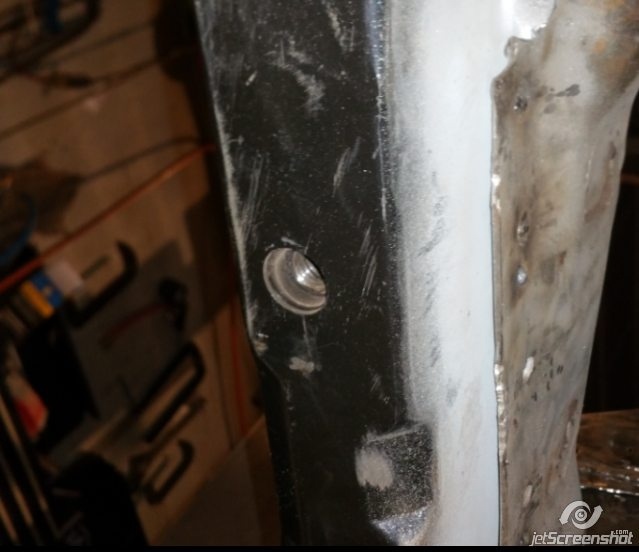

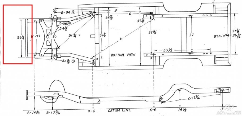

my question is this aftermarket frame rail. on my measurement diagram it says the measurement on front should be 36 1/4. please see attached picture. my measurement is 36 3/4
this is because the aftermarket frame rail kframe bolts are not where they should be.
take a look at bolt picture for kframe mount its not centered like original, throwing off the 36 1/4
should i worry about this?
the car is nice and level with rail in proper position. i matched the height to the original driver rail. just the width in front im not sure how to handle.

if the bolt holes on the k are off
that is not good.
how are you going to bolt it back on?

No what I'm saying is the k frame lines up but the front will be half inch wider like the part where put a square on in the picture. Where the bumper attaches to etc

can you pull it together any?
i would see if a bumper would line up before gluing it in.
ya i guess i will test mount the bumper and suchn before i do final welds as i dont want to break it apart again
i wasnt sure how much room there would be to adjust the bumper if i need to. im guessing i could use some shims or something when lining up everything.
