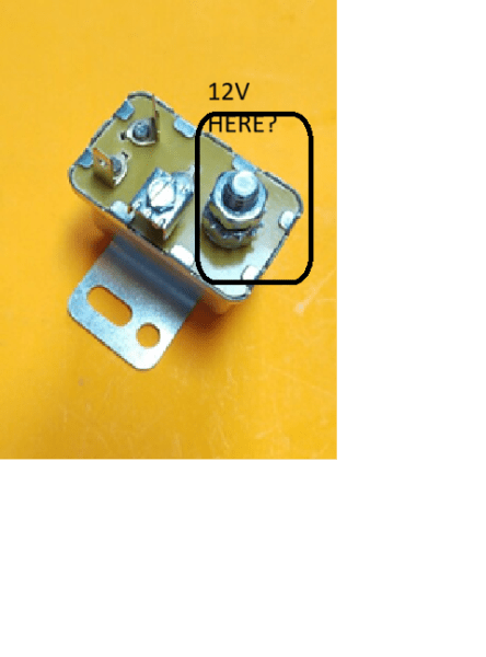

The starter solenoid on the starter itself is essentially a lever that pushes the starter pinion gear into contact with the flywheel. The solenoid can fail.
I've had starters that will push out the pinion and not spin it, I've had them spin the pinion without it being pushed out too. An old trick is to tap the starter with a hammer, this may encourage the lever to move and engage the pinion. I'm surely using generic terminology here as I don't know the correct factory terms.
Do you even hear any sort of CLICK when you turn the key? I don't recall if the car is a manual or 727 but if manual, can you push and rock the car back and forth in gear a bit?
Recently a FBBO friend had a loose connection at his starter relay and the starter randomly engaged the flywheel while the engine was already running and it stayed engaged until he pulled over to pull the negative cable. I met up with him roadside and we changed the starter relay, all was well afterwards.
You did mention no dash lights but I don't understand. Do you mean that the instrument panel does not light up? No headlights, dome light, brake lights either?
I hope it's that simple for you as well.
