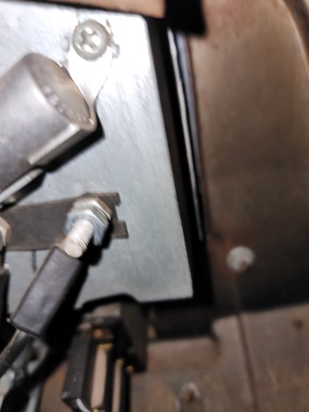

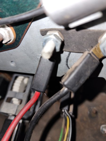

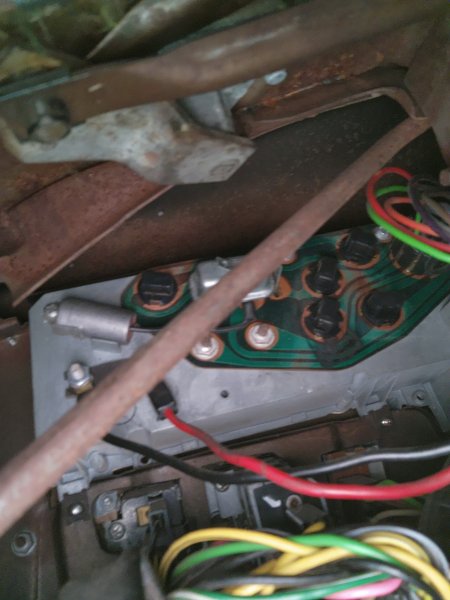

To top things off, my wife has already volunteered to get under the dash tomorrow and check out
the gauge (I don't "fit" under there anymore - part of being 2 1/2 years past my warranty).
Already decided we're going to do the "move one wire over to the other terminal and nail them together"
technique - I'll worry about a replacement gauge some other day.

Regardless, the wife and I carried on the plan. I dutifully removed the bucket seat and she got up under the dash,
following my instructions on what she was looking for (back of ammeter) and then dutifully taking some pics
of same to confirm - yep, she had found it, it was clear to see (and lay hands on) and she set about checking for
issues.
I looked at the pics she was taking and I saw pretty much the same situation as when I had taken the instrument
cluster out some years ago - namely, a near-spotless gauge and perfect-looking posts and wires.
I asked her to carefully take a socket and snug the connections if needed - and she said the black wire took just
a little bit; the red one was still as tight as when I had reassembled it years ago.
When she asked me if we were still going to bypass it, I said "hell no, looks fine".
