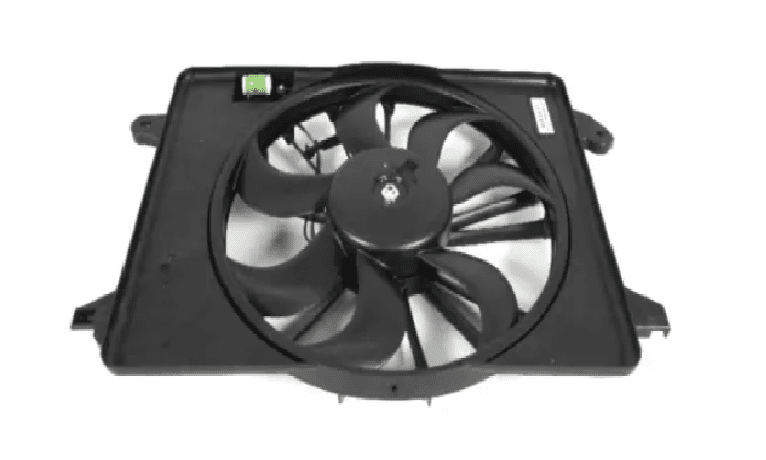

Sorry, missed the part about it being an assembly... been busy this morning LOL. You might be able too mount the above unit, modify , if you will, the above control to your existing fan assembly....

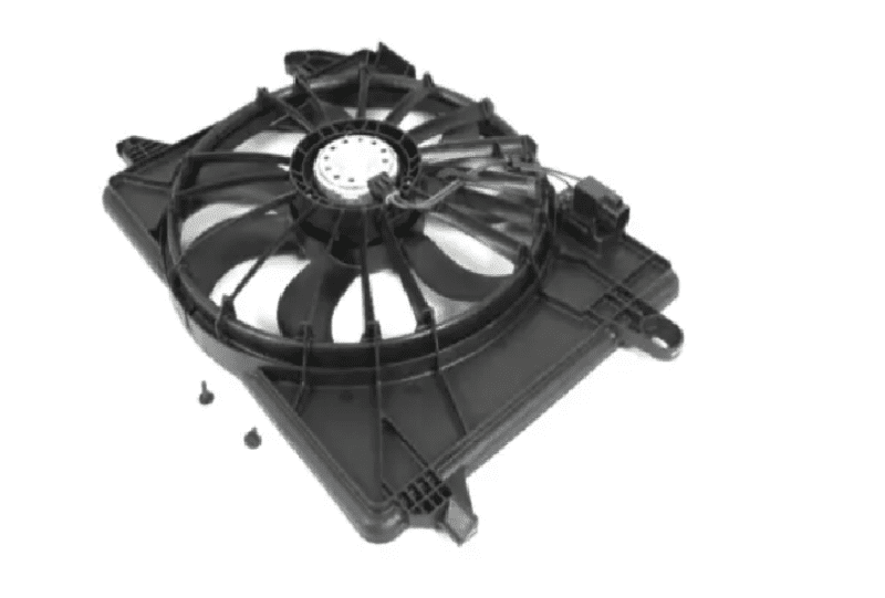

Ed, I would grab one from a yard .View attachment 1638449

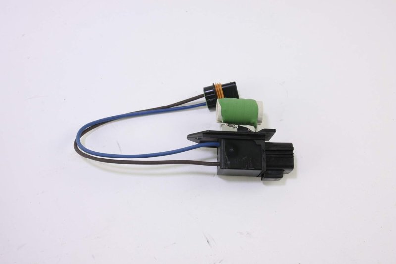

Oh dear....upon further review, it does appear there's some manner of sensor in the fan shroud itself.
APOLOGIES to anyone who suggested this might be the issue....
See that little green jobber there? That's it, on the back side of where the wiring harness plugs into
the fan shroud.
Further....it appears it's not available separately from Mopar or anyone else - gotta buy the whole damn
fan/shroud assembly to get it.
Ma is looking like an asshole here on this one...![]()
Upon further review, you're correct sir!I have a feeling the one I posted ,is the same unit you require. Should be a generic piece across the product line.

It was a cheap fix though.They got a funny name for it - Mopar calls it the "fan motor wiring harness" - but all the aftermarket makers refer to itFan controller? Good you got it diagnosed.
