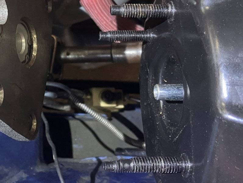

They are below the MC almost to the proportioning valve. Here you can see how far out the pushrod nub was on the first booster.

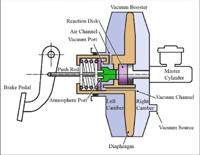

I had never heard of a reaction pad, so I did some reading. In many forums, drivers talk about modifying their reaction pads for improved brake pedal feel and modulation. Might be just what I'm looking for? Here's a good diagram. I know that the Bendix from Dr Diff is mirroring what was offered stock, but nothing on my car is stock. I'm going for as much improvement in steering and braking as possible. I'm curious to mess with this if possible.

I am not sure if replacing the reaction pad with say a solid chunk of plastic would gain you anything substantial in the way of braking power - unless the reaction pad is damaged by say oil contamination.
On a street car - an old boss told me the reaction pad is also there to allow a little bit "give" on initial brake apply. If you take it out the brakes may become to harsh as they apply or light switch like either ON or OFF.

The brakes felt normal to me before. There was a small amount of free play before the braked grabbed, an amount similar to the other two B body cars here at the house. The owner was used to his late model car where the pedal feel has evolved over 55 years. Driving an old car often means accepting some of the differences that will exist between them. I extended the length of the pushrod to shorten the free play and in doing so, the brakes feel as if they go from off to ON in a shorter stroke. They don't feel like they are grabbing in a linear fashion but more like a switch. To me, this is not comfortable or confidence inspiring.
I haven't driven it since you lengthened the rod position, but we'll just need to shorten it back up a little and drive it again. We should be shooting for a .020" gap.

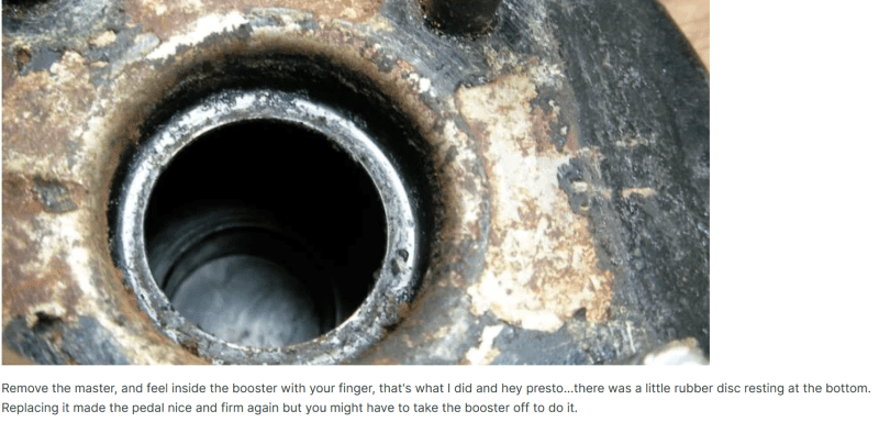

Out of curiosity - I'd like to check just inside the booster opening to see if the reaction pad is there. Here's an example photo from another thread with their comment.
If the black rubber reaction disc is not visible, others have stated that 9 times out of 10, it fell inside the booster when removing the MC and pushrod...shake the booster and it may be rattling around inside. But my guess in this case is that the reaction disc is still there and the pushrod just needs more adjusting. The firewall side of the pushrod pushes directly against the rubber reaction disc inside the booster.
