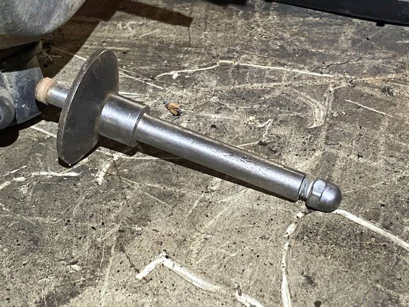

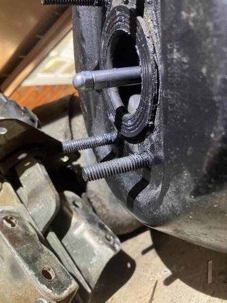

I pulled the MC forward and tried backing out the nub on the pushrod.
The threaded nub they use on these aftermarket units is shorter than the stock ones I have here.
Look at this size difference.
Now this wouldn’t matter much if the pedal free play were minimal but it isn’t with this car. Backing out the screw/nub extends the pushrod length and shortens the travel needed by the pedal. This short of a nub really limits the amount it can be adjusted.
Here are a few of my stock ones.
These all vary in length, leading me to think that they are adjustable for a reason. They are probably adjusted to meet an acceptable standard.

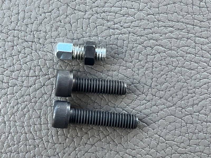

Ace hardware had some Allen head cap screws that matched what I needed.
The pushrod that stays in the booster is threaded deep enough.

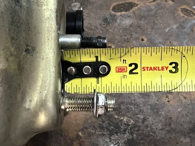

I measured the old booster to see how far the nub sticks past the mounting face.
Now I’m aware that a tape measure is somewhat crude compared to a real tool that would measure to the thousandths of an inch but I thought it would give a ballpark idea.
It was too far out. The master cylinder wouldn’t seat without pressing the piston. As it turns out, I forgot that I took the threaded nub out of the gold booster and just screwed it back in enough to stay in place. I now had no reference point and had to trial fit and adjust the nub until the master cylinder would seat.

Stock:
The aftermarket nub:
This is the nub from the first booster that was in the car when it got here:
Not really rounded despite the recess in these master cylinders having a sort of female dome.
The ACE cap screws:
The ACE screws have a flat face but a rounded edge. It seems to me that since the car had the blunt nub with the gold booster for numerous miles, the ACE screw wouldn’t pose a problem. It could be argued that the ACE nub makes more contact than the tiny edge of the newer booster nub.
