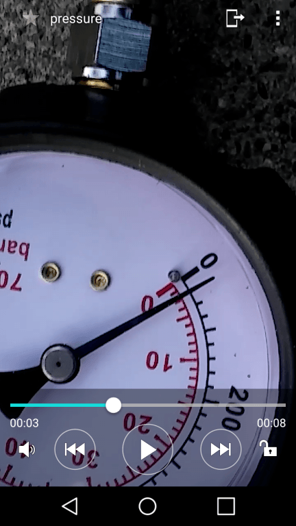

Doug here is Govenor pressure in low. Pretty much same in all forward gears. With brake on. No movement.
Your gauge looks to me to be about 2 psi anything over 1.5 could be signs of bleed back . Though your right on the border line. Reverse functions so the rear band which controls manual apply low as well is not the issue. I'm assuming this VB still has kickdown linkage. Is it all the way forward at idle or is the lever floating rearward? Try tieing it all the forward and see if that makes a change. If all looks good I'd be looking for a VB issue, sticking shift valve, incorrect assy.
