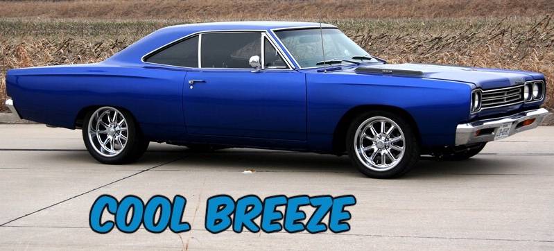

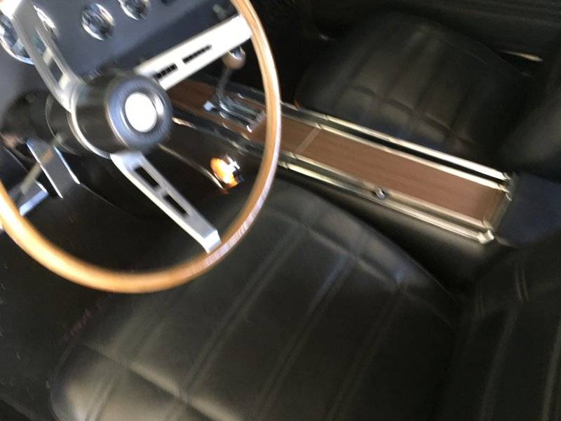

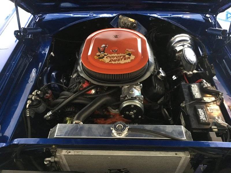

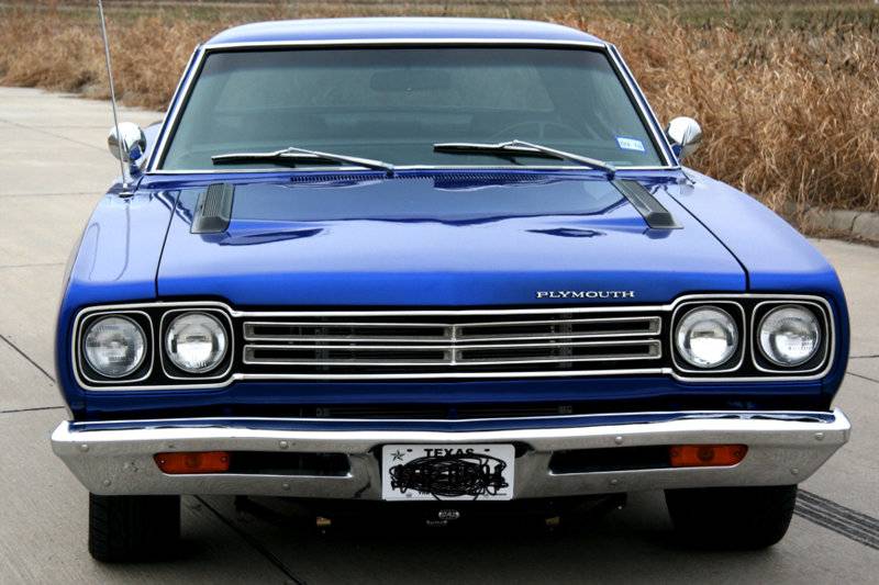

Just completed the car. Basically everything was touch and or modified. The whole drive train was updated and it has modern suspension.
Side lights shaved
bumbers straightened and show chrome
New grille and headlight bezels
New head lights
New parking lights
Taillight bezels replaced
New 2 /12 exhaust and mufflers
New staggered us mag wheels
New nitto summer tires
New qa1 adjustable shocks
New qa1 tubular k member
New qa1 lower control arms
New complete hotckis protouring suspension
New smoked glass on entire car
New exterior door handles and locks
New trunk lock
New hood louvers
Custom show quality paint job PPG viper race blue
New drive shaft
New dana 40 rear end with 351 gears
New overdrive 4 speed automatic transmission

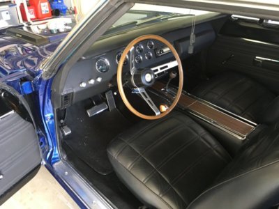

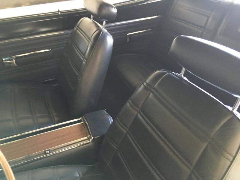

New legendary complete interior with leather front buckets
Rebuilt front and back seat
New interior door handles and window cranks
New armrests
New center console and floor shifter

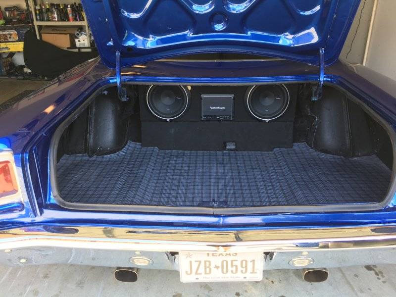

Custom $3000 stereo with 4 speakers and two subwoofers w/ amplifiers
New custom plush carpet

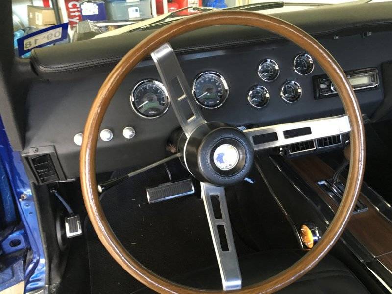

NOS factory steering wheel
Custom leather dash
Custom ultra vinyl head liner
Redone and polished exterior stainless
New pedal pads with chrome bezels
New 4 core radiator with dual electric fans
refurbished gas tank
New Holley 650 carburetor
New electronic msd ignition
New windshield wiper motor
New master cylinder
Rebuilt feel firm steering box
New msg mini starter
New battery
New spark plug wires

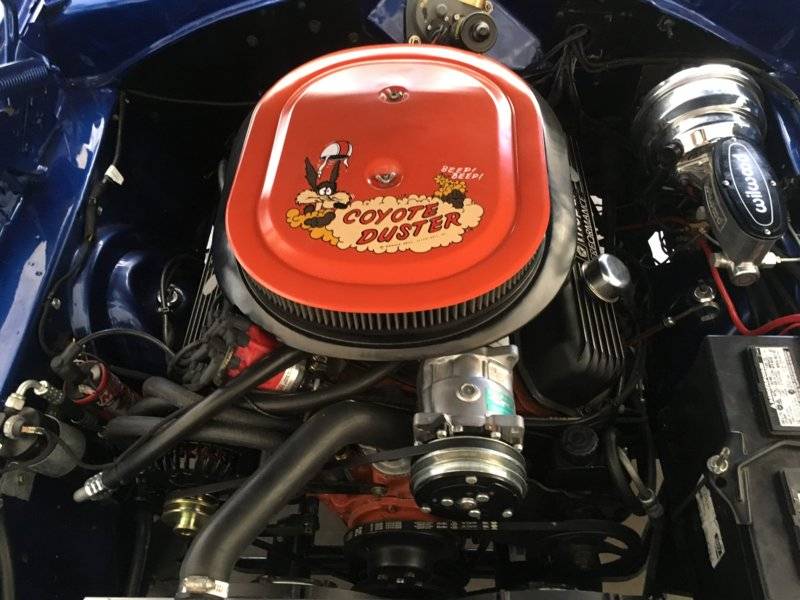

Rebuilt 30 over and race cam 383 big block with new high temperature paint
New spark plugs
New distributor
New complete wiring painless harness and fuse box
New Dakota digital gauges
refurbished roadrunner hood
New roadrunner badging and decals
New windshield wipers
4 wheel big disc brakes slotted and drilled
Vintage air air conditioning

Nice! Don't want to swap the steering wheel for one with less dish?

I like everything but the dash. I like the original dash.

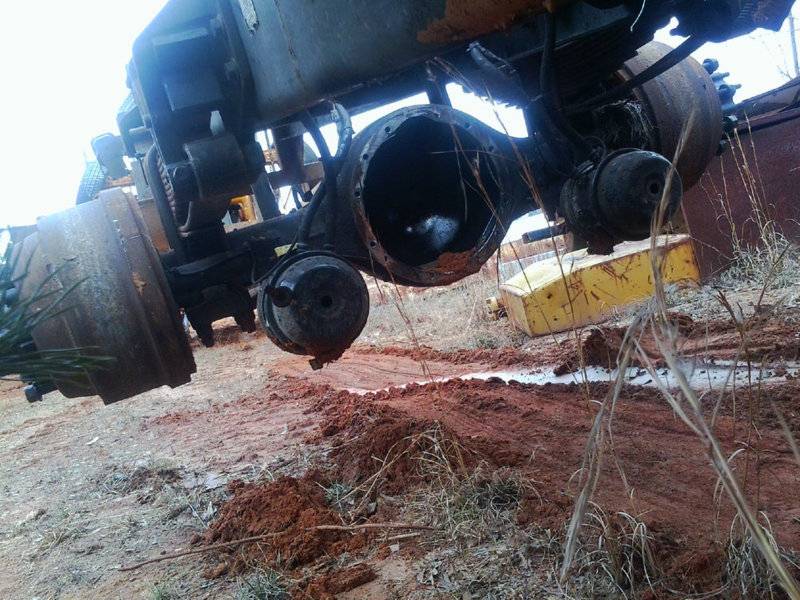

Has anyone else ever heard of a Dana 40?
I have not.
I've heard of a 35, a 53 and of course the 60 and 70.
I'd like to see what that looks like. I'm just used to seeing either an 8 3/4" or a Dana 60 in B body cars.
Sweet car. Like most of what you did, love the color.
@Sudzintx Welcome to FBBO from warm & sunny NorCal Sierras
yes there is such a thing as a Dana-40
not usually refered to as a Dana-40,
more a Spicer Tandem/Spicer Pro-40
started in about 2011 for a lighter version of the commercial axles
now known as Spicer Pro-40
there's a lot of so called experts, self proclaimed "knowitalls"
that never heard of them :blah:
it is generally a full floating axle/housing &
IIRC it is a pumpkin style drop out/in chunk/plug carrier
generally used in heavy IIRC usually over 2 ton applications
or medium duty commercial applications, dual rim/tire
or gear reduced &/or tandem dual drive style axles
where both/dual/tandem axles drive, like a big rig
go to Dana Spicer Corp. web site
educate yourself
BUT;
they are pretty freaken' big/they are heavy duty,
I've never seen one in a car
I'd like to see a photo of it installed in a B-body
if possible, just out of curiosity
it'd have to be or the car would have to be
highly modified to make work or fit
there's a lot of people that call Dana-44's
a Dana-40 series & they're wrong,
totally different style & size carrier
