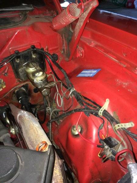

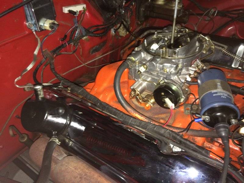

if you’re looking to keep your car looking original and dont want to use wire loom which I think doesnt look good to cover wire use friction tape. Just used two rolls of it i got from lowes. Looks great. Covered up all the add on wires to make it look factory and added a 2 pin pig tail to my pusher fan. The same looking plug that a electronic ignition Distributor has. Just figured I’d share.
https://m.lowes.com/pd/Utilitech-30-ft-Electrical-Tape/3659406
I've been using Tesa tape, wonder how that compares to the Lowes stuff ... might have to check it out !
I wonder what the heat rating is for this tape. Being electrical id think it be high.
When I rehabbed my forward harness(factory original) there was a wrap of non-adhesive vinyl under the friction tape...extra layer of protection
