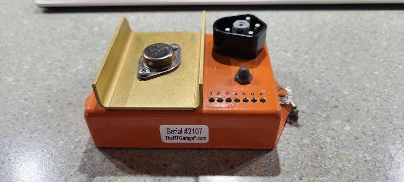

Hey guys me again. Stil having issues with break Uber heavy load so trying to eliminate some stuff and was going to replace the rev n nator box with a stock orange box. On the rev box there’s an Aux Tach wire off the back. Where or what do I do with that as there’s nothing on the stock box. Not sure where to run it. Or if I need to.

So the car is breaking up under hard load around 4500. I spoke with Troy about the rev n nator as a possible cause and to eliminate it I was going to plug in a stock new orange box and see what happens. And I’m a novice especially when it comes to wiring so I want to be sure I hook my tach up right. Normally tach signal wire I thought went to negative post on the coil. But with rev box it has its own tach wire. Or auxiliary wire as it’s labeled.

When did you get the Rev-N-nator? I got the first batch they made ( number 00020 ) and the wiring coming out from back was for ground, not for tach. Althought I have known they made a new version later, but dunno the differences.
on my car I have an Autometer small tach and works fine being connected as factory made, to the - lead of coil using the Rev-N-nator.

Mine was #2107
Same as mine. In its defense. I just swapped it out for a stock orange box and although it seems better. I’m not convinced it’s cured. Still a little break up about 4500. Was hoping this was the fix…
