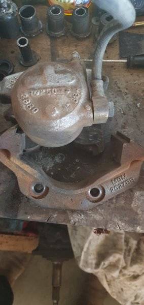

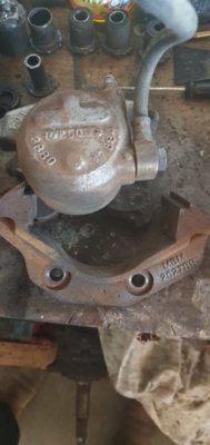

Hi,
Does anyone know where to get a rebuildkit and pads for these chrysler discbrakes?
They are under my 68 charger.
Numbers are.
3880
Mbm 2627br
Thanks!
J.D.
Here a picture
Those look like 73-76 A body. Do you know what they came from originally?
I'm not sure where in the Netherlands. I think there are suppliers of parts for American cars in Germany. Google can be a help.
Rock auto also does international shipping.

We do offer caliper rebuild kits as well as brake pads. This is something that we do not normally list on our website, but if you can pm your details and an email address I can work with you to get you pricing and shipping.

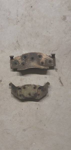

I need to see the brake pad -- to see whether it is a pin type brake pad, or a slider brake pad...
Single piston caliper kits --- from a disc brake conversions -- that I S what that car has -- are just
$ 5.00 each....
I dont know from wich car or year the brakes are.
Here somen pics of the pads.
6.2 inch and 5.1 inch

Jddodge,
That picture is more than enough... Those are the slider calipers.....
Yours, Craig....
Give me your address, and I will give you shipping charge and total.....
