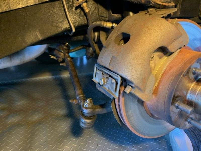

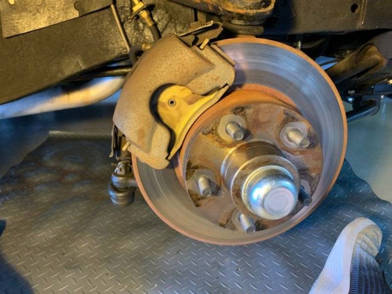

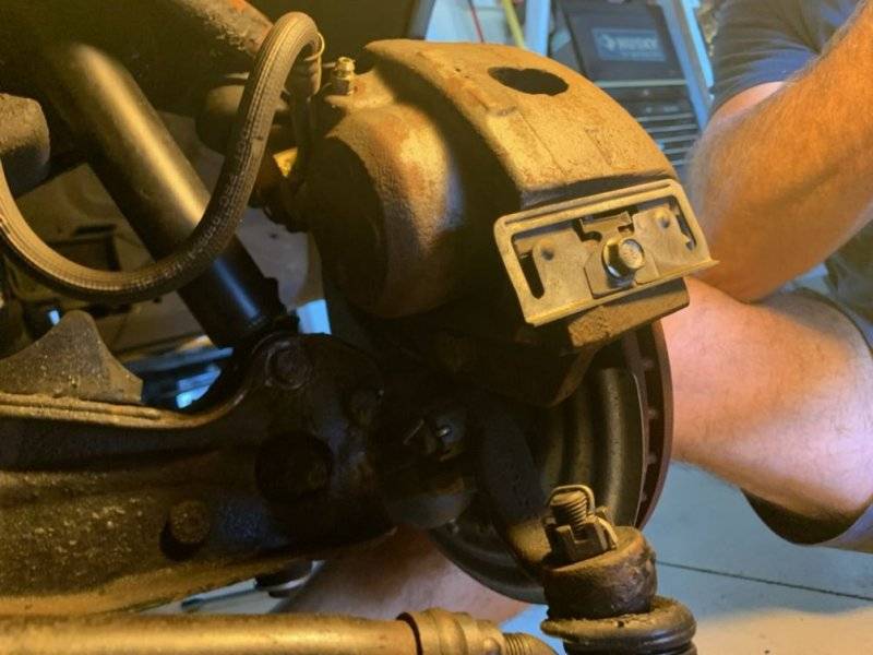

Ok, here are the pics of the passenger side. The pads anbd rotor actually look s good so I don't think they need ot be changed. I'll check the back drums now. Brake pedal is just spongy. Will also check to see if they need bleeding.
So those appear to be 73-76 single piston calipers, likely from an A body or F-M-J, all were similar-ish. Original 66-69 B body was fixed 4 piston calipers. Anyway, pads should be readily available. Always good to have spares on the shelf.
