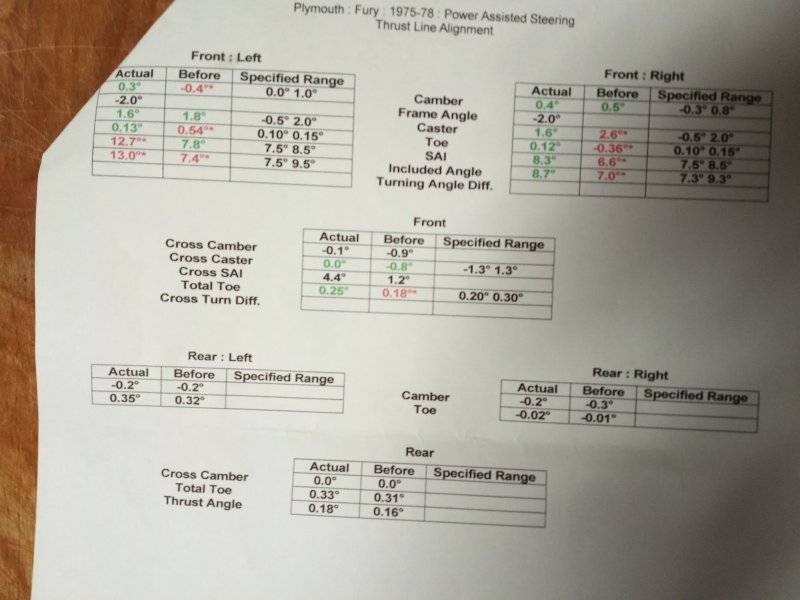

I know nothing about alignments But I just had an alignment done at a shop and the Rt. Front still has some red items in it in fact one went from green to red? What would cause this. Twice its been done and some red was left on the left side.. the first time the guy did say looks like the spindle is bent? would that cause those numbers..

Steering axis inclination and included angle are not adjustable. I don’t understand why they would have changed. Usually a bent part such as a spindle, bent ball joint stud. Did they check the suspension parts?
That makes no sense. Your initial readings were not that far out so the correction adjustments were minimal. To see that much of a difference your initial would have to be way out. For what it shows the adjustments to not warrant that much of a change. If the car handles properly I would not worry about it. If unsure get it rechecked. Most all the time bent parts will not allow the alignment to get into specs.
Looks ok to me. I only worry about camber, caster, toe, and total toe. Almost looks like a bias ply alignment. On radials & PS I have them shoot for as much caster as possible first then dial in the camber. Each side is a little different for road crown. Should be no drama with toe and getting the steering wheel straight. You usually don’t get every single spec green on modern machines with old cars. As @pnora says, if it goes down the road straight and steering wheel is straight then it’s good.

Lowering the car will change the alignment. How much is a guess. The alignment should be done with all components in good condition and at the desired ride height. Myself to fully answer your initial concerns when you made this post along with the front being to high now is this. Set the ride height and get the alignment redone.
