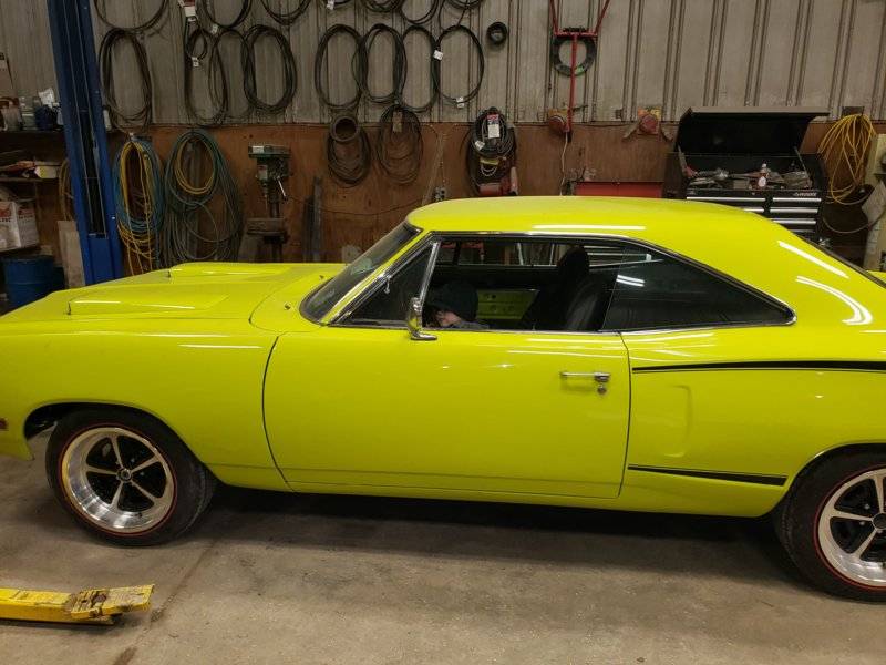

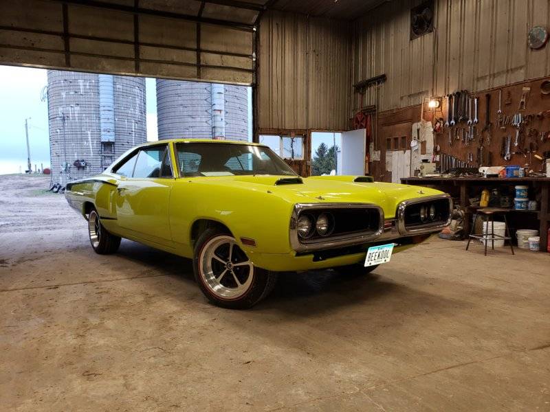

Yes. I moved her back and forth a few times. These pictures were taken a few weeks ago. The car is now in its hibernation building located just behind the silos in the top picture.B did you roll the car back and forth after adjusting? The car will drop some after doing that. I use 2 pieces of 16 ga steel about 12" square with grease between them. This lets the wheels slide out to there natural position after bouncing the frontend a few times.
The cars a 500 . Im fairly certain it has the original suspension. If thats any help.What torsion bars do you have?
