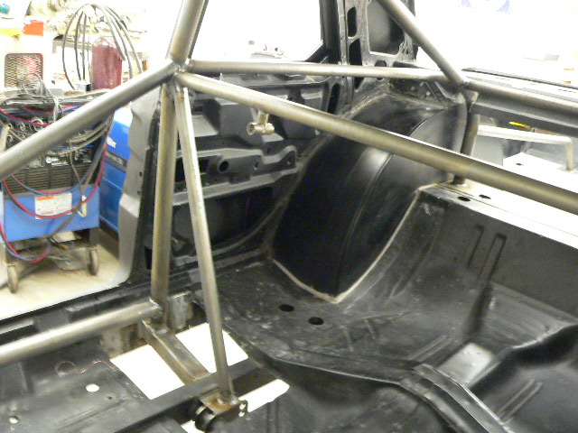

Cal Tracks like a loose lightly sprung front end with as much travel as possible. If your going to street drive it run the Cal Tracks. Ladder Bars are not street friendly as they provide no axle rotation. Over all the ladder bars are simpler to tune, weigh less and the components are less costly. A low 11sec street strip car will work fine without requiring either.. We've actually run pretty decent 10.60 on drag radial with stock leaf springs. Depending on the intended use you may like to use the light torsion bars. If your tight for cash put some home made sub frame connectors, Do yourself a favor and install a couple of outriggers between the connector tubing and the rockers in case you want to add a roll bar later.
Doug

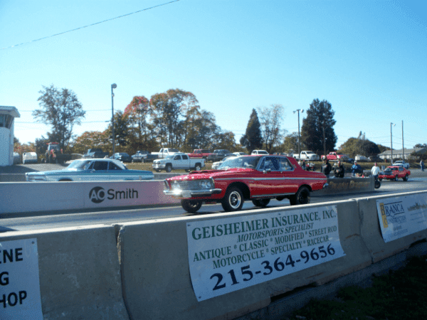

Dont know how fast you want to go but all I use is basically stock suspension with the 3400 lb Superstock rear springs. I did put Comp 90/10 shocks up front. I just use the stock torsion bars that were put in the car at the factory. It was an original 383 car and it works pretty good for what it is with the stock torsion bars. Nothing trick at all as my 63 is a street car that actually weighs just over 3700 lbs with my 180 in it and I drive it alot on the street and even drive to the track when I go. So far it runs 10.70's with a 1.50 best 60 and it drives great on the street. My budget is very tight so I had to make the best with what I could. Ron

Thank you for the kind words. Do you have any pics of your car as I love pics of cool Mopars ? And good luck with it. Ron
