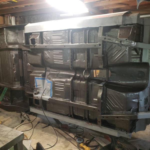

I was not sure which way to go on the frame connectors either, as I was not a very good welder when I started this project . . . but after my research on the topic, I came to the realization that if they are not welded into the car, building a "torque box", then you're sacrificing the strength and gain that they are being installed to address . . .
I've got just about every option for frame stiffening in my car, all purchased for US CarTools - they have been amazing to work with and have provided me with outstanding customer support. They also redesigned and re-cut new parts for me because my measurements showed the holes in the parts off by 3/8" . . . they custom made new parts for me to match my measurements.
Not only that, really like the end results . . .
