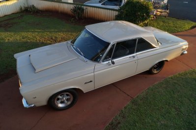

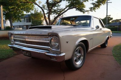

Torque thrust 15x6 with 225/78 15's. Didn't want to send tire with 5,000 miles to the j-yard. Ol'school. Ignore the unwanted guest.

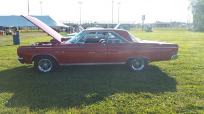

I am currently running MT Sportsman SR LT 26 x 6R15 on 15 x 5 x 2 3/4" backspace Chrysler Police wheels. 20140906_191520 (1).jpg

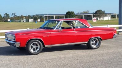

Hello,Here my coronet with 225-70-15 Mickey Thompson sportmans fronts, 275-60-15 Mickey Thompson ET Steet rear

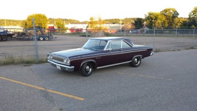

Went with
15X7 American Racing Torq Thurst D2 (VN215) and 235/70/15
