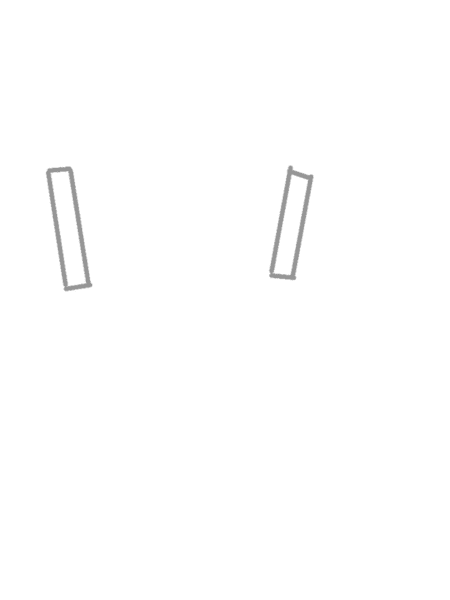

I may be using the wrong term. Not toe in or toe out. The bottoms of the tires point in so camber?

If the tops of the tires lean outward vs the bottom....then you have positive camber. I like a good deal of negative myself but the book calls for nearly 0. Of course, the specs are for bias ply tires.
If you're looking at the car from the front the tires point like this. Maybe not this extreme but a couple inches....enough to notice.

If your tires are 'looking at each other' that much when looking at them from the front, it's way too much toe in.....

It's not toeing in or out. That crappy drawling is suppose to be looking at it if you were sitting in front of the car. It's positive camber, I used the wrong term earlier. It's only positive camber after long suspension travel and than it evens itself out after driving down the road about mile down the road.
If you jack up the front of most of these Chryslers, the wheels will hang like in your illustration. You let the jack down, they stay like that until you roll the car a few feet, then they straighten back to normal.
When you're pulling into your driveway, it's almost doing the same thing as when you jack up the car, it unloads the suspension.
It shouldn't take a mile down the road to straighten out, only a few feet. Your upper bushings might be tight, or your shocks are tight for some reason. Normally worn shocks are loose, with no resistance.
