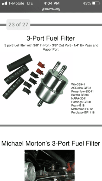

                    Anyone have a part # for the 3 port style orifice and non-orifice in line fuel filters? I can’t seem to find one on summit.

                    I emailed Wix and waiting on a response. I also emailed "Uncle Tony" as per the Youtube video to find out where he got the Wix filter too and waiting on his response as well.

                        WIX 33040

                          I found an old FBBO 2012 thread on this. If you want the filter with the vapor return line coming off at a 90 degree it’s Wix 33054 (5/16”). Not sure for 3/8”. Install between pump and carb with the vapor port facing up is what the thread recommends.
                          My 2 port in line filter is between tank and carter mechanical pump on passenger side and never had a problem. Doesn’t look like much room to install between pump and carb without it living in front of tbt air cleaner...
                          https://www.forbbodiesonly.com/moparforum/threads/what-is-this.39825/
