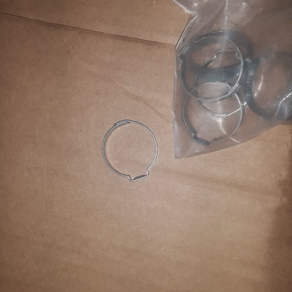

Where can I find a tool to use on this clamp? It is for the fuel fill tube leading to the tank on a Charger. Thanks!
Corbin clamps are used on radiator hoses.Corbin clamp tool - try Amazon.
Different names - Cinch type clamp

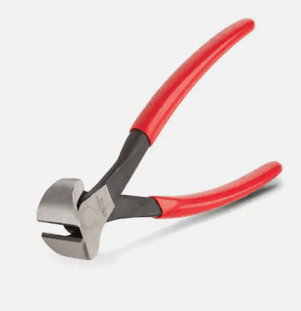

Good removal tool.Simple end nippers also work well.
This just cover the ends with gorilla tape.Simple end nippers also work well.

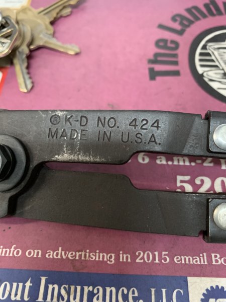

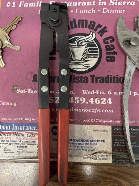

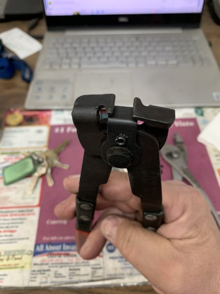

Where did you find the Corbin Clamp pliers?Corbin Clamp pliers
Don't remember anymore. I have had them for 25+ yrs...Where did you find the Corbin Clamp pliers?
Wonder if you had a pair of slip jaw pliers. Then made the jaws so they temporarily wouldn't open and drill a 1/8" (or 3/16") hole in the jaw. You could tack weld jaws shut, then grind weld off.Where did you find the Corbin Clamp pliers?
All the professional tool companies have them. Here's a MAC pair I kept in stock for 28 years.Where did you find the Corbin Clamp pliers?
