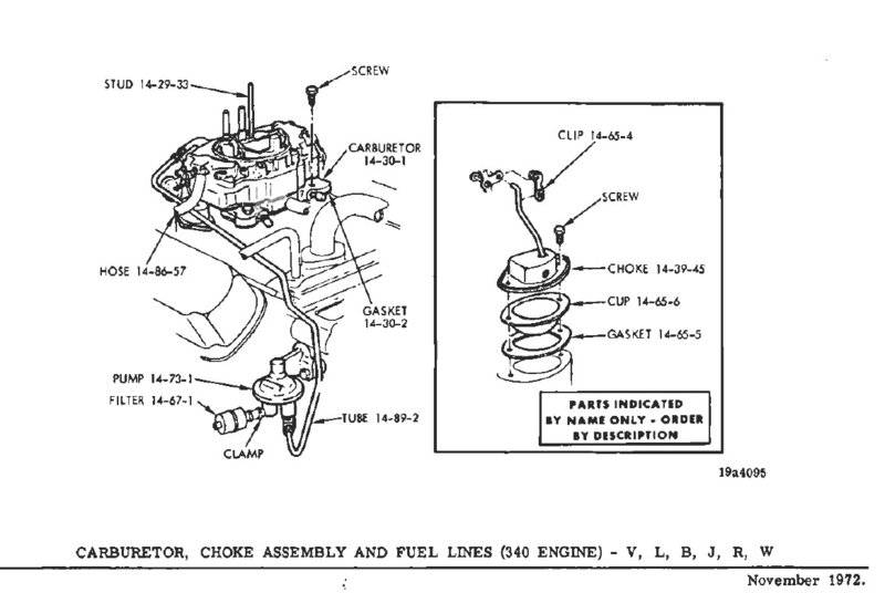

After an exhaustive search I finally found a picture from the 72 Chrysler Parts Catalog that shows the filter before the pump for 340 applications.
I'm shocked to learn of this. Pre-pump filters not only put added stress on the pump they also lower the pressure to the carb.
