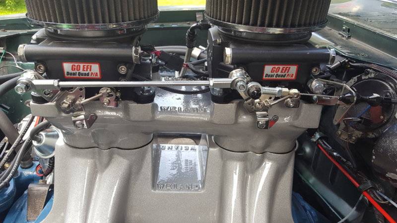

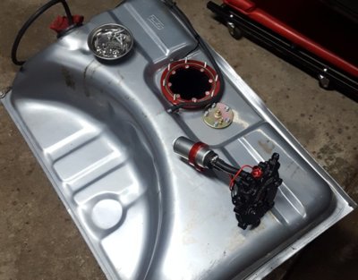

I believe that if I had the choice between MSD Atomic or Holley Sniper, I would chose the Sniper. I installed the FAST EZ EFI on Ram runner. I will post some videos of my install and a start up if your interested.
Tanksinc, FiTech pump and efi, teflon fuel lines.
