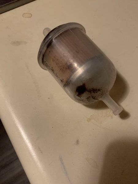

Filter change was one of the first things I did. Gas filter looked awful considering it was a relatively new filter. Cap shouldn't of been off but they took off the bumper and could of loosened it. Never know. Great idea on the coil. I actually do have one off my 73 Charger that I could hook up and try.
That filter does not look good.

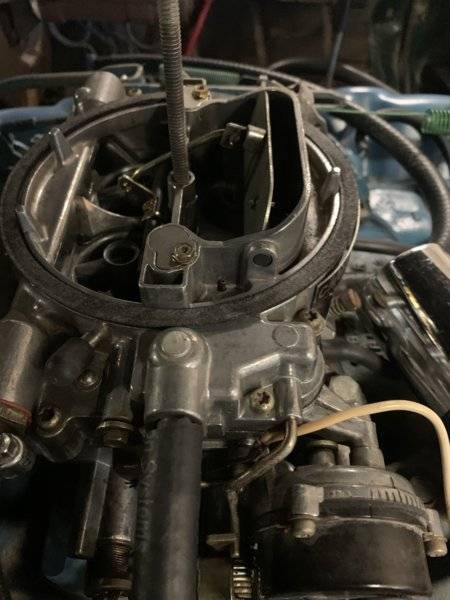

It appears from your pix, the carb looks like an aftermarket Edlebrock (aka "Eddy") rather than the original carb. Since the Edlebrock carb is basically a copy of a Carter AVS carb, it is susceptible to same internal idle and off idle fuel issues. The idle mixture is sourced in the primary booster venturi which has a few very small orifices that COULD be affected by dirty fuel. These fuel metering orifices are NOT the primary jets or metering rods and only be seen by removing the booster venturii from the casting. These small orifices can be cleaned by a good solvent and compressed air. There is also a very fine screen assembly located directly behind the fuel inlet nut, which, when clogged or restricted, will exhibit a fuel starvation issue, which appears to be your problem. Just my opinion of course.
BOB RENTON
The carb is a Carter 9635S, not an eddy. The carb was taken apart and cleaned just to be sure it wasn't the problem. I do have the car running again now. You guys can tell me if this makes sense - I noticed the car was dying right after the throttle fully opened and idle would get really slow. I shot some starter fluid in it and got it running again, then started playing with the idle screw increasing the idle when it seems like the car was stumbling. It kept running! It still needs dialed in but ran for 10 minutes without issues. So why would that idle be so far off all of a sudden? Well when I had the tranny rebuilt I had a new torque converter put in. Wouldn't that change of stall speed cause me to have to adjust idle speed? That's all I can think of. Hoping it keeps running. Thanks for all the input. I'll post some pics soon, right now it's wet sanded awaiting polish.
