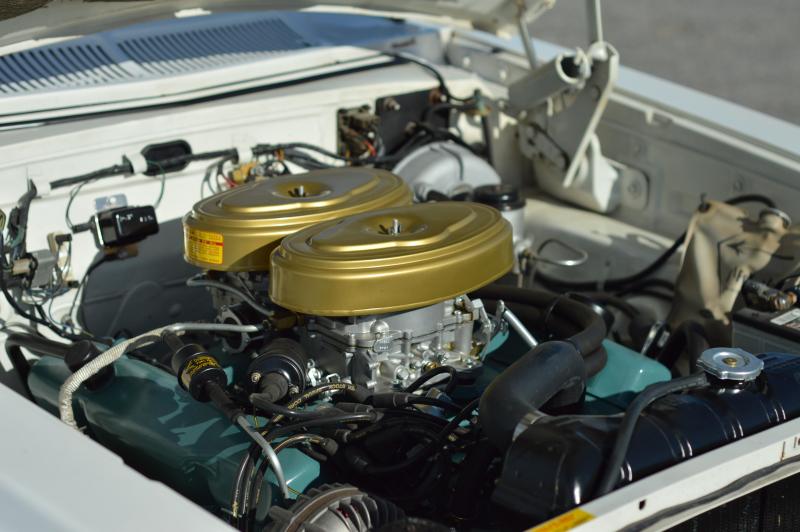

My dual quad 413 always has and continues to run hot in stop start traffic, even when ambient weather is not that warm (like 75 deg F). Ignition timing is correct. I rebuilt the motor a few years ago and also replaced thermostat, water pump, hoses, coolant, and 13 lb rad cap. I had the 22" 3 row radiator apart, it was clean as a whistle. I recently replaced the viscous clutch on the 7 blade fan, and added the factory shroud. This made not a lick of difference. Today I fitted a 160 deg thermostat and drove it around town. I saw on the temp gauge that the engine temp is a little cooler for quite a while as it warms up (like gauge at a 1/3rd scale), but eventually even with just constant cruising at steady speed, the temp still climbs up past half way.
What else can I do to keep this thing cool? Am I just expecting too much of my radiator?
This leads to the second major problem of fuel vaporisation/vapor lock. When it's not too hot, she runs like a swiss watch. As the underhood temp climbs past half way on the gauge, then starts the erratic running, chugging and stalling. I limped home from todays test drive and parked on the drive, temp gauge just past half way with the engine coughing and farting and barely able to run and quickly ripped off the air cleaners. As suspected, the rear (primary) carb was bone dry - nothing from acc pump squirters. The front carb was able to squirt a little, but not much. The carbs were restored when I did the engine and they are still like new. I've checked the fuel pump pushrod and the new fuel pump I fitted a few years ago, they are both fine. All my problems are heat related. Last year I tried covering all the steel lines in rubber insulation - it made no difference. I added extra insulator gaskets under carbs, made no discernible difference either.
Is it likely the fuel is boiling in the lines/fuel pump/fuel filter or in the carbs?
All I have left to try is fitting 1/2" wooden insulator under the carbs.
I'm guessing an electric fuel pump near the tank and a fuel return/reticulation line would be the answer?!
Help?!?!?

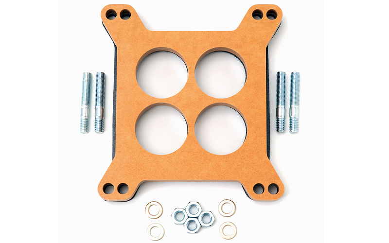

I already fitted these 1/8" insulators -

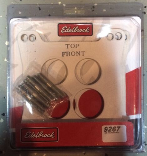

Yes I fitted a fan shroud months ago and fitted new fan clutch too - made bugger all difference. Engine does have exhaust crossover blocked. I bought a pair of these Edelbrock 8723 and will fit next -

The 8723 spacers have all four holes measuring the same as the secondarys. The primarys in the carb and the intake are 1 9/16 (smaller). Does it effect the flow?
I want to use 1" under mine and am thinking about machining the intake primarys to match or making a sleeve for each bore. (origanal 2x4 cast iron intake)

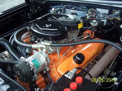

Frank, I think you know what I have,similar other than cubic inch,10.2 comp,same carbs and intake,cam 222/232 at .050,complete 3" Max Wedge exhaust,original 22" three core,180* stat,fan shroud,fixed 7 blade fan and O.E.M. 6 blade A/C water pump and A/C to boot.This thing has never went over 195* under any condition.I'd start with timing and go in order and eliminate all causes of over heating one at a time.
