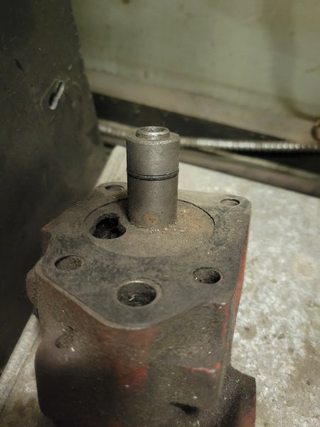

Well dang it I'm back again with another question. Tried to pull the shaft out and can get to wiggle up a little but not release. Does the engine have to be turned to move the cam teeth to release it? I have some long nose vise grips on the rim of the shaft and they keep coming off.
Use a flathead screwdriver, stick it in the slot, and twist. It'll raise up above the cam gear, then use a magnet or needle nose to pull it the rest of the way out.
Be sure the intermediate shaft goes back in with the slot pointed the same direction.
When in doubt, it's customary to do it at TDC and realign as outlined in the FSM.

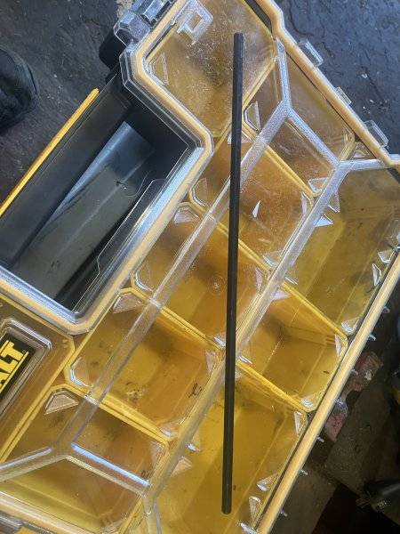

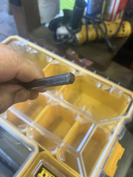

Maybe I missed it but I didn't see it mentioned yet...always give the crankshaft a couple of slow rotations while priming. Otherwise you likely get no oil to the top end.
