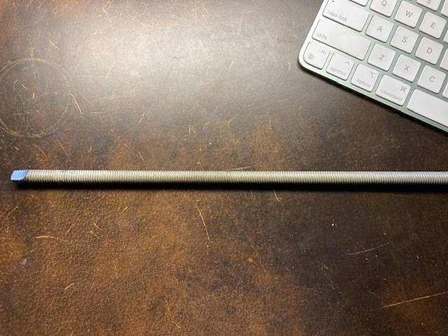

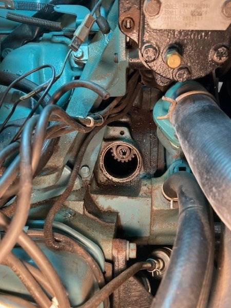

My engine builder does it all by hand and no drill. I tried once and in about 8 turns you could feel the pressure and see the oil. had the valve covers offAppreciate the warning Don. I'll put the screw in handle on the drill for control. Obviously I have never done this before so any warnings/procedural info is much appreciated. I was looking at the engine Yesterday after completing the oil pump replacement and complete brake job. With a/c and a radiator hose further to the left and all the other stuff in the way it's hard to make a mark for reference when replacing the distributer. Believe I may have to move the alternator back out of the way. And maybe more. It is what it is.

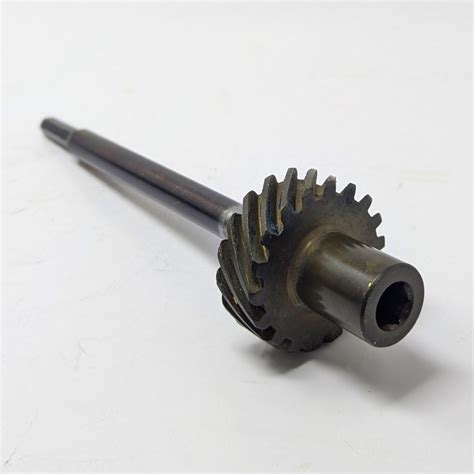

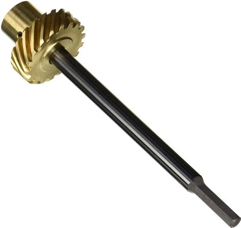

All big blocks have a hex drive in the oil pump

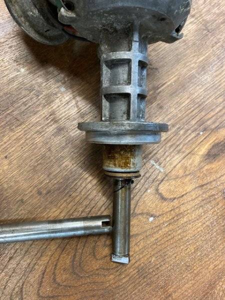

I"m talking about priming the engine, the distributor/oil pump drive gear comes out before priming,are you talking about the same thing ? he's talking about the distributor shaft that hes mimicking with the slot end all-threads.
Maybe it’s just how you write , but it seems like you still don’t understand.Well that explains a lot. And why the tool picture at Summit on line looks round instead of pointed. Without that explanation I would have received the tool and wondered what the heck? And probably the tool I posted next to the distributor is the correct tool. It has a hex on the other end. That one looks like a used distributor shaft but is probably a used drive gear shaft. And I would have tried to turn the shaft and then thought something was locked up because it would not turn. Pictures are worth a thousand words and a thousand thanks for that.
