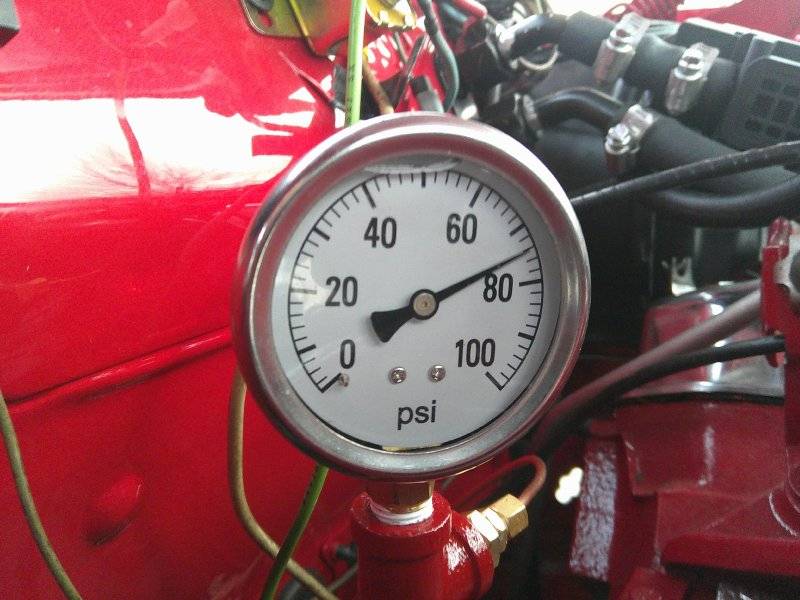

If you don't have a gauge, maybe crack the pressure switch loose a turn and watch for oil leakage, that'd be good enough.

The only times I've ever "primed" a lubrication system on a completely assembled engine, I always use an external (electric, usually) pump and induce the oil into the block via the oil sender hole using a T fitting.

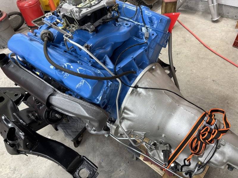

Good to know these methods. I have a rebuilt 413 that I can pre-lube before starting. Trying to imagine what you used for an electric motor pre-lube tool. Is it something you made or is it available on the market somewhere?
I have a fairly high volume $23.00 battery operated pump that I use to empty oil pans and such but it overheats if it sees too much pressure. I just emptied a 275 gallon fuel oil tank with it a couple of weeks ago but I had to stop frequently and let it cool down.
