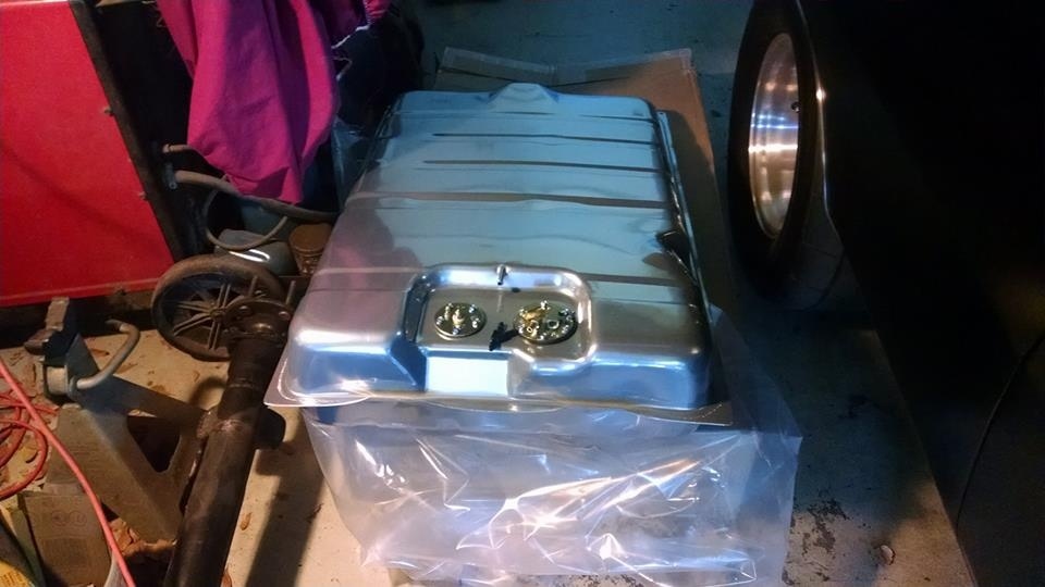

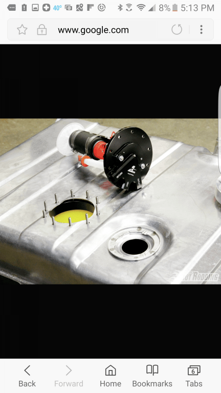

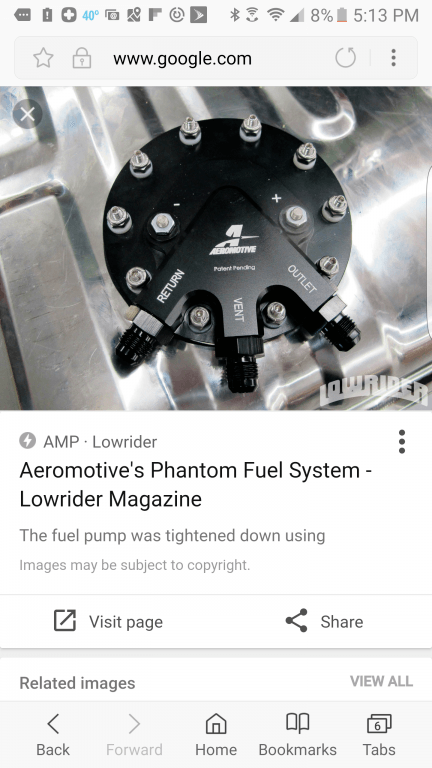

Sorry I didn't catch this reply until now... Your right after posting that I put the Charger up on the lift and thought HOW?? They said it would fit but I'm not seeing it with the tank against the floor. Back to the drawing board. My biggest concern is reliability and if coarse cost, I'm not by any means wealthy and would like to be able to afford to keep a spare in the trunk. An OEM pump out of a newer car would be great seeing how they seam to last 100,000 miles or better. Thinking about frame mounted again.there is not room for that elec pump on a Charger tank!!!
I've got a brand new tank so if I go this route I'll modify it.
