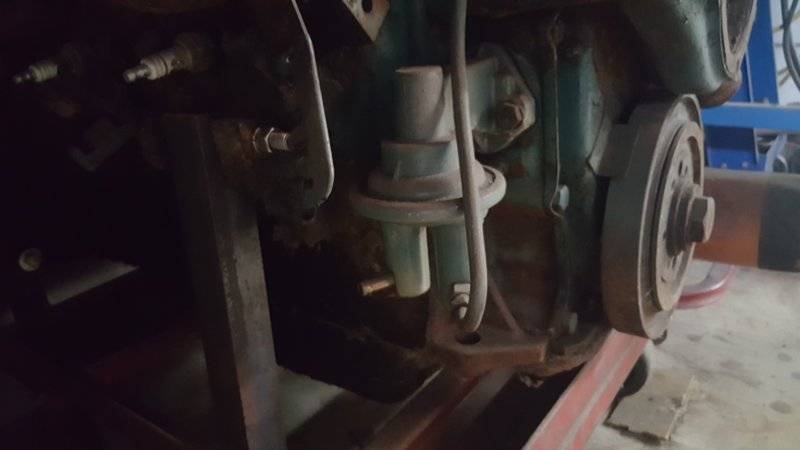

Trying to install hard line from pump to carb, the outlet on my pump is on the front side/inlet toward rear of car. I have looked at previous threads showing outlet toward front of car. (Carter pump). Are some pumps reversed this way? Thanks in advance!
Hope you will still use hose from line to pump.
This is the most dangerous thing you can do! You should use as little rubber hose as possible on a fuel system! Meaning about a couple of inches. Good Luck
Is it a competition series where you can clock the pump (inlet and outlet) it will have about 16 screws that hold the pump halves together.
It was on the car when I got it, can't see a part #, but it looks just like a Carter M-3672s which is what came on them from the factory.
You say pump was on car already and was it plumbed with inlet to the front and outlet to the rear. Did car run like that? Is there an electric pump in the line somewhere? And I believe fittings on pump might be 3/8" not 1/2", not that it matters but just for info.
If the connections are definitely reversed I would just get a new 3672 for under $30 and know that you have it plumbed correctly.
