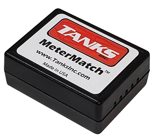

The problem with most of the aftermarket replacement fuel sending units is that
they use the wrong taper rhoestadt that never track the fuel level accurately...
Often never showing full or only 3/4..
Our solution was to install the Meter Match, which can be dialed in without dropping the tank.
Once installed and calibrated the fuel level will be reported properly on the guage...
