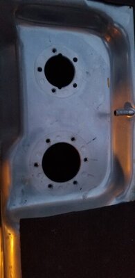

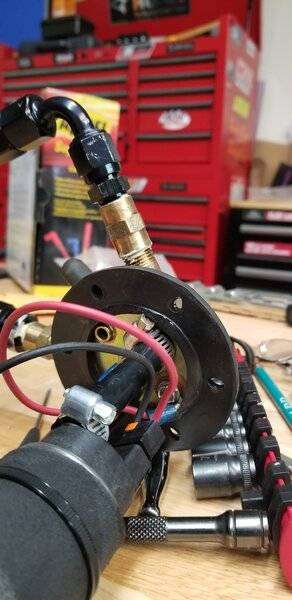

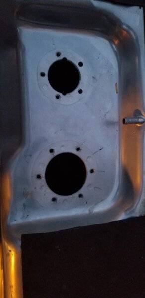

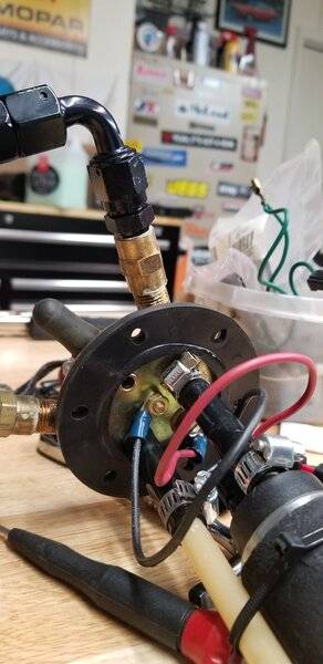

I put a new TanksInc tank in my Charger a few years ago. This tank has an in-tank electric pump so there are two openings at top of tank. I noticed leaks almost immediately. Leaking at fuel sending unit and fuel pump opening. Sending unit and fuel pump installed per TankInc instructions. I used the seals that came with the tank. Well I finally removed the tank to facilitate other maintenance. I removed sending unit and pump. Both gaskets look perfect and tank mount surface looks perfect. I did not use any RTV or other sealer on initial install. My thoughts are to use some black RTV however, this should not be required for a leak free seal. Has anyone run into this problem with this type of seal? If so how did you fix it. Thanks

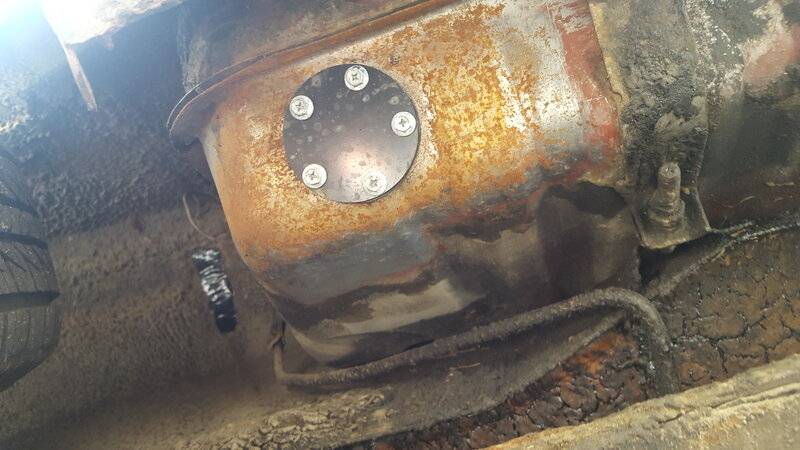

I put their sending unit block off plate with their gasket, neoprene iirc, and bolts with their o-rings at THE BOTTOM of my wagon gas tank to cover a rusted section, small, cut it out, and it doesn't leak and hasn't for years.
My point is, I doubt it's their gasket.
The possibility exists but its remote that the fittings are leaking. When everything was together and I first noticed a leak I went under the car and did a visual. The lines are well above the gaskets and I could see them clearly. I saw no fuel on the fittings. I believe the fuel is coming from the gasket surfaces. Additionally it only leaks when the tank is full or mostly full. Drive the car for a little and get some fuel out and the leaks go away. I drove it like this for a year or so.
Unfortunately with this setup you must use NPT to pump outlet. I had to use a long NPT to AN fitting (4 inch IIRC) for clearance issues. However the lines are all supported and minimal weight is on the fitting itself.
