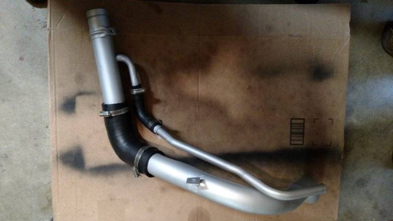

I got mine from Year One
View attachment 749191 I got mine from Year One

It was pretty straight forward although I did have one problem that we attribute to our own failure
The seal at the tank leaked. Now we used the updated double seal but we originally installed it backwards
and had to pull everything apart and turn it around. We believe we damged the seal during that process
So when we placed the new seal we used petroleum jelly on the inside to lubricate as the filler tube went in
This solved all of the problems, in fact when I had the new exhaust put on the car last week I checked it
It looked wet and I stuck my finger to it. It was the petroleum jelly on the outside of the seal and not gas
Should have wiped it off better
Hmmm.... Dang thing is that i did have the upgraded seal on it, but it was still leaking like a sieve.
Not sure what to tell you there. I had no issues that weren't of my own making
