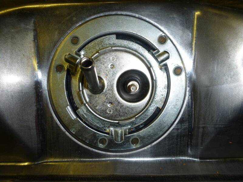

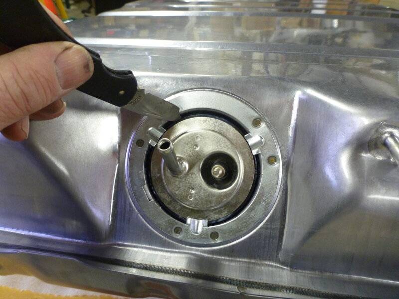

Somehow the top of the gasket surface got pushed in a bit on this 'new' tank and was installed in the car like that and the guy has been dealing with it leaking at the top of the gasket. I was able to use a pair of channel locks to bring it back out and it looks and feels pretty good but I don't trust it and thought about using some sealer on the new gasket. If that's ok, what would be good?
As I recollect from past threads most problems sealing were due to the new and thinner lock rings and nobody recommend using RTV. Maybe there is a fuel resistant sealer I'm not aware of.

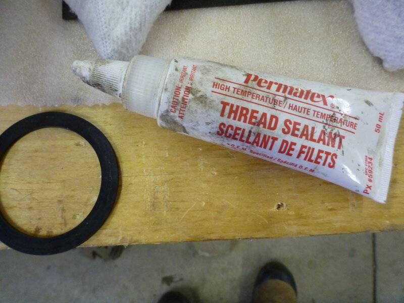

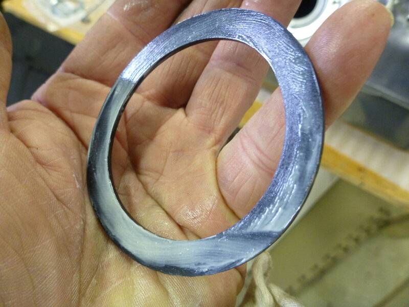

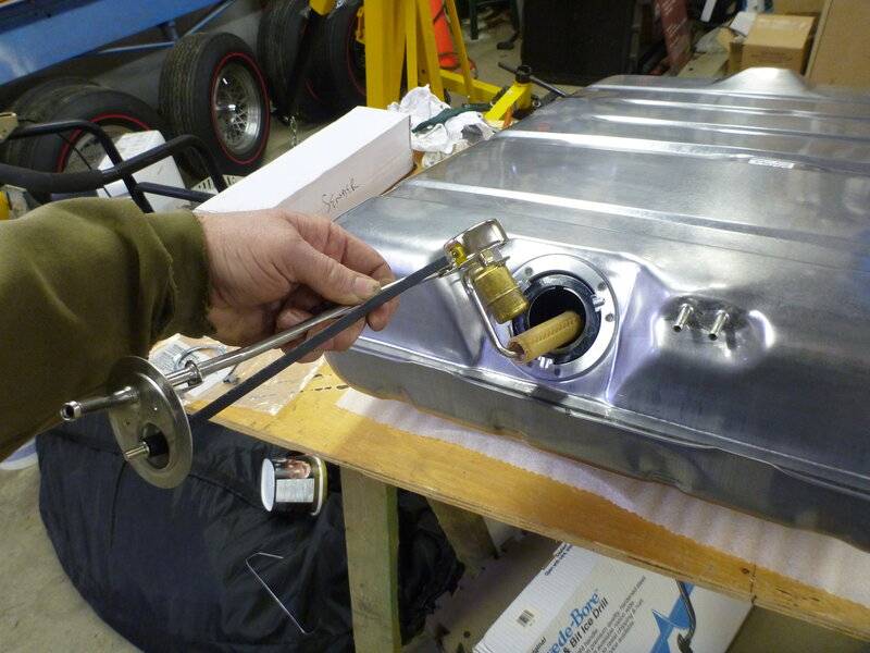

I did both the Bird and the Bee and simply coated the gasket with PST592. Mainly as a lubricant, but it's a thread sealer. Absolutely zero leakage or weepage.

And those aftermarket lock rings are junk. Look for a NOS one.
Ray had some "NOS" for sale and I bought a couple. They were thicker than the cheap repro's but still not as thick as line OE's. The one I show above was the repro supplied with my pickup/sender (or it came with the Spectra tank.. can't remember). Worked just fine.
