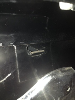

It tends to curve through this slot downward and around the tank and over. Hope this helps.
Thanks. Do you know if the straps look prebent where they meet the tank at the filler end? Mine just bend slightly right at the tabs only and then the strap is straight coming back.
They are definitely pre-bent. Mine are stock from 68.
