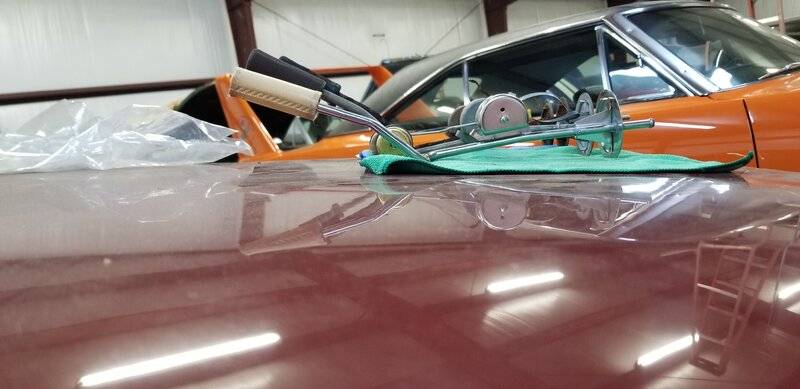

I have been working with a unfixable 66-67 fuel tank and some original sending units along with a reproduction that has the same problem as most. The reproduction sending units are not bent correctly and the float goes to the top of the tank before reaching full. I have cut the tank and playing with this in my spare time. The new lock rings that come with the tanks have been a problem for some time.
I have been working with a unfixable 66-67 fuel tank and some original sending units along with a reproduction that has the same problem as most. The reproduction sending units are not bent correctly and the float goes to the top of the tank before reaching full. I have cut the tank and playing with this in my spare time. The new lock rings that come with the tanks have been a problem for some time. View attachment 1102351
whenever I come across an old tank I cop the steel ring. the originals never wear out, at least in my experience. The 66-67 Belvedere tank is also touchy to Install the filler tube, too many angles!
