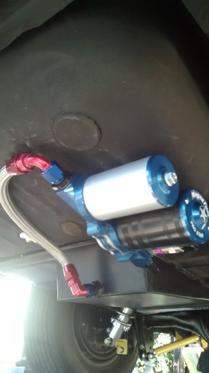

I reused the stock one but I sumped it. I wanted to keep the trunk.
