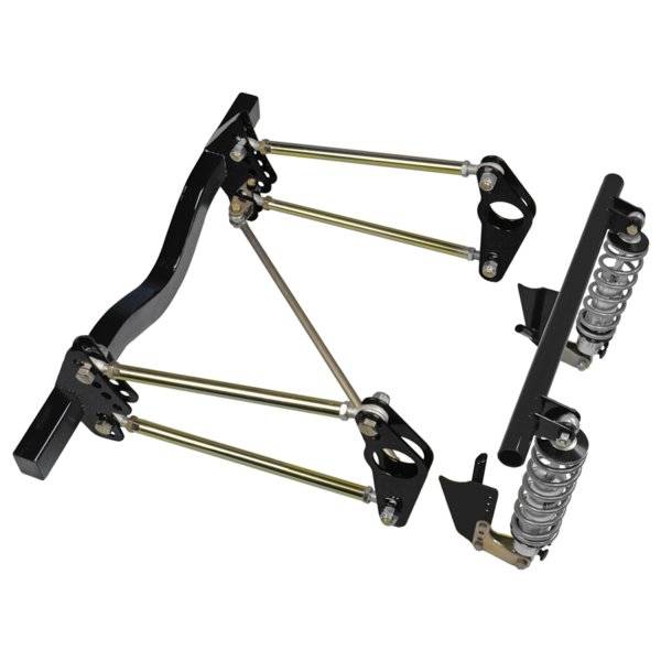

Here's the Chassisworks "Battle Cruiser" setup:
Now that I have bought my 4 wheel Wilwood disc brakes, and I am getting the brakes and QA1 K-member and front suspension system installed, my next suspension move is the rear suspension, so I'm trying to narrow down the choices.
http://cachassisworks.com/p-1550-drag-race-sportsman-4-link-rear-suspension-3x2-crossmember.aspx

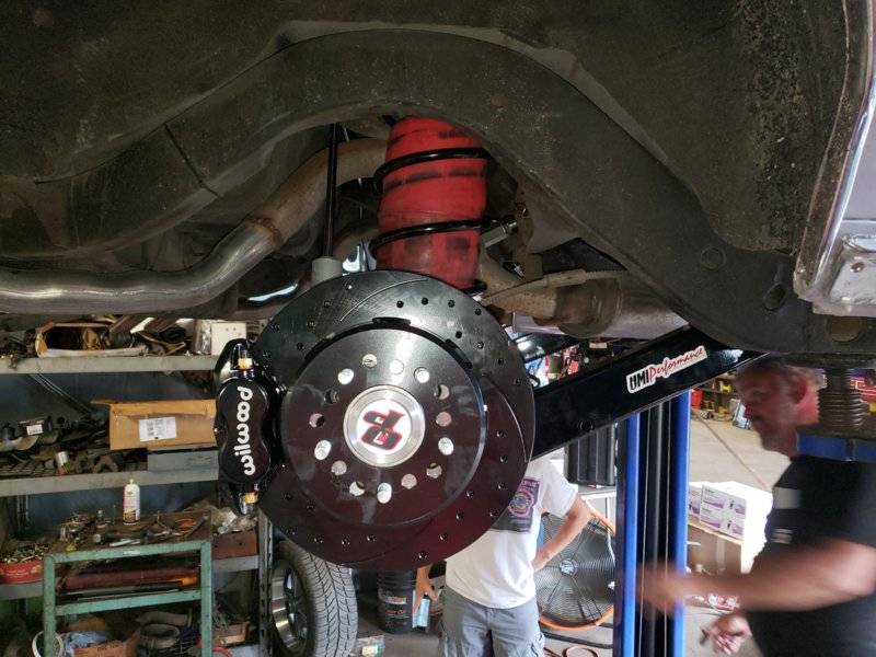

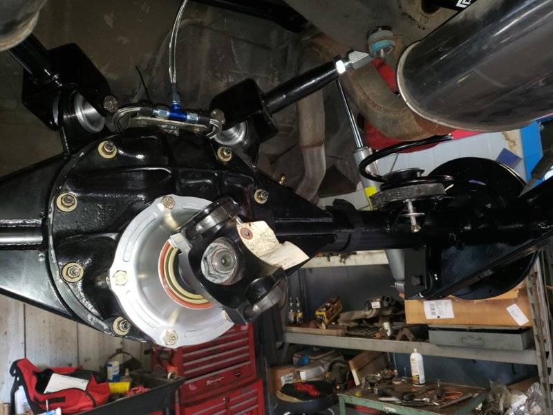

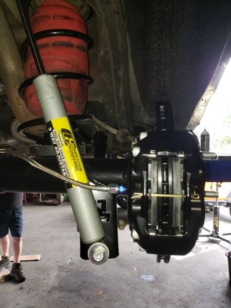

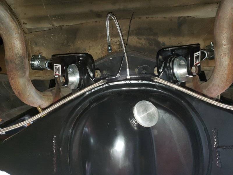

Here's a few pix of the GTO rear suspension and the 4 wheel Wilwood disc brake system I had installed in the GTO a little over a year ago:

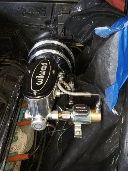

Line lock and new booster on the Wilwood master cylinder. (I have manual brakes on the Roadrunner, and the Wilwood replacement is going to be manual brakes too-I prefer that.)
UMI UCAs w/roto joints:

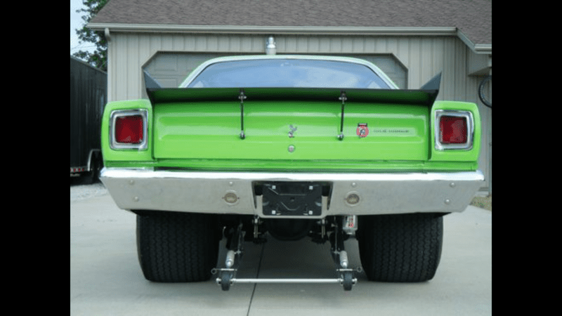

The only way I would consider the suspension pictured in your original post is if the car were a full time drag car. I’m not sure why this would even be a consideration on your car? Converting to an auto would gain far more than this will yield and this will definitely kill the resale value. Just having a 6pt bar in mine turned away 90% of the potential buyers.
You're giving me pause for concern.
Please leave that poor car be.

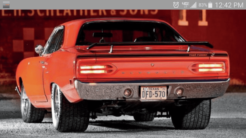

I've seen mini tubbed cars that kept the back seat, and the view in the trunk looks like it could be original.
So please, I appreciate your advice, but I reject the label "poor car" and "folly".
My point was, a lot of people spend money in areas they don't need to instead of refining what is there.
Build your car the way you like. Lots of people have told me I should cut/tub my car over the years and thankfully I resisted because it was not what I wanted.
And I think most classic muscle cars look great with really wide rear tires, but nothing looks as good as a B-Body MOPAR with really wide tires in the back! In my opinion, some B-body MOPARS look WAY better, as in "must have", wider tires in the rear or they look like a fat, WIDE hips woman with skinny legs, tiny ankles and feet!
So needing more grip, and liking the look, and wanting that grip with drag radials means that mini tubs are likely in my Roadrunner. I have 315/35/17s and that or a similar tire will be what I have for a while, but when I address the trunk pan, which needs some work-at least paint if not replacement, that is likely when I'll do the mini tubs.
This is, to me, what looks best on a B-Body and is the look I want for my Roadrunner (but not the spoiler on the Sublime car, although it's not that bad, and I can do without the wheelie bars)

RMS StreetLynx or Gerst triangulated rear suspension system is where I came in to this thread, and that is where I'm at after all of the replies.
Not counting shocks?? it looks like a pair of split mono leafs, shackles, Calvert traction bar assembly, and HD spring pads are around $1,200-$1,400...
The triangulated 4 link is around $1,800 with coilovers.
That is so close in price, price is not the deciding factor.
