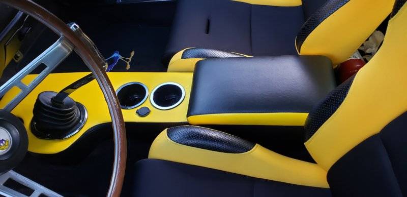

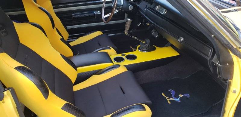

Now what counts as "clowning it up" is where we may depart. You may not like my interior seats and console, but I think it's perfect.
Let me scorch your retinas with a couple of pix...

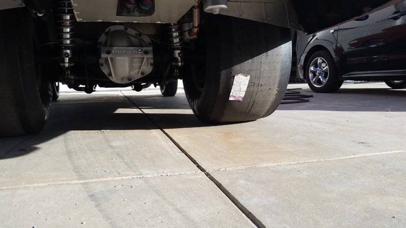

My goals are better handling, better traction, quicker 1320 times, no problem cruising around. The Dakota Digital gauges are going to let me see my dash at night, know how fast I'm going with the 5 speed and 4.10 gears, and a few other things that the factory gauges could never tell me. Looks damn close to the factory gauges though.

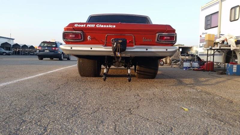

I sincerely would like you and anyone else who feels that way to make the case. I may agree if someone makes a strong argument against mini tubing. I am doing pretty well with what I've manged to squeeze in the stock fenderwells.Mini tubbing that car would be a really bad idea

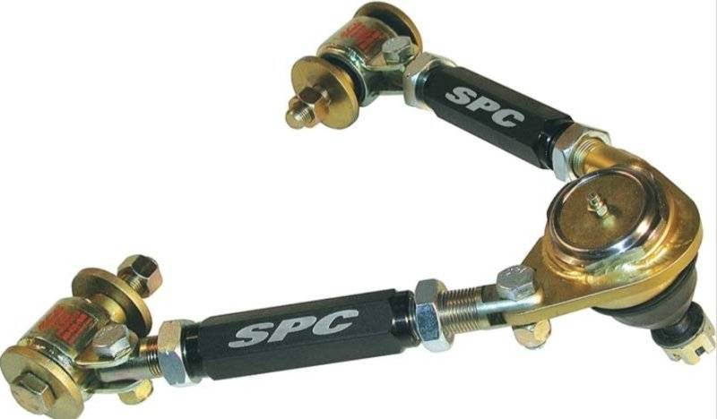

except for the UCAs. I wanted maximum adjustability, so I got these:
