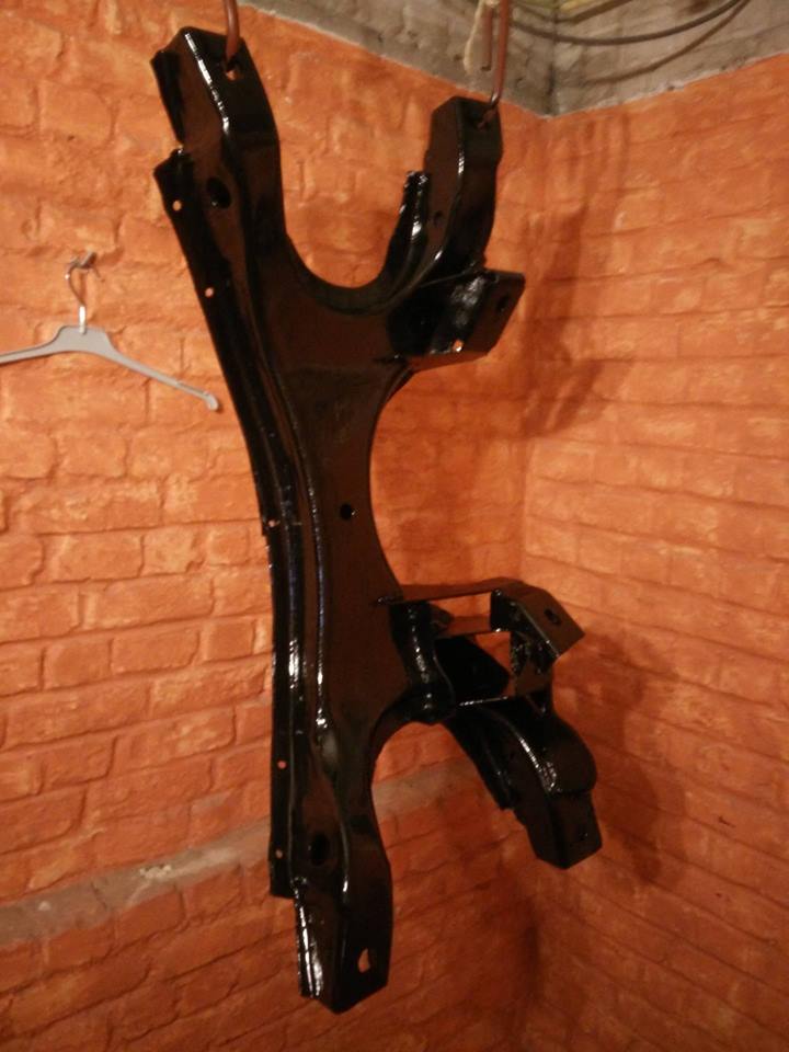

Next for disassembly was the K member and the suspension parts. All went pretty smoothly
Grinder time (5 hours)
And the K member, was finaly clean.

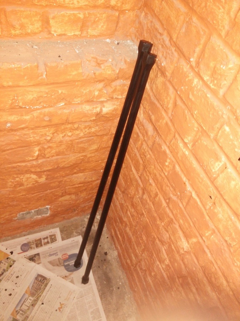

Chapter 4 : Suspension Rebuild / Chassis uppgrade plan
After cleaning up the parts for the suspension, I painted them with black epoxy
The LCA were stiffened up with a boxing plate from Mancini. I still need to change the swaybar mount from a pre 69 style. mine were worn out and a friend sold me those. They are from a 70 Barracuda
I have since decided to build my own K member with rack N pinion and coilover so I will finish to rebuild the old suspension and sell it later.

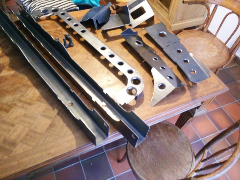

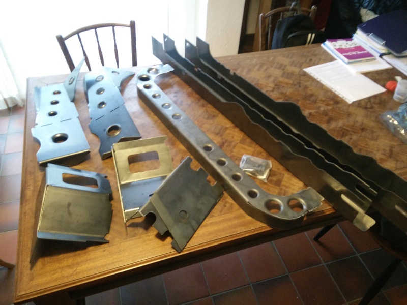

The first part of my new plan was to stiffen up the body. I have seen to many unibody car flex with the torque of the engine. So an order from Us car tool later and
