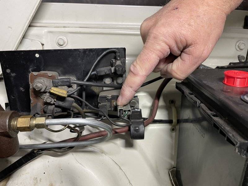

Dodge truck SM. Looked in 66 and 67 SM didn't anything like that, could have missed it.Strange that yellow isnt in that Dodge listing in post 5 but considering the two low milage cars here, that appears to be what was originally installed. Wonder what gage wire link they used?
$48 for postage?Googling fuseable links. Yellow appears to have been used on early 66's and 65 back. Here's a "mid 60's" listed on ebag. Has the part number stenciled on the wire vs a tag like '66 had with mine having just enough remaining to read the 277 and I can see trace evidence of a label in RC's pictures.

FSM shows H1 = 20 Guage and Black and A1B = 16 Guage and Dark Blue. There is no reference to a "hemi" specific link which we've already determined is both Black wires. The standard part would have a female spade on the H1 and the A1B would have a male lock in spade for the bulkhead conector vs a ring terminal for the hemi specific link. I see no reason why the hemi would require more amperage to the car than any other engine so suspect it would still be 16 gauge.But what is the correct wire size??
