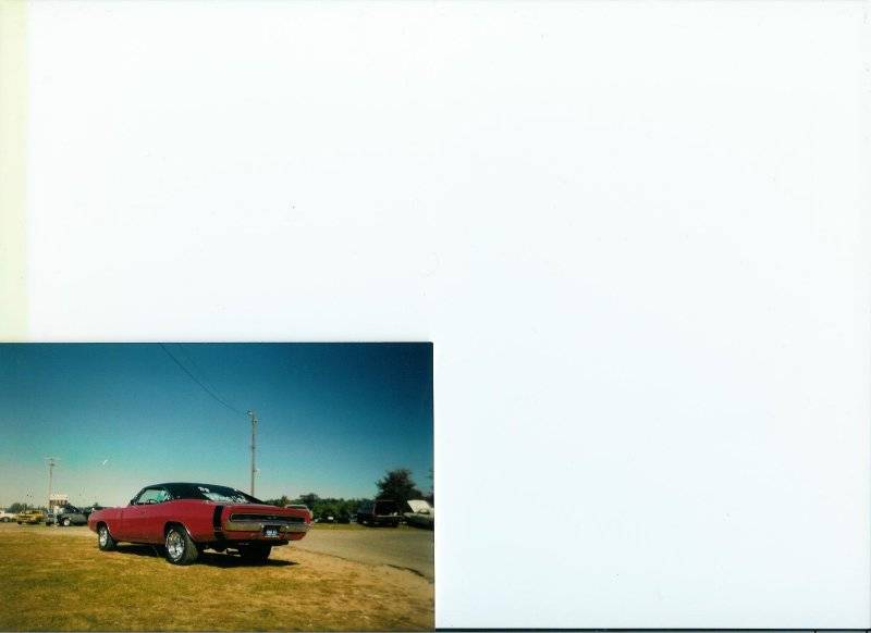

Been there, done that. My Charger had them on it in the 80's. Brought it back down to normal ride height in the 90's. Even more of a stock look today.
