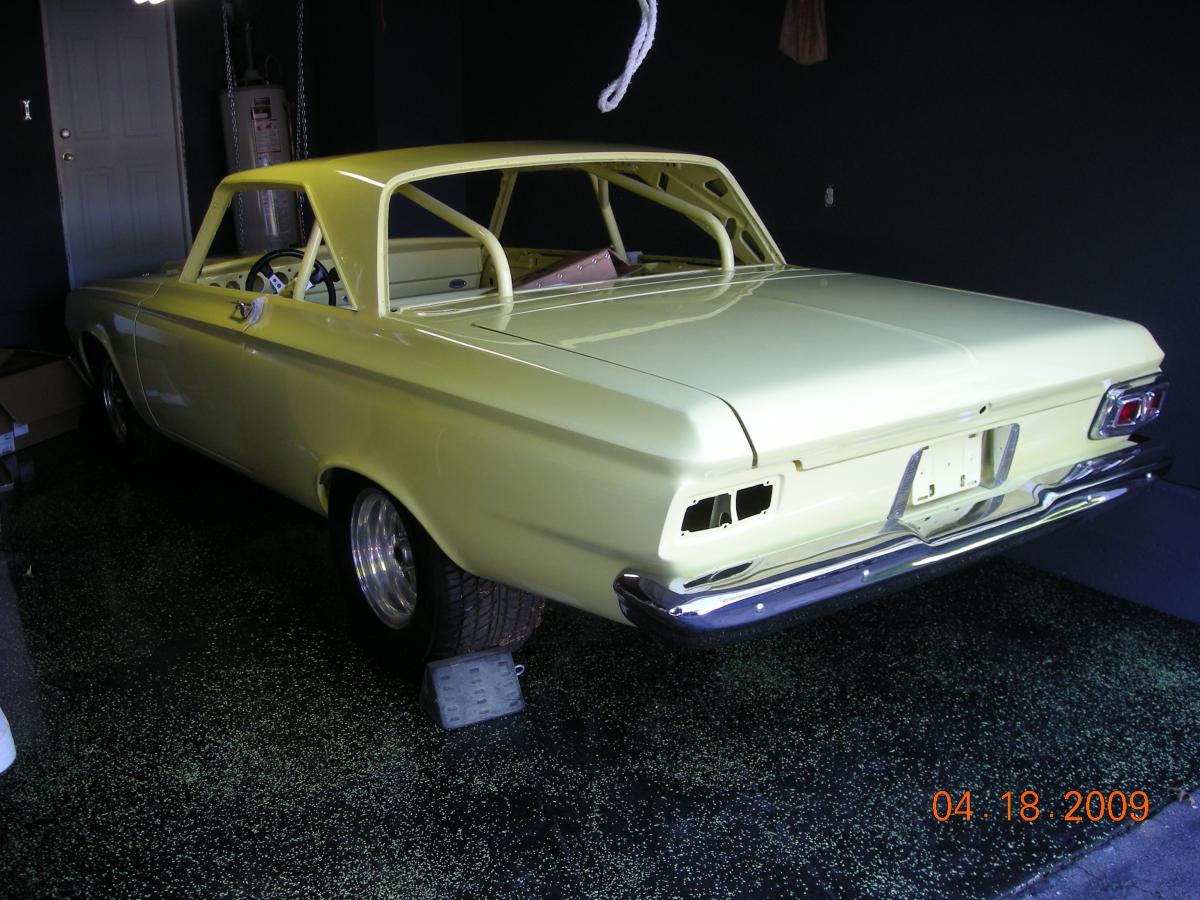

Got my stuff out of a place in Colorado.. No problems so far after a year and a half...

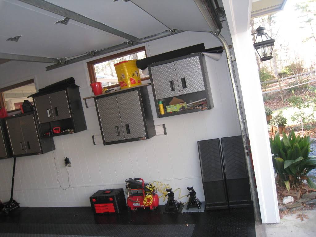

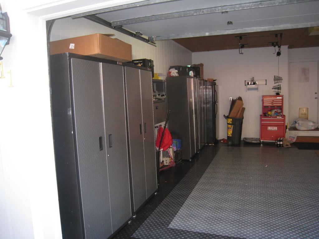

ended up doing this...
was able to get US made tiles for only thirty cents more each than the cheapest (china) ones
Well......since the wife wants new carpet [for a house that Bank of America might own soon] I cant justify anything!
they are made by snap lok.
it is the garagetrack version.
less expensive as their racedeck version.
That Snap Lok looks good and a quick install too. I used the paint kit from Lowes and it held up very well for the 8 years I owned my last house. Prep is very important but I also started with a very clean floor and an empty garage. Think it says wait 3 days to drive on it.

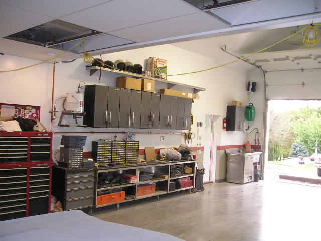

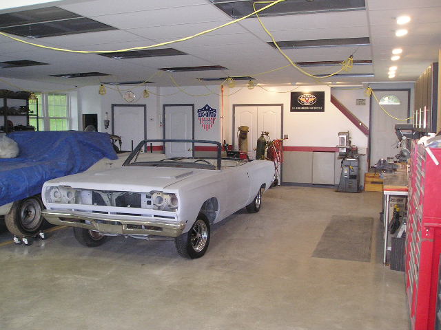

I agonized over what to do with the floor in my shop after it was poured. Bare concrete sucks up oil like a sponge and I do too much fab work to spend the time and money on epoxy only to trash it. In the end I opted for Sherwin-Williams' ArmorSeal 1K. It's a fairly inexpensive urethane. Not a very high solids content, but it does the trick. The floor is washable, doesn't soak up oil and since I added fiber to the 'crete, the urethane made the fibers lay down and gave it a non-slip property.
Couple of observations I made in my research:
RaceDeck and the like will trap moisture under them and they tend to "click" unless you have a perfectly flat floor, which no one does.
Epoxy is time consuming, expensive and may produce hot tire lift. Prep is laborous.
Vinyl tile will discolor and unless it's climate controlled, will most likely peel up eventually.
YMMV
